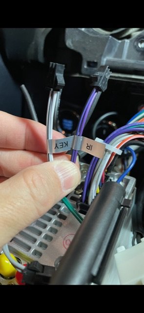

    So HU came today. Like everybody, was unable to get OEM nav to physically connect. It’s SMB-ish but not quite. Ok, moving on, I have two USBs on back panel plus one pigtail at the same point the SIM pigtail pops from. Top one on back panel labeled OTG. Are these universal doesn’t matter what goes where?
    then there are two JST looking plugs - Key and IR. No remote so prob can ignore IR but KEY? Is that used?

    My Key/Ir plugs were left alone. I plugged the OEM USB plug adapter into to OTG for no reason, but it works. I used the two supplied USB extensions (one into the other) to run to the bottom of the center console so that I can easily plug in at any time and it be tucked away.
