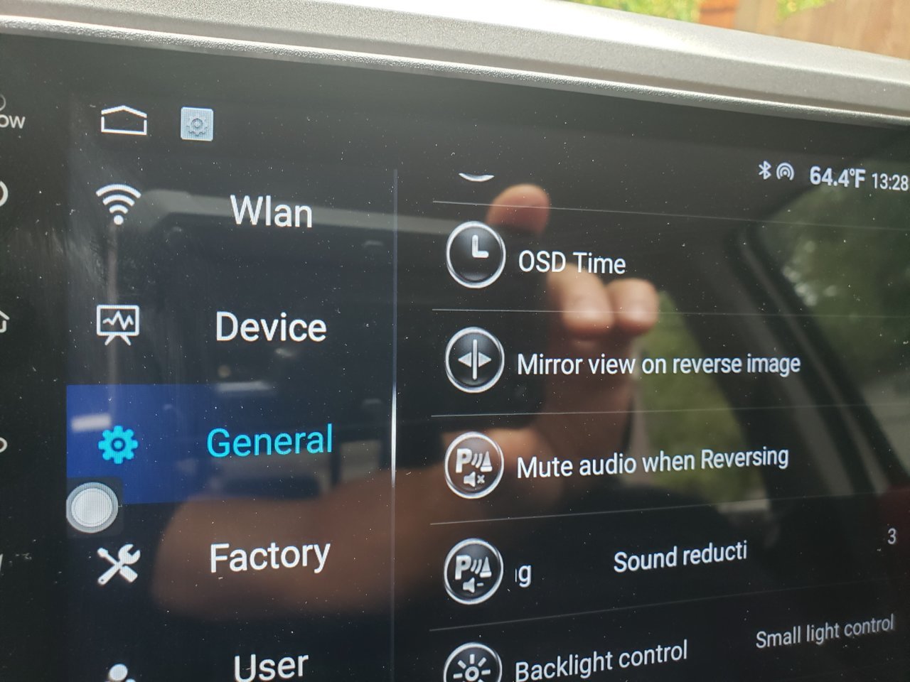

    Hey y’all! Just installed my Joying HU.
    Everytime I go on reverse, the audio completely stops- then after I shift back to drive, the audio continues. Is this normal? If not, how do I fix it?
    Thanks in advance!
  11. Sep 23, 2023 at 8:15 PM
    #1631
    5nahalf
    5nahalf [OP] I build dumb things
    Sep 22, 2018
    #267058
    10,934
    Erik
    Minnesota
    2018 Inferno Longbed
    Yes its normal, and its my favorite feature. I believe you can change it in the settings, but I have never had the need to.
    djayflor[QUOTED] likes this.

    Do you know where in Settings?

    Where in settings can I turn off the grid lines for the backup camera?

  16. Sep 24, 2023 at 1:33 PM
    #1636
    Vlady
    Vlady Well-Known Member
    Dec 20, 2017
    #238986
    4,477
    Issy, WA
    2017 White SR5 DCSB V6 4x4
    Under General settings
  17. Sep 24, 2023 at 1:33 PM
    #1637
    Vlady
    Dec 20, 2017
    #238986
    4,477
    Issy, WA
    Factory (3368), Original Car Agreement
