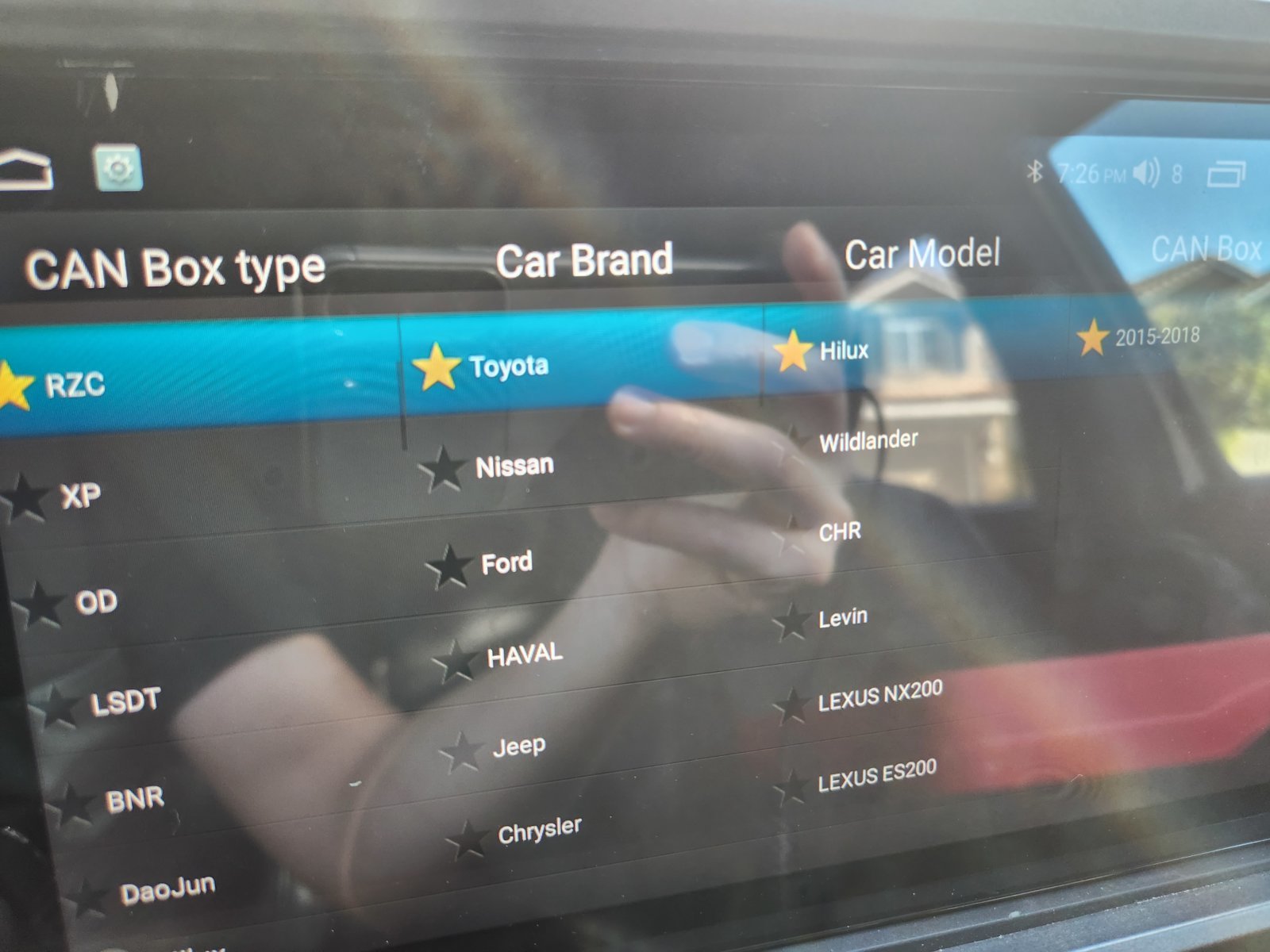

    I got the one off Amazon which is the android 10 version. Ive tried setting it as a hilux and the camry. Ill take a pic later today. Verified my can bus cables were connected.

    Yah that is where i am trying to change the settings and the check marks wont turn green to change the setting. Clicking on it does nothing

    Let me take a look at mine. I saw a few green check marks at one point. Try a different toyota model

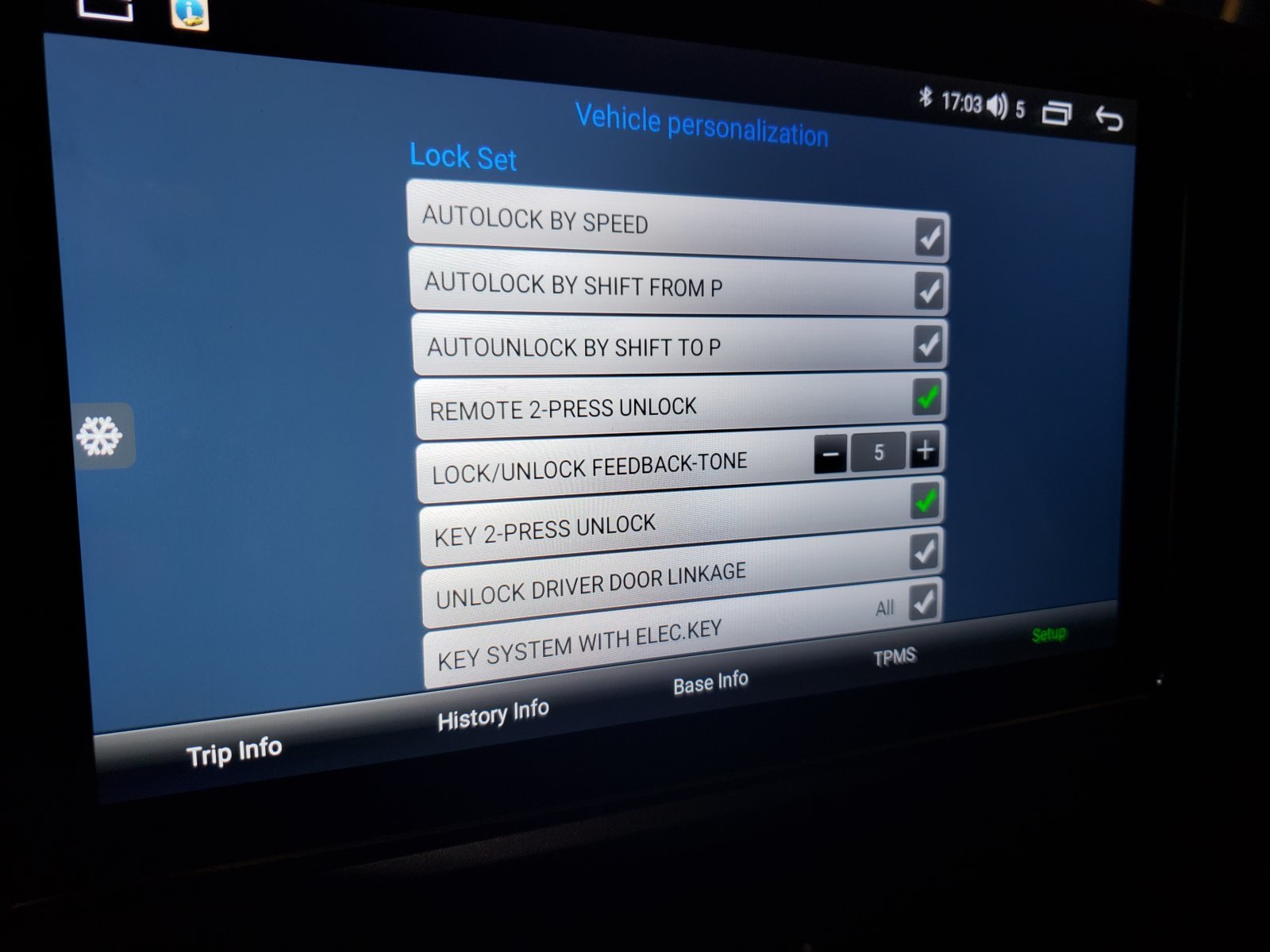

    I have XP selected and Rav4.
    However, these 2 only can be selected/deselected.
    I tried different CANS and see no changes.
    92se-r[QUOTED] likes this.

    Thats the same issue I have, it no longer autolocks or auto unlocks and i cant change the setting

    I was playing with different CANs and messed my settings. I had lock doors by shifting to D, now doors lock by speed.
    I thing we need to find a CAN from the list that works with tacoma body module.

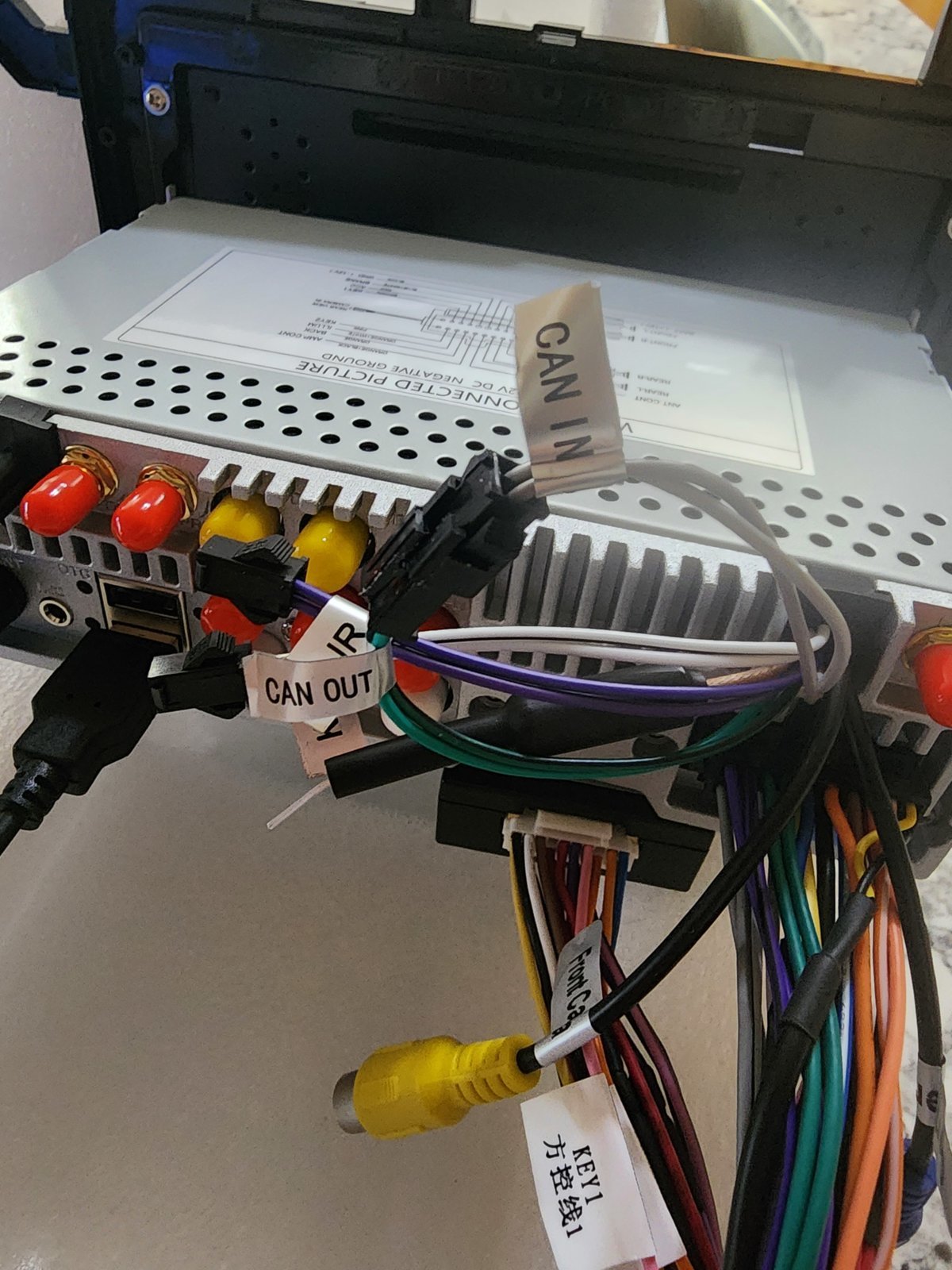

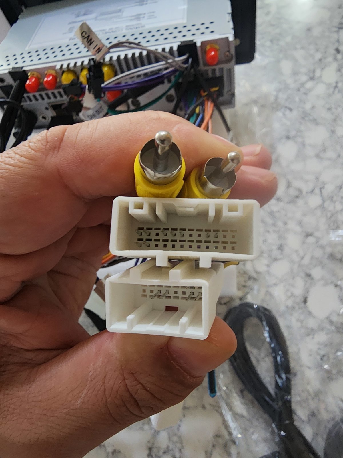

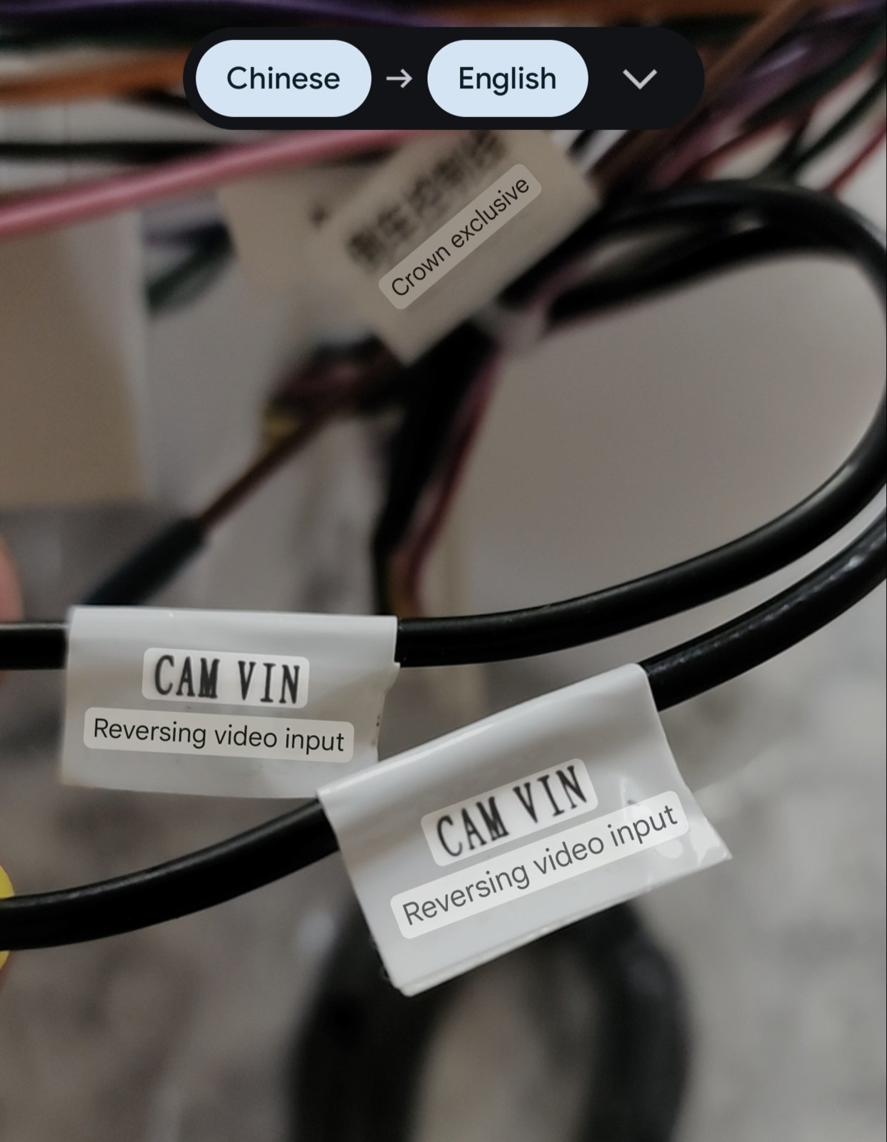

    New Joying Android 12 arrived yesterday. I'm sure I can figure out which one to use but I find it odd that there are 2 camera input feeds on the conversion harness supplied from Joying.
    And is this correct? It came with can in/out already connected.
