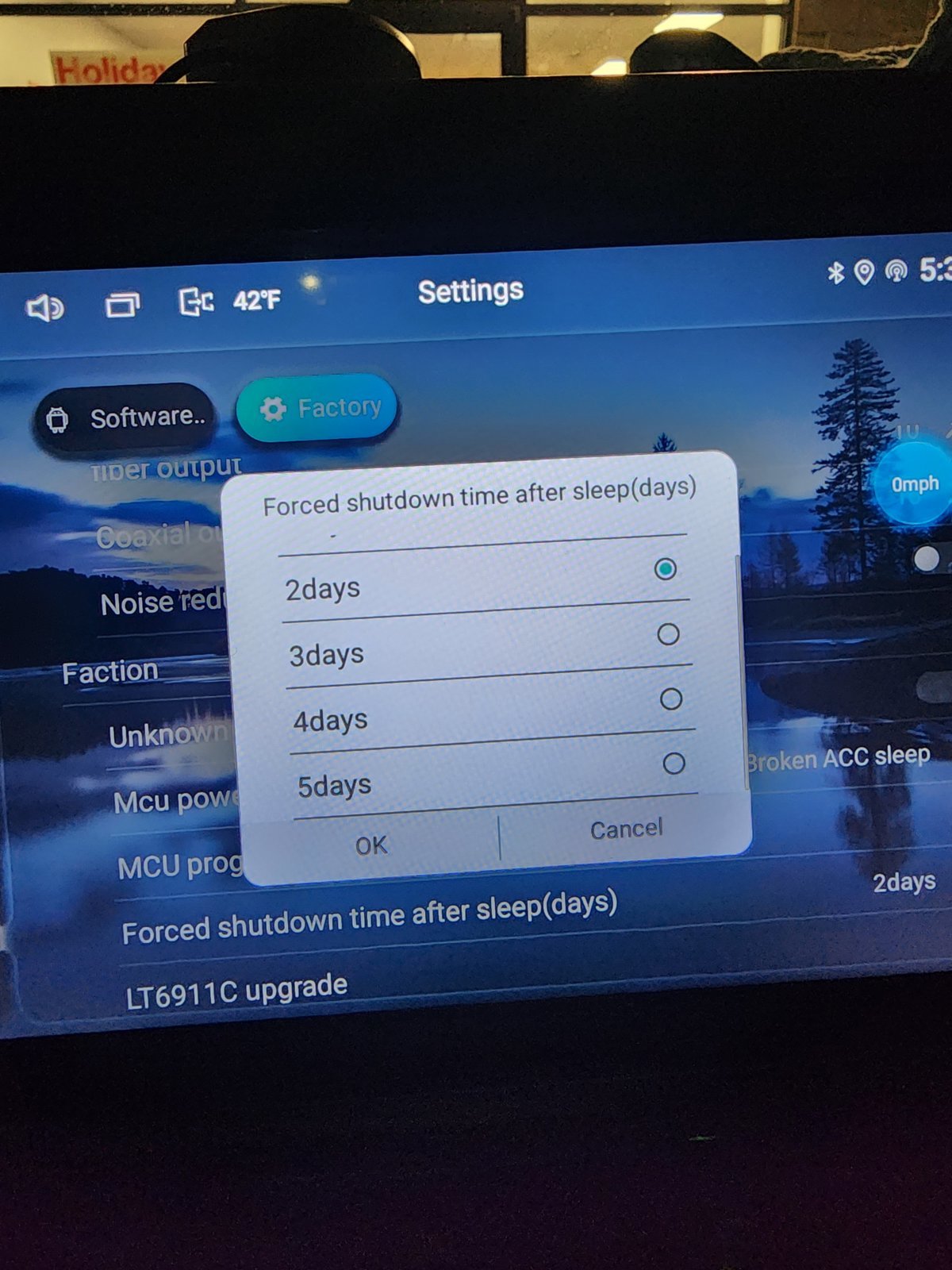

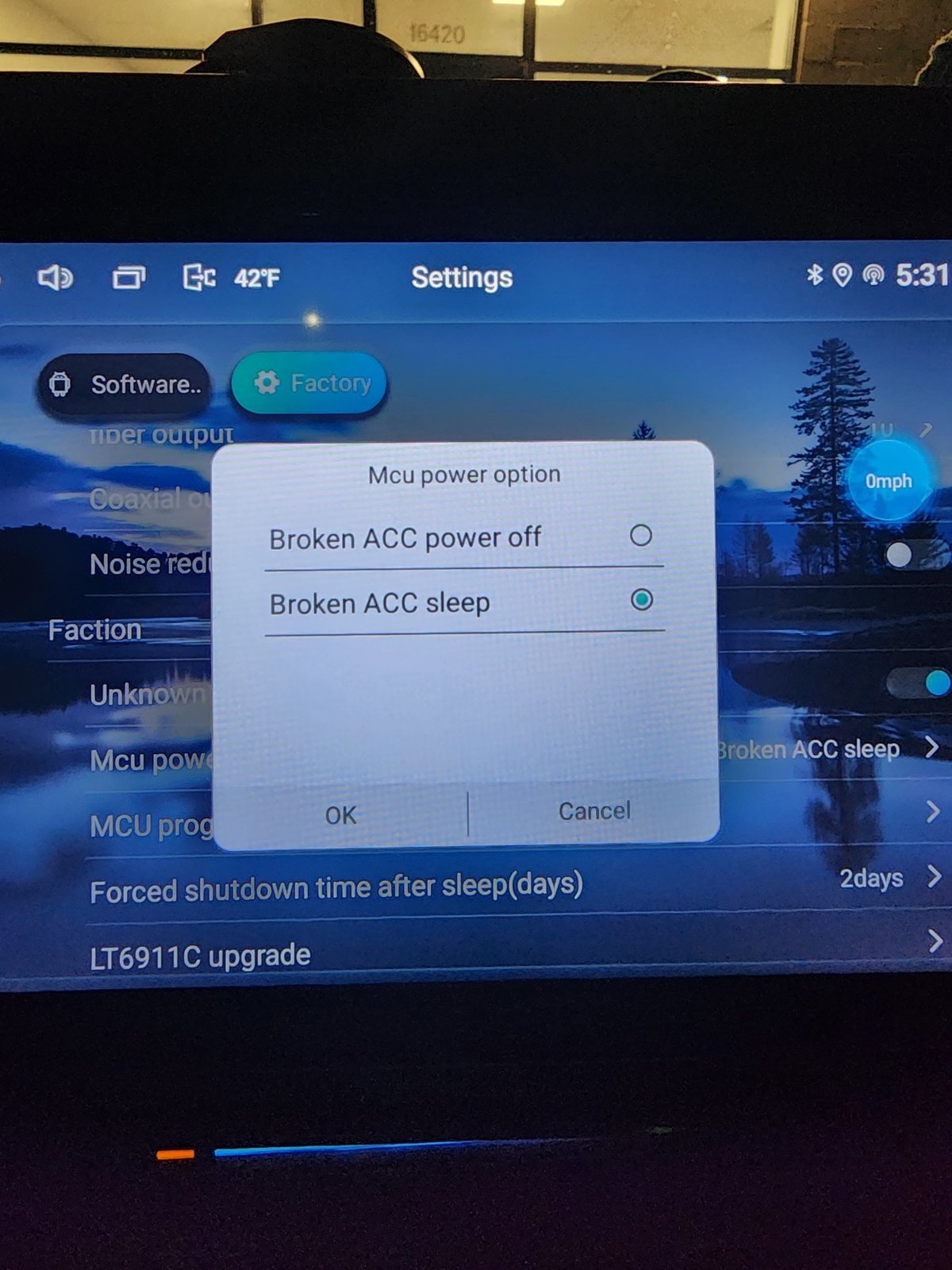

    Here's the option that's buried in the menu system. It's located in password protected factory settings under MCU power option.
    With "Broken ACC power off" it will shut down the entire unit after a few seconds when the ignition is off. "Broken ACC sleep" as the name explains, it'll go to sleep after the ignition is turned off.
    For power savings, you can set the amount of days the HU will force shut down after long periods of non use.

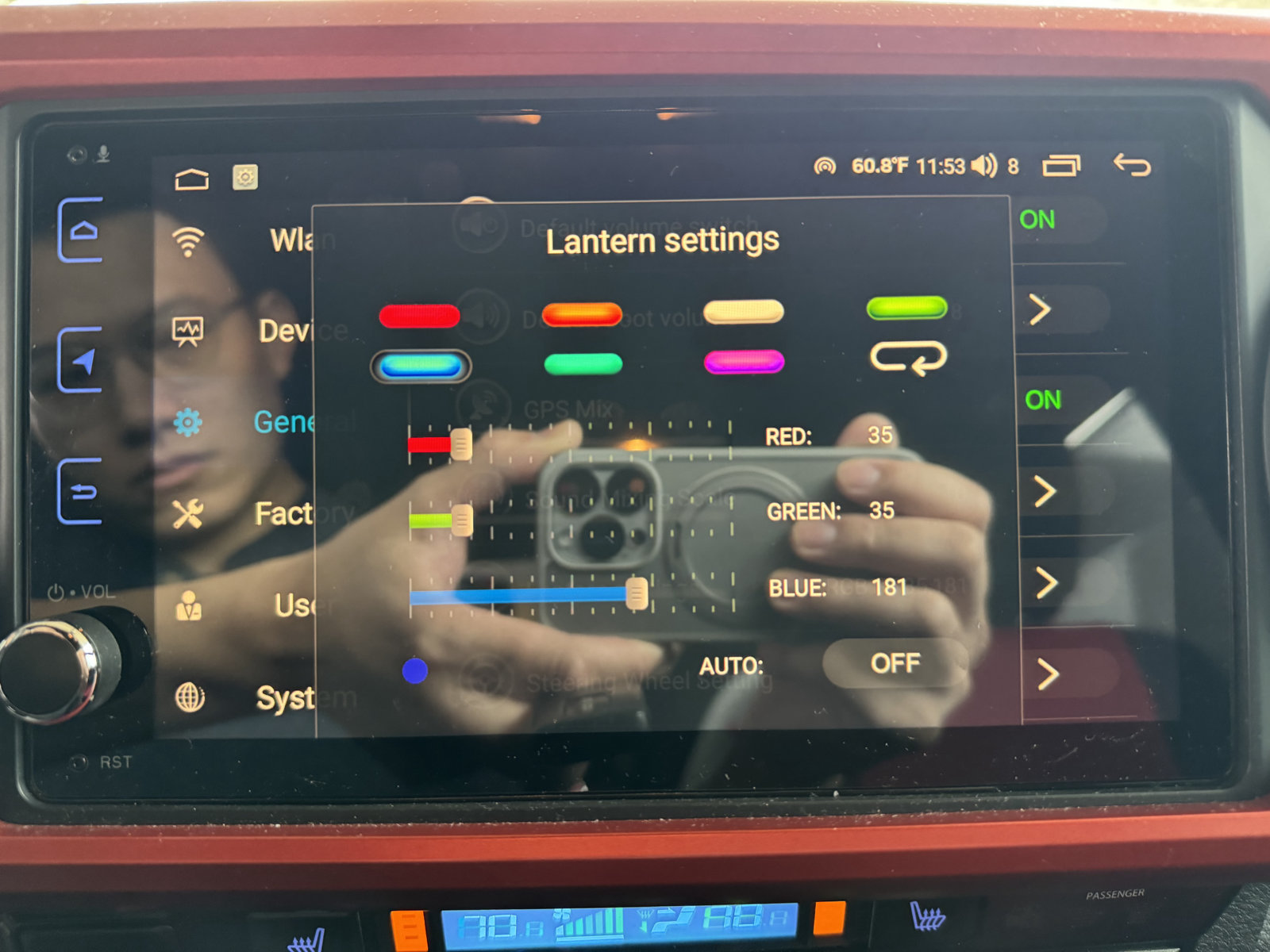

    Some notes here:
    1. The "lantern setting" is for the buttons light color, I set it really close to the OEM blue. Let me know if you want the RGB number.
    2. The cambus setting from Joying is using camry.

    Awesome man! Couple questions.
    1. Can you post the RGB number you mentioned for the buttons light color? Mine came factory set to slowly cycle through all the light colors it can display and I think it looks tacky.

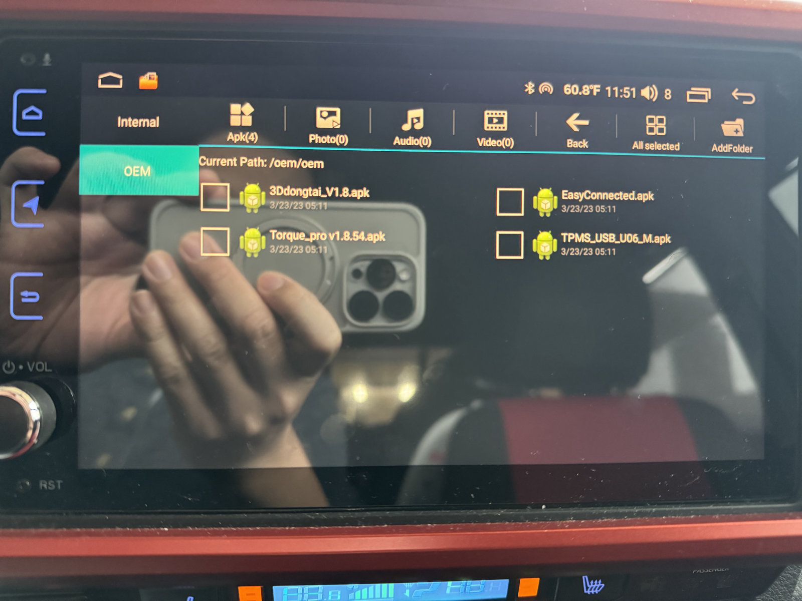

    2. What does the Torque app package do? I didn't see that as an option on mine.
    R 35 G 35 B 180 is the RGB I set for. And you can turn the auto off so it doesn't change color on it's own.
    There are 2 "setting apps" The "Vehicle setting" is for tpms, locks, fuel economy.
    "setting" is for things regarding the head units.
    Lantern settings is under here.
    Torque app is for people who use the ELM 327 OBD for monitoring the car. Mine came with it under "file manager -> OEM" there are four app apk in there. 3Ddontai_v1.8 (based on the mandarin pingyin, it's probably for animated wallpaper or some sort.) The other 3 are self explanatory. But I do not use any of them.
    Torque is popular for people who mod their car heavily and require all time monitoring.

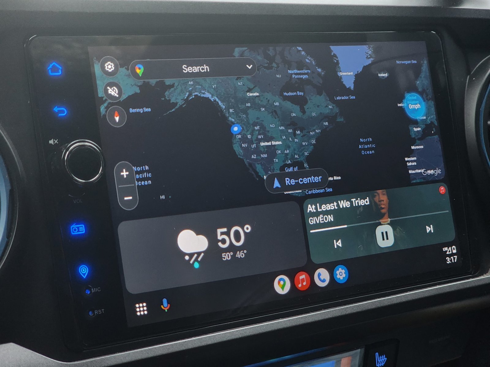

    Using AA with Zlink and I can't figure out how to change the layout. It seems I'm stuck with map up top, weather bottom left, and music bottom right.
    I have a Kenwood 958Xr in my other car and it allows me to change it quite easily. It's not a deal breaker but I'd like to swap sides with music/weather or go split between music and maps.
