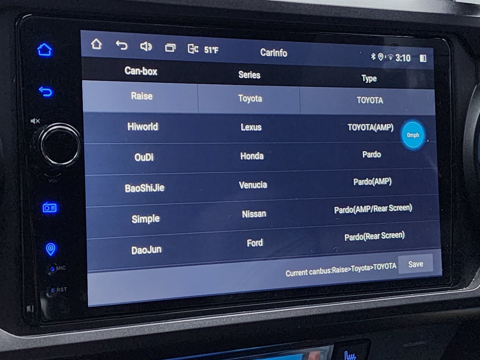

    I was able to fix it super easily. I consulted my trusty instruction manual that came with my HU and my code is 8888 (Android 12 version). I changed the Canbus setting from Raise>Toyota>TOYOTA to Raise>Toyota>TOYOTA (AMP). Pretty obvious to do since I have the stock JBL Premium soundsystem that comes with the amp. Fixed my volume issue right away. I also was able to turn down the default Radio sound from 10 to 1 and it made it sound wayyyy more clear instead of grainy like it was.

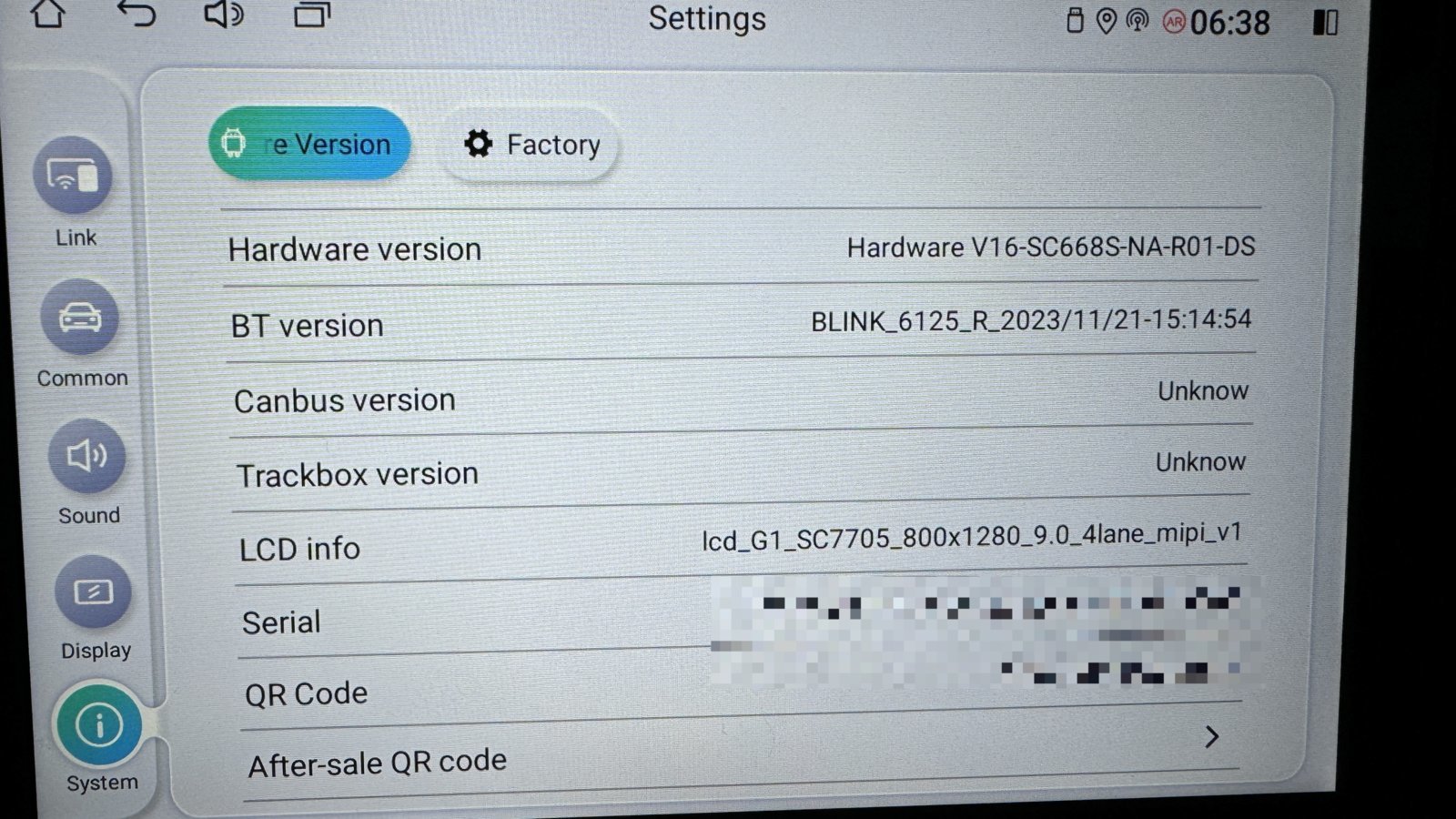

    #1736
    comatose1978
    comatose1978 Member
    Mar 2, 2024
    #445063
    6
    2017 Tacoma Sport
    2017 Tacoma, non JBL.
    Is my canbus faulty? - Notice it’s says unknown.
    I have canbus in connected to canbus out.
    i ask because I do not have steering wheel control, or backup camera.
    Canbus is set to: Raise/Toyota/Toyota.
    I’ve also tried several different vehicle choices as well.
    Backup camera is connected to the 24 pin and the backup camera rca.
    connected:
    not connected.

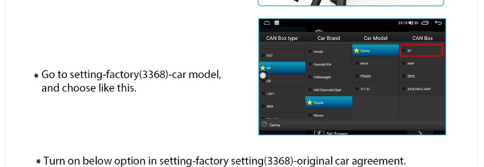

  17. Mar 4, 2024 at 6:30 AM
    #1737
    Towns81
    Towns81 Well-Known Member
    Mar 9, 2020
    #321708
    58
    Central Illinois
    2017 MGM Tacoma Limited
    I have a 2017 Limited, so it had the JBL system. I purchased the previous version. Had trouble using the setting I had and Joying got back to me the next day. They told me to use the setting in the image below. I know mine is a different version of Android, but I really would assume it would be he same canbus settings for you as it is for me with a 2017.

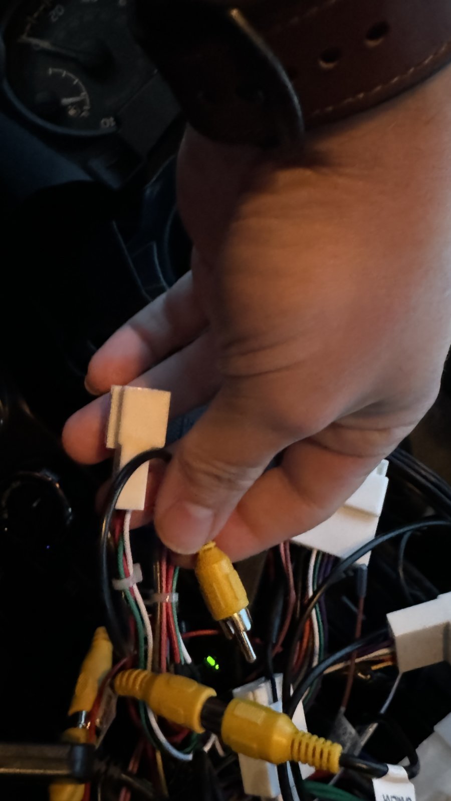

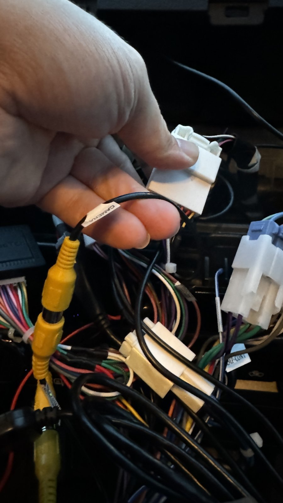

  20. Mar 5, 2024 at 8:46 PM
    #1740
    Vlady
    Vlady Well-Known Member
    Dec 20, 2017
    #238986
    4,561
    Issy, WA
    2017 White SR5 DCSB V6 4x4
    Have you tried both yellow connectors? I recall I tried both to get it working
    Towns81 likes this.
