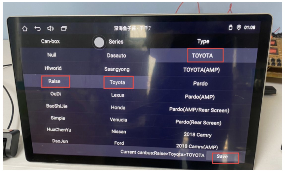

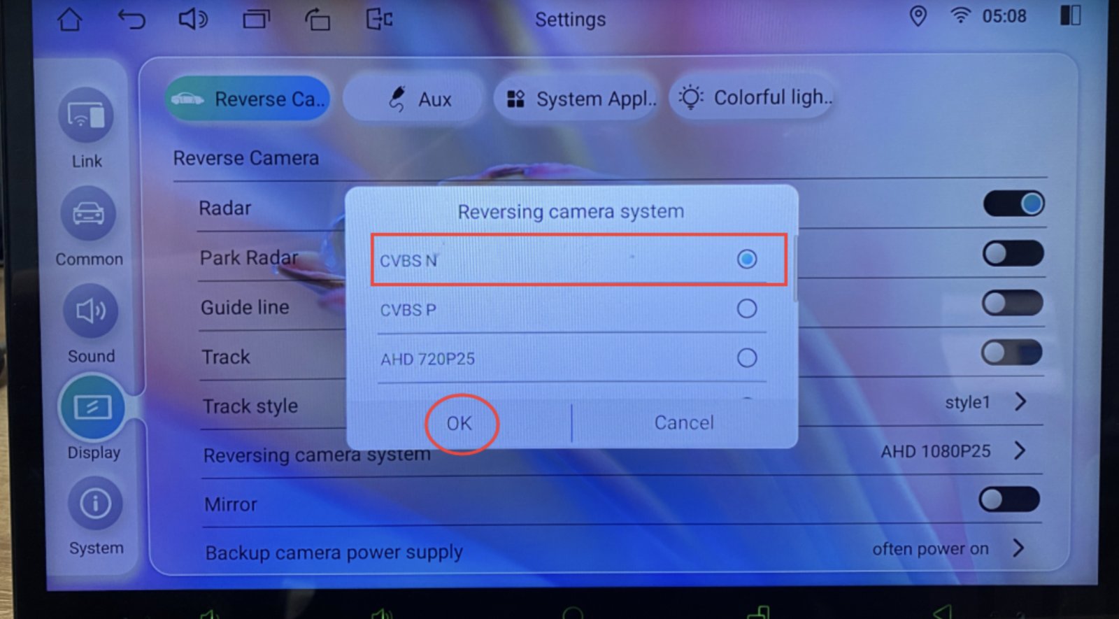

    Got the reverse camera working. Thanks to Afallon for the last part I've not seen posted in this thread. Also thanks to everyone who pitched in with ideas.
    Canbus settings Raise/Toyota/TOYOTA
    The missing piece for me was the reverse camera setting to CVBS N
    Screenshot 2024-03-06 at 6.35.35 AM.pngScreenshot 2024-03-06 at 6.32.39 AM.png

    The only thing I see is after selecting rise toyota and TOYOTA I rebooted it for that setting to stick/go into effect. Reboot by swiping down and select that option.

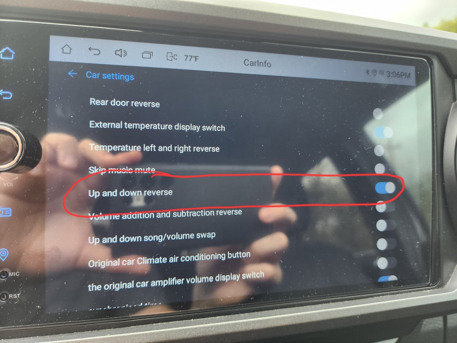

    Also my skip track was backwards at first. The setting to change that is here:
    Rellims and Vlady like this.
