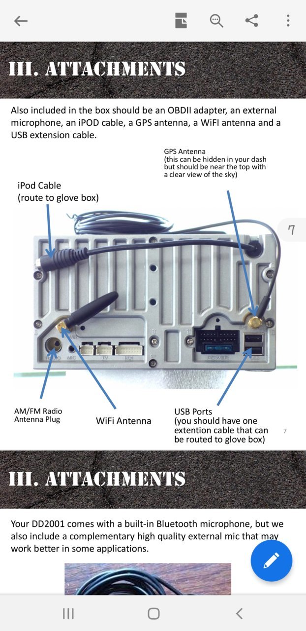

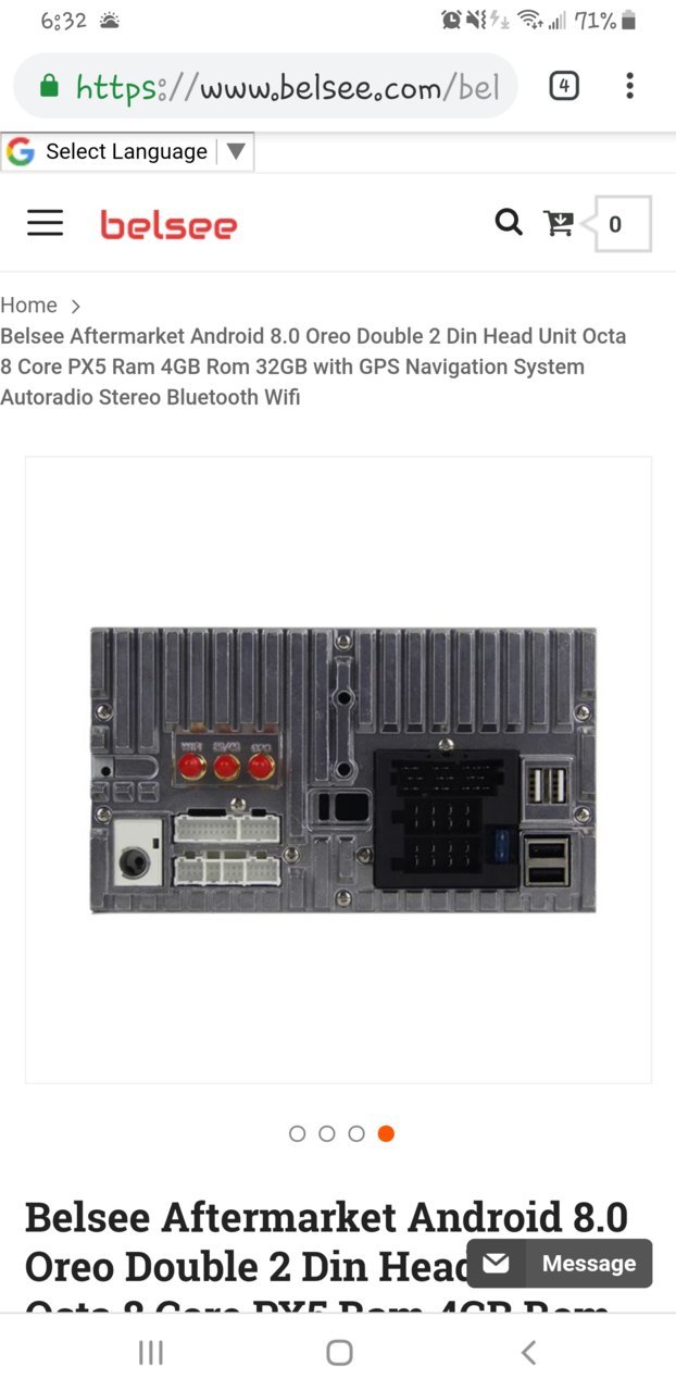

    Chances are that there is a single company that makes these unit, then sells them off to retailers to put their own software and mods to them. Im guessing that there is some slight variations in the units, but not enough to justify paying 4 times more for the what is the same thing. It could also be updated versions, one company is using the older, the other is using the newer.
    But, it looks like belsee comes out on top with all those usb ports
    EDIT (I like edits!) the PX5 cpu that comes in both the belsee and the insane audio one is worse than the intel 8953 that comes in the joying unit. SO, given the choice I would go with the intel joying over the belsee px5... though I may order one to test.

    Just took my headunit out to replace my cheap rca cables going to my dsp and I noticed something... I have a extra green rca plug thats not being used.... it says v-out... I think this thing has video output! I dont have anything that can take rca video input, but im going to find something and give it a try!
    In the pictures on joyings site, the green rca I have is missing from there picture, its just a empty spot.

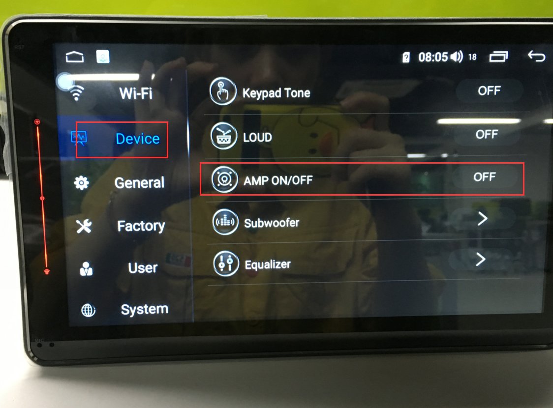

    I wanted to circle back and let everyone who may have JBL know that I was able to get this headunit working with my stock amp/speaker setup. It took a week of back-and-forth emails with Joying Support, but they finally suggested I try the simplest solution of all - turning the "Amp" selector to "On". I feel like a bit of a dunce, but hey it worked. I don't have control over the fade selection but all speakers and sub work. This will get me by until the day comes where I pull the trigger on a new speaker setup.

    I always wondered what that option was for!
