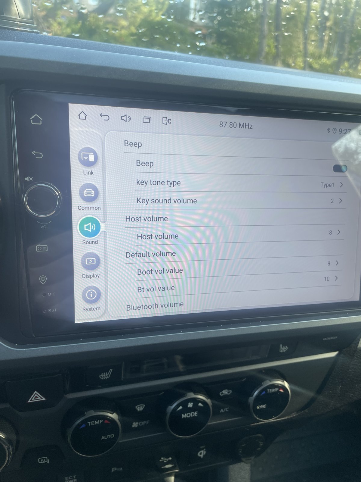

    If you go to your settings it should look like the previous attached photo.

    I should have clarified that I don't have that I don't seem to have that option in my settings. See attached. I don't see a "device" section in the settings.

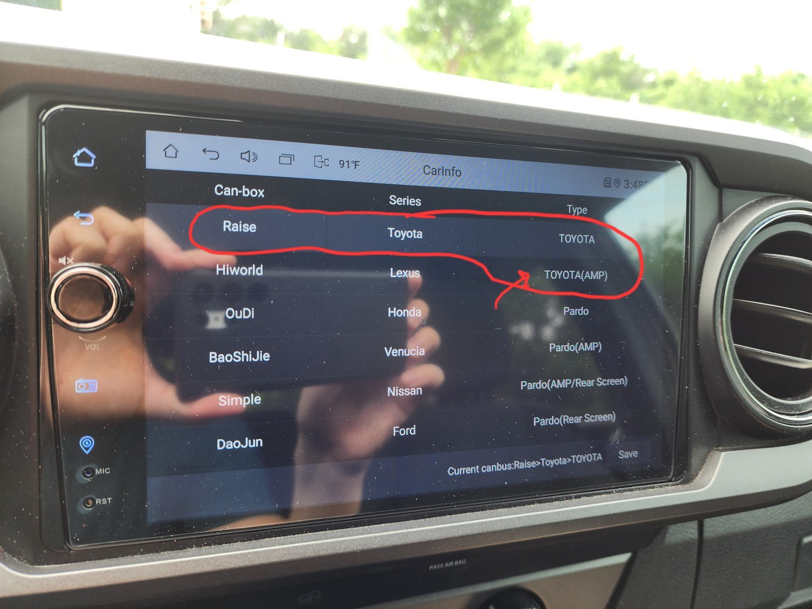

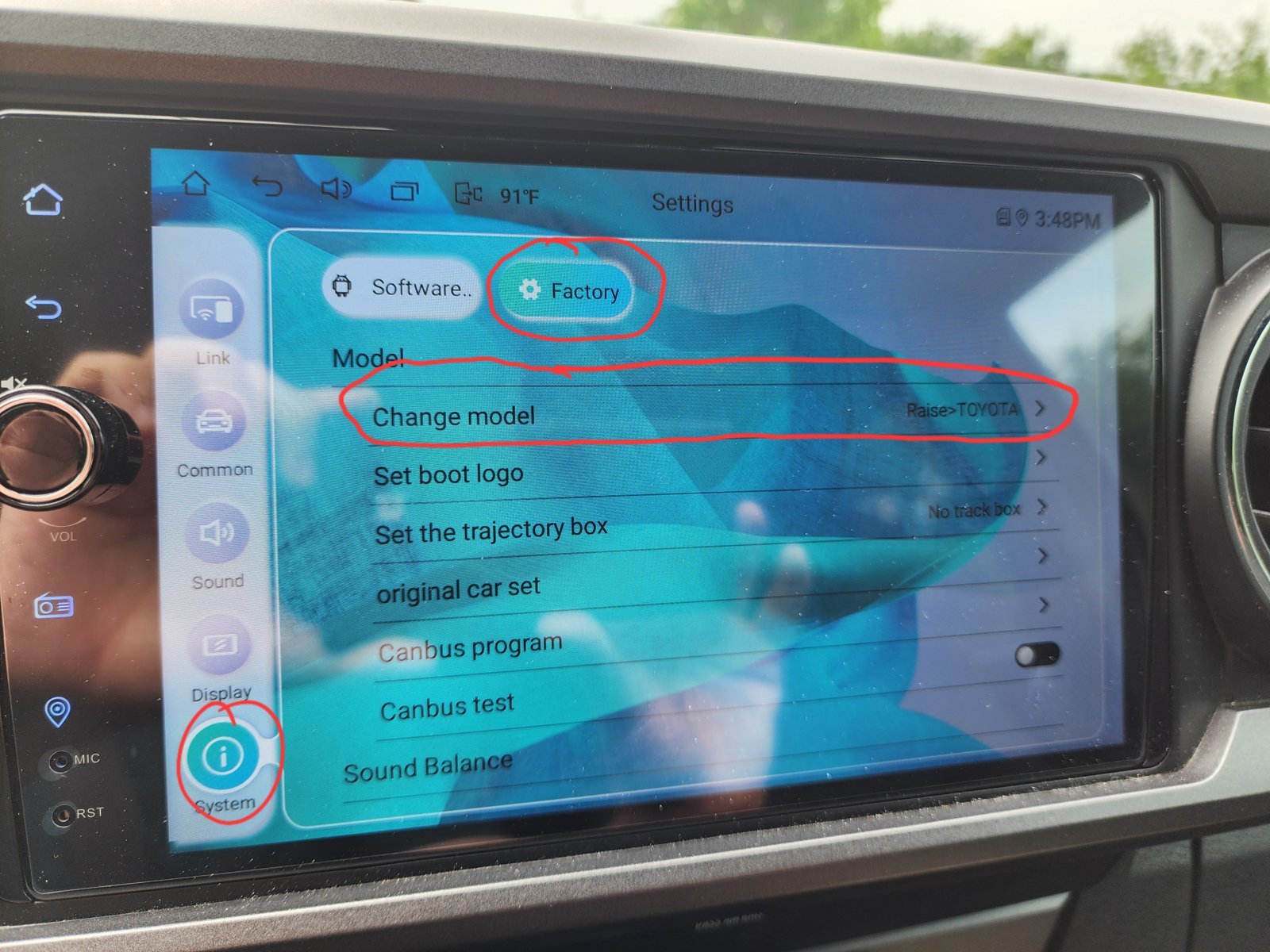

    Here's where you would find the AMP section on the newest units.
    System > factory (8888) > change model to Toyota (AMP)
    I myself don't have the JBL system, but I believe this is the fix for it.

    A quick update on this for any interested...
    Joying sent me a new canbus harness, which solved my lack of sound problems. I did also have to select the Toyota (amp) in the settings as well.
