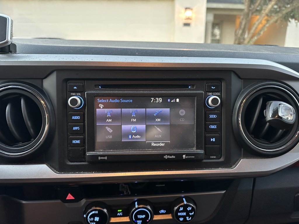

    I have read a lot of this thread and used the search, but can’t seem to see if anyone has confirmed that the Joying unit will work in a 3rd gen truck that has the base radio. I know I would need the larger bezel, but do all the connectors work or do I need to get adapters. Joying Customer Service is just telling me it won’t fit, and that I need the universal head unit and an adapter harness. They don’t seem to understand the concept of getting a bezel that will fit. My base radio is terrible, I have to reboot it every time I want to connect my phone to the truck and the touchscreen barely works.

    Which head unit are you trying to buy?

    It seems they provide the harness with HU. Should be plug&play
    Also, looks like they figured usb adapter to interface with factory usb port..
    You may need an adapter to hook GPS factory antenna to HU if dont like a supplied antenna.
    Other than the bezel, you should be good to go.

    Thank you both, this is the answer I was hoping for.

    Crusty Barnacle, did you ever purchase the Joying head unit for your Tacoma? My son is 15 and recently purchased a 2016 Tacoma with the same head unit as you have. Trying to see what is needed to make this work? I read to pg 12 and my eyes were going blurry, so i skipped to the last page hoping for more info. He has an Iphone and i want him to have maps the pull up on his stereo vs his phone. We live in Orlando and traffic is terrible and dont need him looking at his phone while driving.
    5nahalf, i saw that you mentioned crusty needed unit A from Joying but im not sure what bezel to get. The HU opening is 8 1/2" x 4 1/2" in his Tacoma, but the Joying unit is 9". Will i still have a flush head unit after all said and done?
