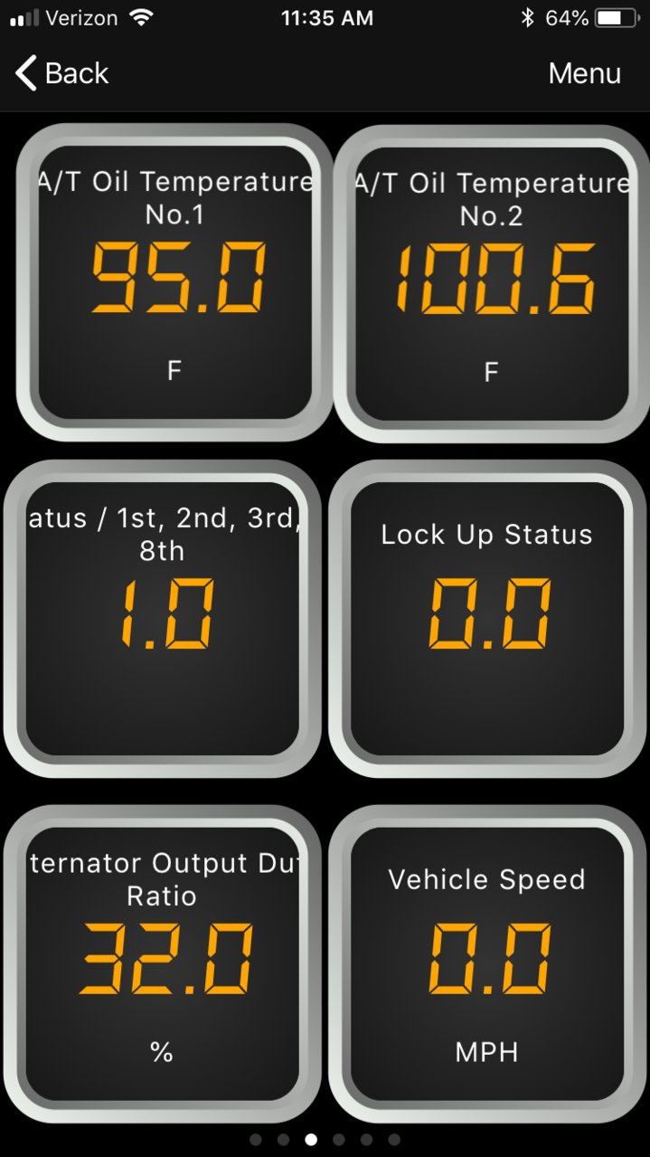

    4- Using the torque app I warmed truck up until trans was at 95 degrees then went under truck while it was still running and used a 5 mm Allen socket to pull the check plug out of pan.

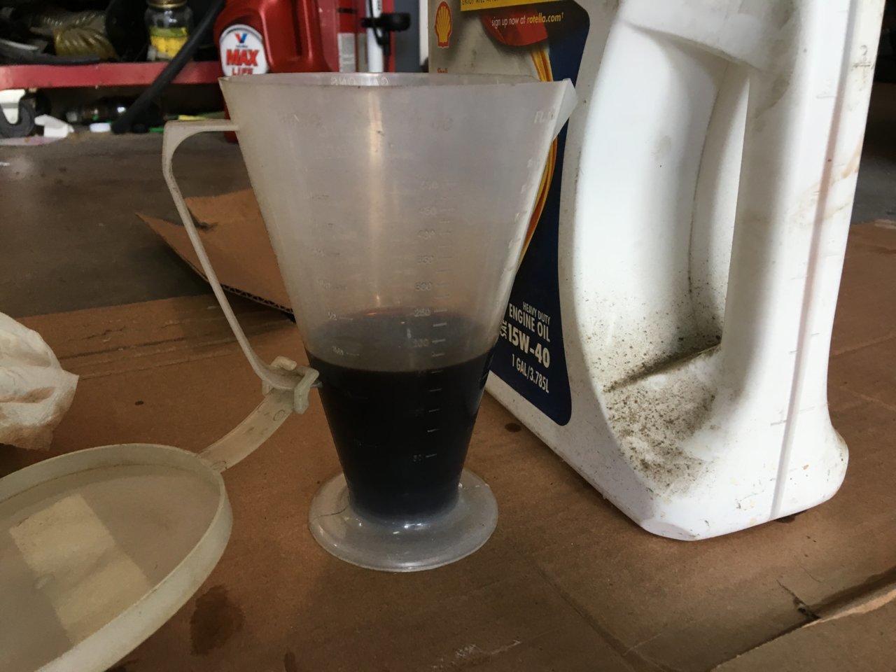

    Here is a picture of the four drain cycles with one drop of fresh clean fluid. Notice how with each cycle the fluid get better, less brown more red. Top to bottom is 1st to 4th drain cycle. Dot to right is fresh fluid.

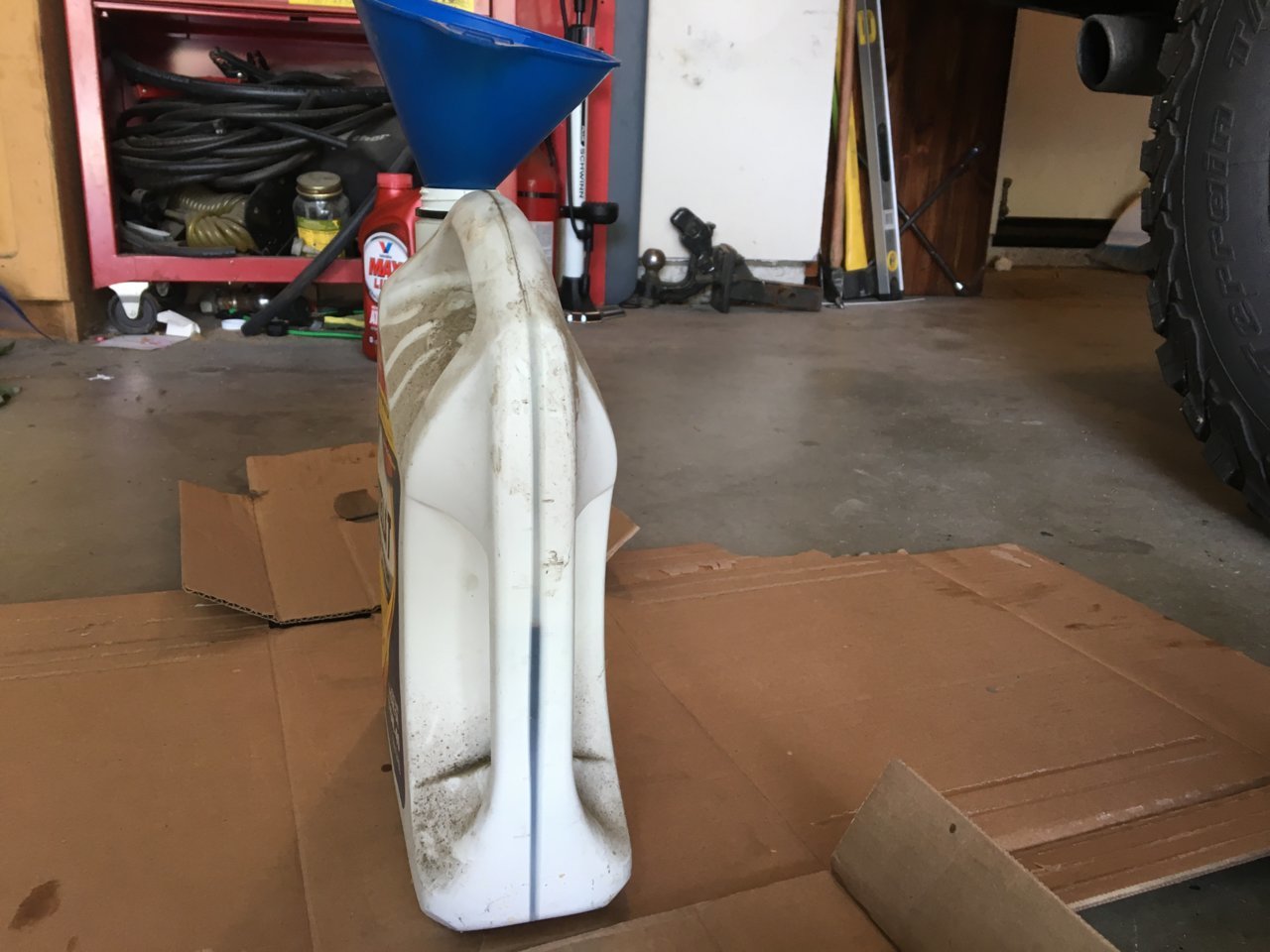

    I used an old 1 gallon oil container as my measuring cup. Drain trans fluid into pan, transfer pan to oil container and measure. Then pump fresh atf into trans with an additional 1/4 to 1/2 quart. The first drain emptied 2 and 3/4 quarts after truck sat overnight. The remaining drains were around 2 and 1/4 quarts.

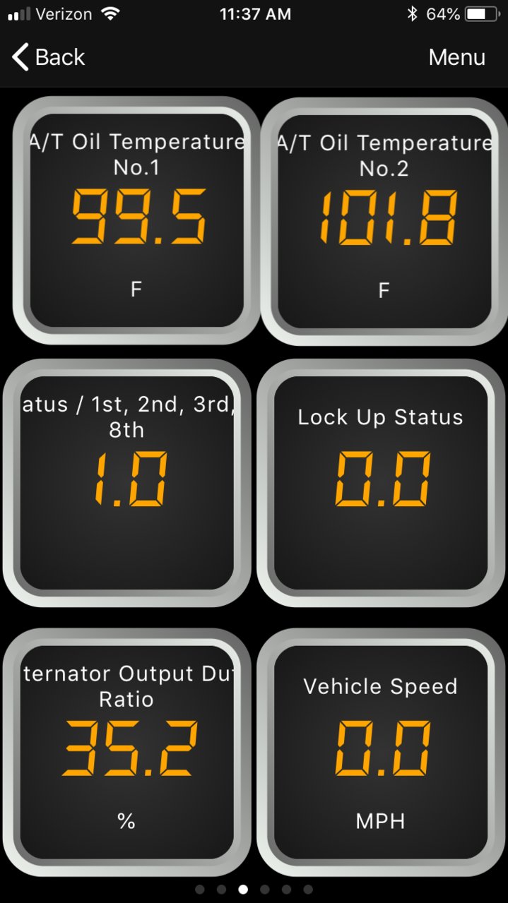

    Temp at start of fluid check. And temp at end of fluid check.
