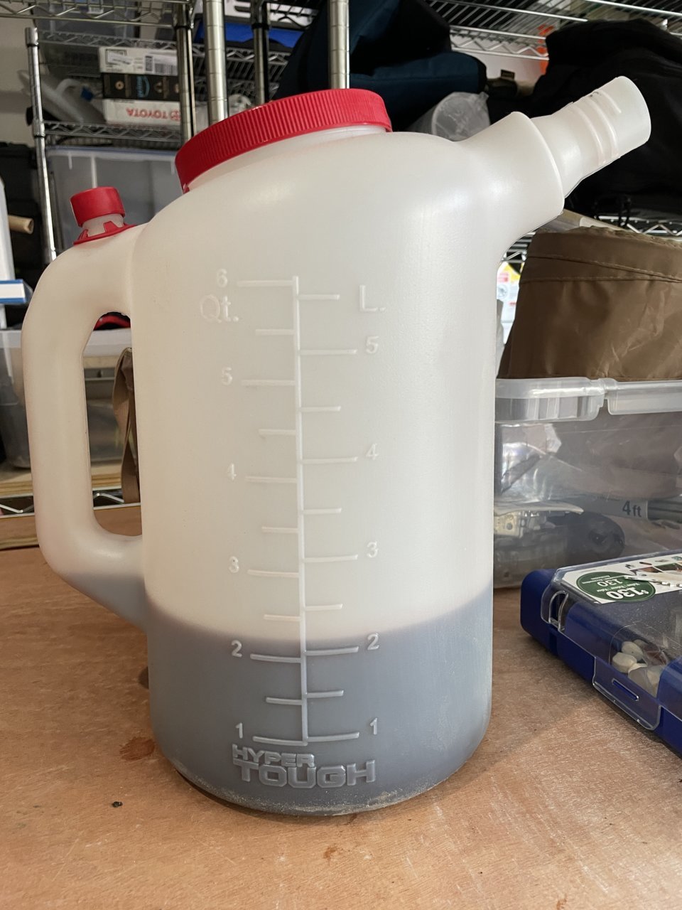

    Hi - i know this is an old thread, but it has great info I would like to add to.
    I found a 2018 Taco with low miles and had been reading the threads about the 2016 - 2018 Tacos being 1 qt low. A local transmission specialist confirmed that Toyota and Ford are notorious for being 1qt low from the factory…. Follow the $, they save millions on 1qt low…
    The first thing I did was drop the oil into a measuring container. Sure enough, 1+ qts low (photo attached). This is my first Taco, and I love it. However, if you are waiting 30,000 or more miles running 1 qt low, who knows what long term damage is being done…
