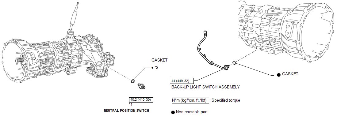

    Manual transmission only has a reverse and neutral switch, so that's the easy electrical part.
