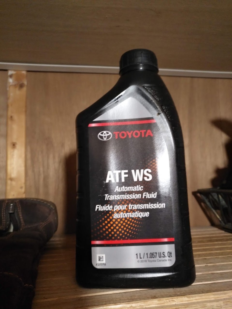

    Not to start anything but, what is a good ATF fluid to use if the dealer does not sell the Toyota branded fluid? I checked the dealer for it and was told that they did not have it in stock at the time. Any recommendations?

    followed the guide and things went rather smoothly! thanks for the write up, apparently i've been about 500 ml-750 ml low for some time now. but adding in what should have be there hasn't changed driving performance, which is a good sign
    i did a dump and fill at first and was trying to explain to my dad the procedure on how to change the fluid (this guide) so after showing him the guide itself he realized shit's not the same as his GMC savana from nearly 20 years ago :notsure:
    Did the rest of the guide and when i got the truck into temp mode and checked the overflow, nothing came rushing out.
    stopped the truck, rinse and repeat but put in another liter of fluid and what poured out is what poured out>
    Thanks again for the write up!
    Yeah i too capped it off at about the same point as you, looking into the hole from where it was pouring out, i seemed to have been just running along the threads, but it was at a trickle/ steady thin stream coming out
    I picked up a few bottles without issue yesterday, i don't see why a dealer wouldn't sell it or wouldn't have any in stock... i'd just call ahead to another dealer and so on.

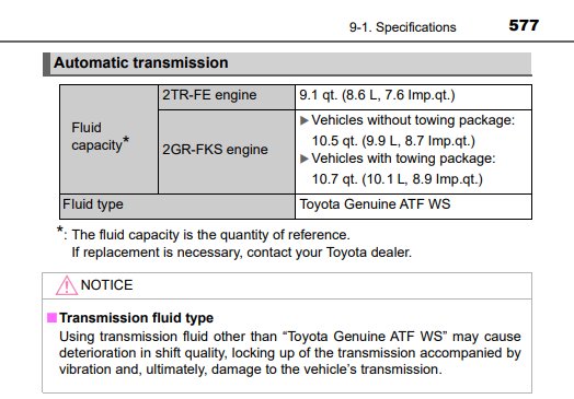

    but brand wise, as our user manual states; it recommends the ATF WS stuff

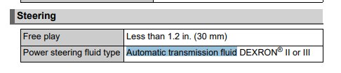

    but power steering fluid brings up "Automatic Transmission Fluid DEXRON 2 or 3"
    If i were you, i'd keep looking to find something more concrete than this, but i doubt any dealership wont have anything, the ATF fluid is pretty cheap. but if you had to get something, i think that's your best bet for now

    I started down the same road when I first began considering doing this job. After not really finding a definitive answer, I just decided to use the link the OP gave to Amazon for 4 bottles of the Toyota brand fluid. Took a little less than a week to arrive, and it’s exactly what the manual specifies.

    WS fluid is a low viscosity it's not anything special exactly it's made by Mobil .... Lots of brands that meet the spec
