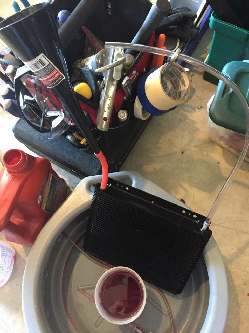

    Dec 6, 2017
    #237812
    850
    2025 OR DC iF Max
    Im not a scientist of any kind. The information can be found using an internet connected hand held computer device.
    From ambient temperature at the Toyota factory to typical operating temperature the transmission fluid might expand around 3 or 4 percent depending on the fluid. It’s a very small percentage of expansion per degree C or F. The information obtained may vary.
    If the transmission holds 10 quarts, that’s 320 ounces of fluid. So your expansion might be several ounces in volume at high operating temperatures.
    That’s why it’s not that critical to have an exact temperature when checking at around 100 degrees or so. The fluid will not have expanded very much.
    When it was new, my Tacoma transmission was clunking when shifting from Park to Reverse and from Reverse to Drive.
    After adding a quart of fluid, the clunking was gone.
    Days later I did the fluid level check and just a few ounces came out. It was about 28 ounces low from the factory.
    Just curious, at a later date, checking the volume of the stock and aftermarket coolers while pre filling.
    D44C00F2-508E-44AC-9FE9-DCE8616DA9C5.jpg 15F82BEA-1A90-4CB9-B665-41EE48EC19D9.jpg
