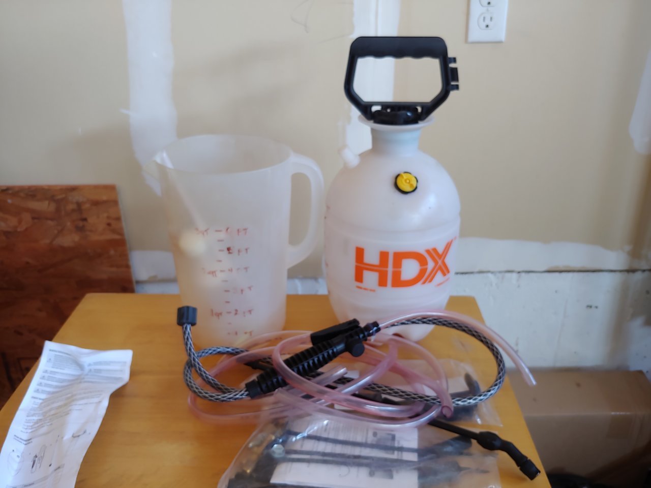

    the transmission fluid check mode is when it is in the proper temp range. I purchased a hand pump weed sprayer specifically for doing my transmission fluid items. It can be used to add fluid at the oem trans cooler into the return hose, or into the tans plug.

    Likely you will need hand pump regardless of which approach you use. Add excess fluid- bring to temp- remove check bolt- replace check bolt when stream becomes flutter. And pump also connects to oem tow cooler return.

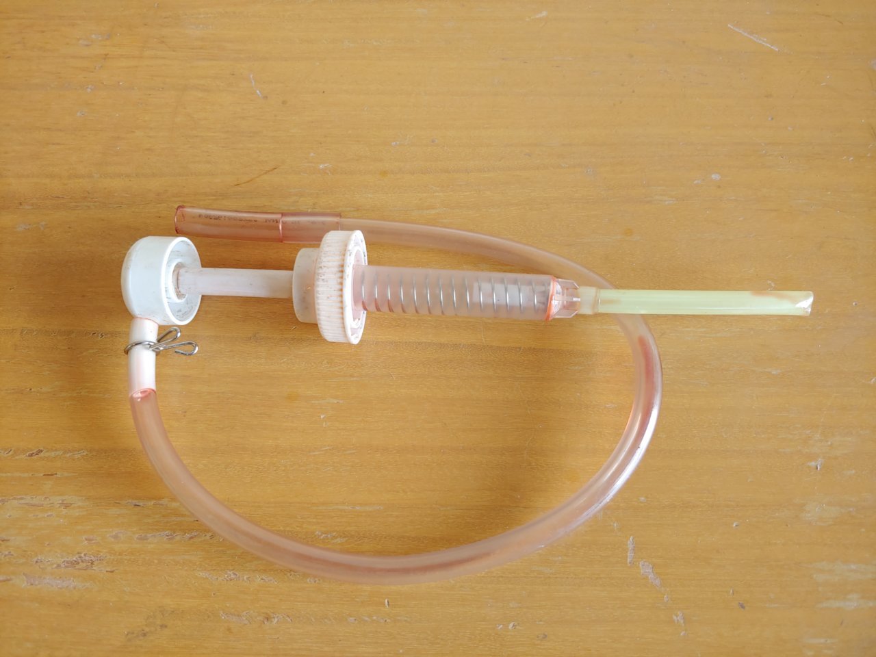

    Fluid Extractor, Manual, 7-1/2 in. L https://www.amazon.com/dp/B00MPQ8RBG/ref=cm_sw_r_cp_api_glc_i_ud36Fb9A5YTPX
    These seem to work better than the hand pumps, I've never had good luck with those. The always leaked. Plus with this you can do power steering flushes and whatnot. It also has a scale so u can monitor the amount u add.
