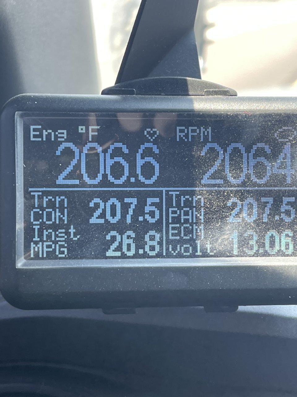

    I forgot about this! So I pinned my thermostat recently (month or so), temps don't seem to change, in fact they might be a little worse, as the air has "less" time to interact with the hot oil.

    odd, but if the results say that is the case then it must be possible. I also have a Hayden Trans. cooler I added to the OEM Tow cooler. If pinning the thermostat did not add any benefit and in some cases made it worse you would wonder about the entire system design. I just came back from a trip towing the camper over the mountain passes - transmission temp on longest grades over 10,000 never got above 190 and it was unseasonably hot - about 90 air temp - not hot like your part of the country though.

    I wonder if there's some small variable that causes mine to run hot. Like a burr interrupting fluid flow in an elbow somewhere. I might get a bigger / better trans cooler. Mine is just tube n fin. Idk how efficient it is.
    ETA: that pic is from driving down the freeway here. No load about 80mph

    I installed a TruCool LPD 4490 which TruCool rates at 22,000# and 20,000 BTU's and I'm still seeing trans. temps. of over 200°F. I also was thinking maybe there was something impeding flow to the cooler but I've stopped abruptly and popped the hood when I've seen temps over 200° and the cooler itself was hot as were the lines running to it. That would indicate that the cooler is actually doing it's job. I left the factory cooler in line and it's also plenty hot. I was hoping for much, much lower temps.

    U live where it's hot as well? My cooler is definitely doing it's job, I can feel the temp difference between the upper and lower rad line, I think at certain points it just overwhelms the whole system.

    I'm in north-central Illinois and we're seeing daytime highs of upper 80's, lower 90's.
    I too can feel the temperature difference between the inlet line and the outlet line, so yes, it's obvious that the cooler is extracting heat from the fluid.
    These Toyota transmissions are obviously designed to run much hotter than some others. I have a ScanGauge II on a late model Ford F-250 Super Duty and I've yet to see trans. fluid temps over 185°F. I tow heavy with the F-250 about 80% of it's yearly mileage so it has ample opportunity to get hot. I realize the two vehicles are engineered differently and are designed for much different usage but that is a stark difference.
    I get nervous when I see the Taco trans. temps. spike up to over 200° when the Ford is comfortably at 175° pulling 6 tons!!
