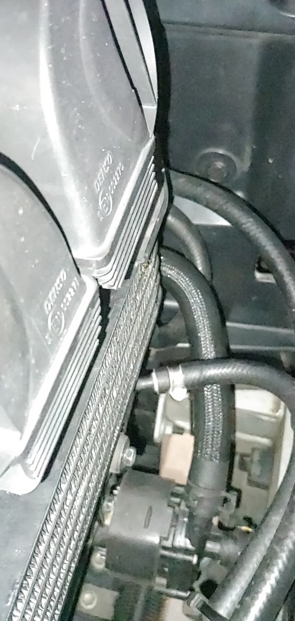

    Do you pin the trans. fluid thermostat open and did you bypass the radiator? I'm going to try that before I spend another C note and a half day installation time to try a different brand cooler. As I said, I can't physically go with any larger cooler and the cooler I have is definitely removing heat from the fluid. The difference between the inlet temp. and the discharge temp. is significant and unmistakable.
    I really don't see a significant lowering of temps. on the ScanGauge now as opposed to prior to installing the cooler.

    QUOTE="Illini Tacoma, post: 25886902, member: 354145"]Do you pin the trans. fluid thermostat open and did you bypass the radiator? I'm going to try that before I spend another C note and a half day installation time to try a different brand cooler. As I said, I can't physically go with any larger cooler and the cooler I have is definitely removing heat from the fluid. The difference between the inlet temp. and the discharge temp. is significant and unmistakable.
    I really don't see a significant lowering of temps. on the ScanGauge now as opposed to prior to installing the cooler.[/QUOTE]
    yes I have the thermostat pinned open. Did not bypass anything - the Hayden is in series with the directional flow of the system.
    Ignore the big hose and pump housing in the middle of the pic - that is the cooling pump /hose for my SC unit. The hose coming from the oem tow package cooler (hose connection closest to the passenger side on the bottom of the oem tow cooler shown in the pic) is connected to the top inlet of the Hayden cooler. The bottom discharge connection from the Hayden cooler is connected to the oem connection for the return to the transmission (this is the top hose connection going into the radiator from which the original system connected the tow cooler back to the transmission return flow).
    NOTE: There are lots of pics and information available on the 3rd Gen Forum under the thread "3rd gen transmission Cooler Upgrade." I run the Hayden 679 unit. Check it out.
    NOTE: There are lots of pics and information available on the 3rd Gen Forum under the thread "3rd gen transmission Cooler Upgrade." I run the Hayden 679 unit. Check it out.[/QUOTE]
    Interesting. I pulled my OEM completely. Probably another factor.
