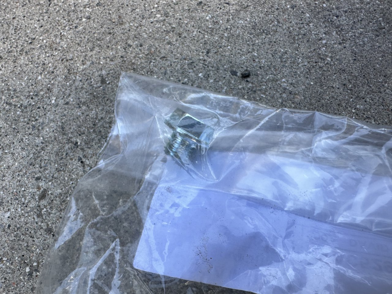

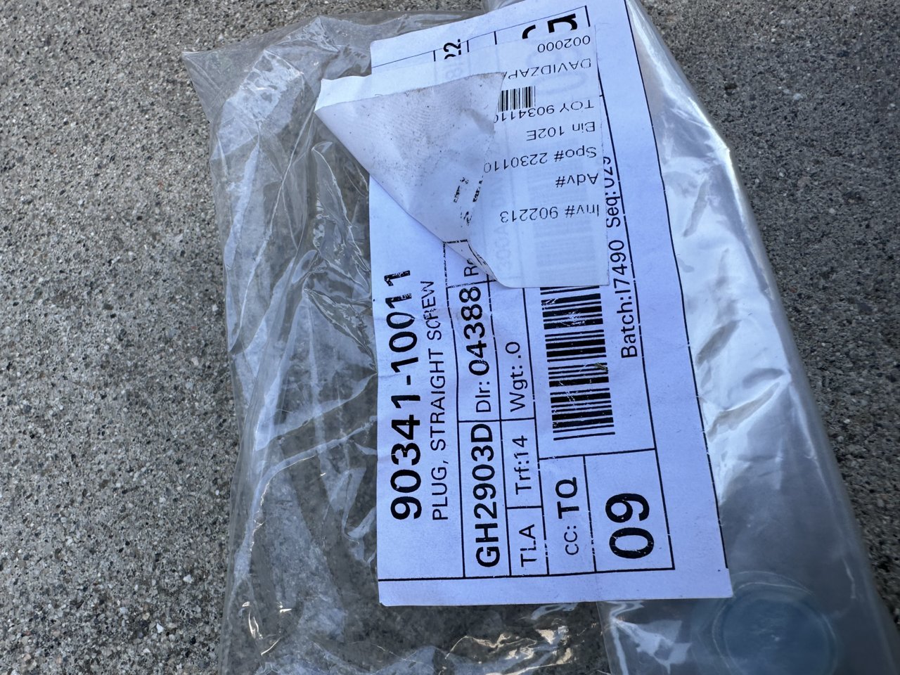

    David
    Riverside,CA
    Ford F150
    You can can do that actually.

  9. Oct 29, 2022 at 9:49 PM
    #489
    Bishop84
    Bishop84 Well-Known Member
    Dec 17, 2015
    #172494
    12,192
    Yup. I meant a standard bolt. Drain plug is tapered as well.

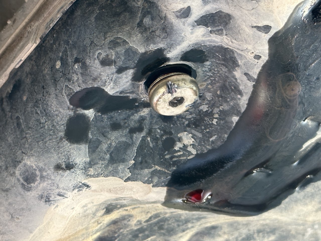

    If you have an angle grinder or Dremel, you can grind two flats on the plug head and use a wrench. Need to be extremely careful not to cut into the pan.

    2019 Black Toyota Tacoma SR V6 4x4 Double Cab
    what the hell did you do to that plug
