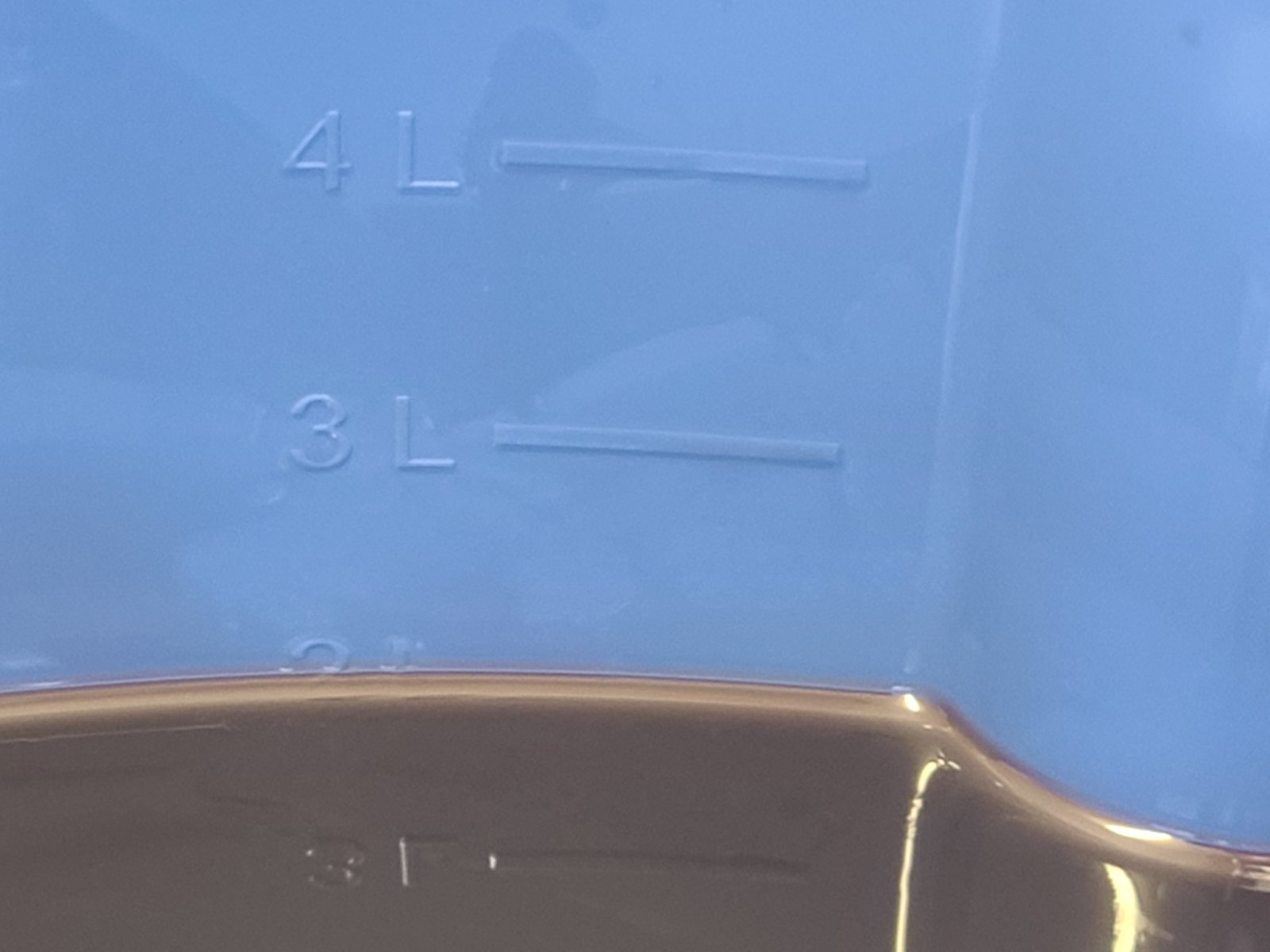

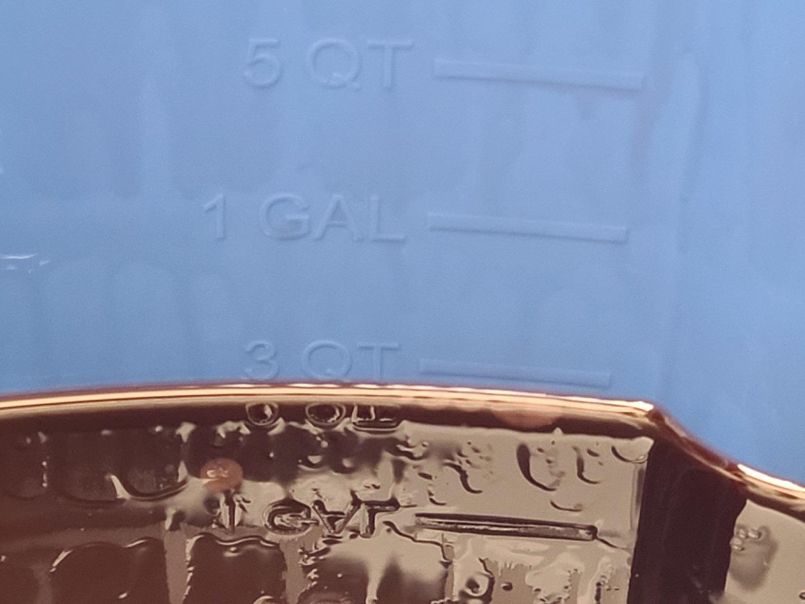

    When I did my drain/fill, I took out this much:
    Put 3 qts in, did the temp check part, and it brought toal bucket up yo here (original drain plus overfill):
