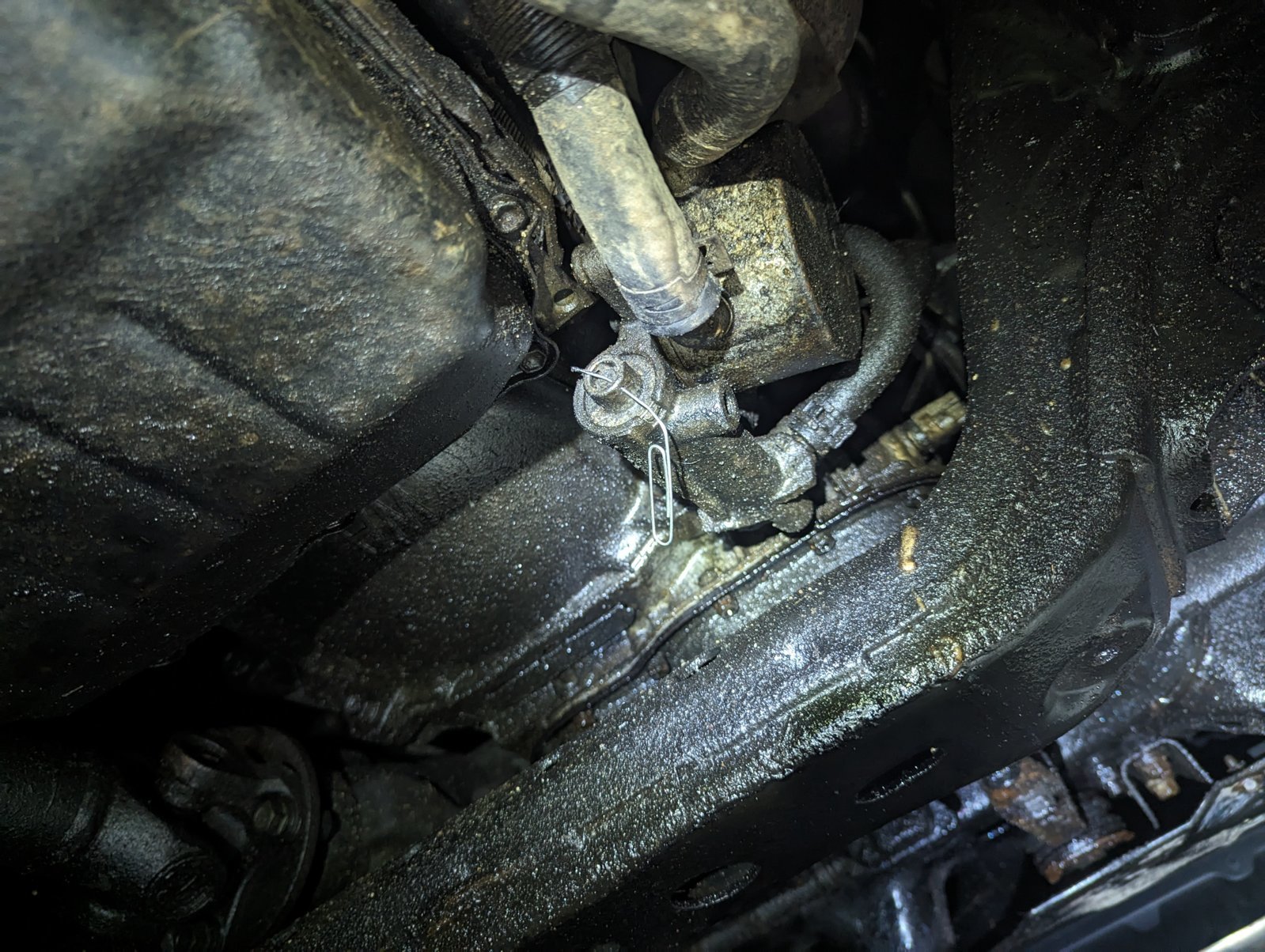

    Noticed a leak under the truck this morning (2016 SR5 with tow package). Ended up being a leak from the transmission cooler line. They replaced the lines and leveled/balanced the fluid in the trans. I went under the truck and noticed this (pictured). Seems like they left the paperclip in the transmission thermostat? Can I removed it? Should there be an actual pin there? Not happy to see a 1 cent paperclip under my truck after paying $830. Thanks

    Just pull it. It is a part of the check fluid procedure to pin the thermostat.
    No harm was done.

    It doesnt do any harm, some people intentionally do it to circulate the fluid and keep it cold.
    You are correct that it should be done right for that price.
