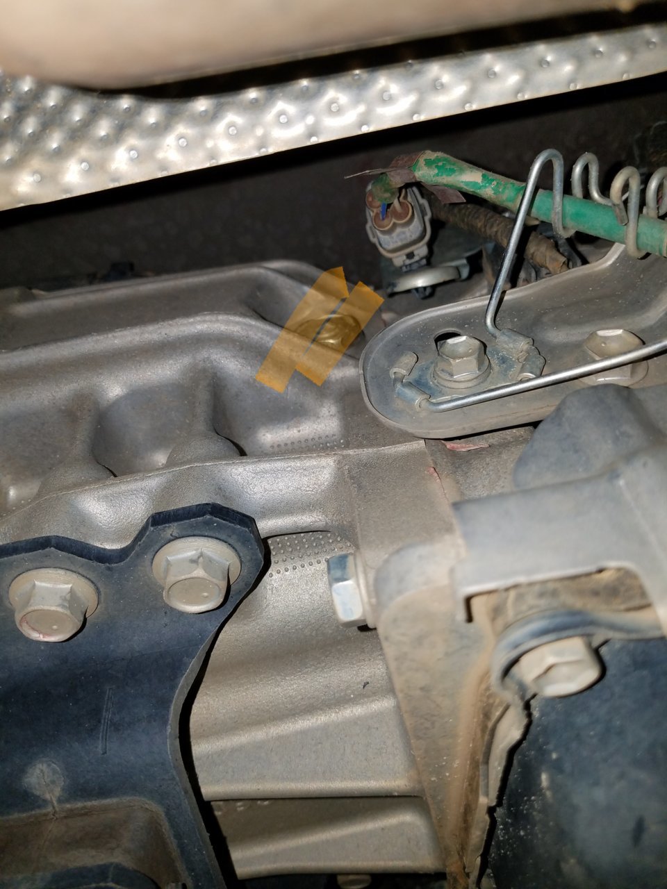

    Sorry for the late response. I can take a picture of the fill plug on the 4x4 when I get home. Its up pretty high on the passenger side of the transmission. Lots of stuff in the way of the fill plug.

    Fill plug to the left of the green wire on a 4x4. (Highlighted it in Orange)

    This is all I know.

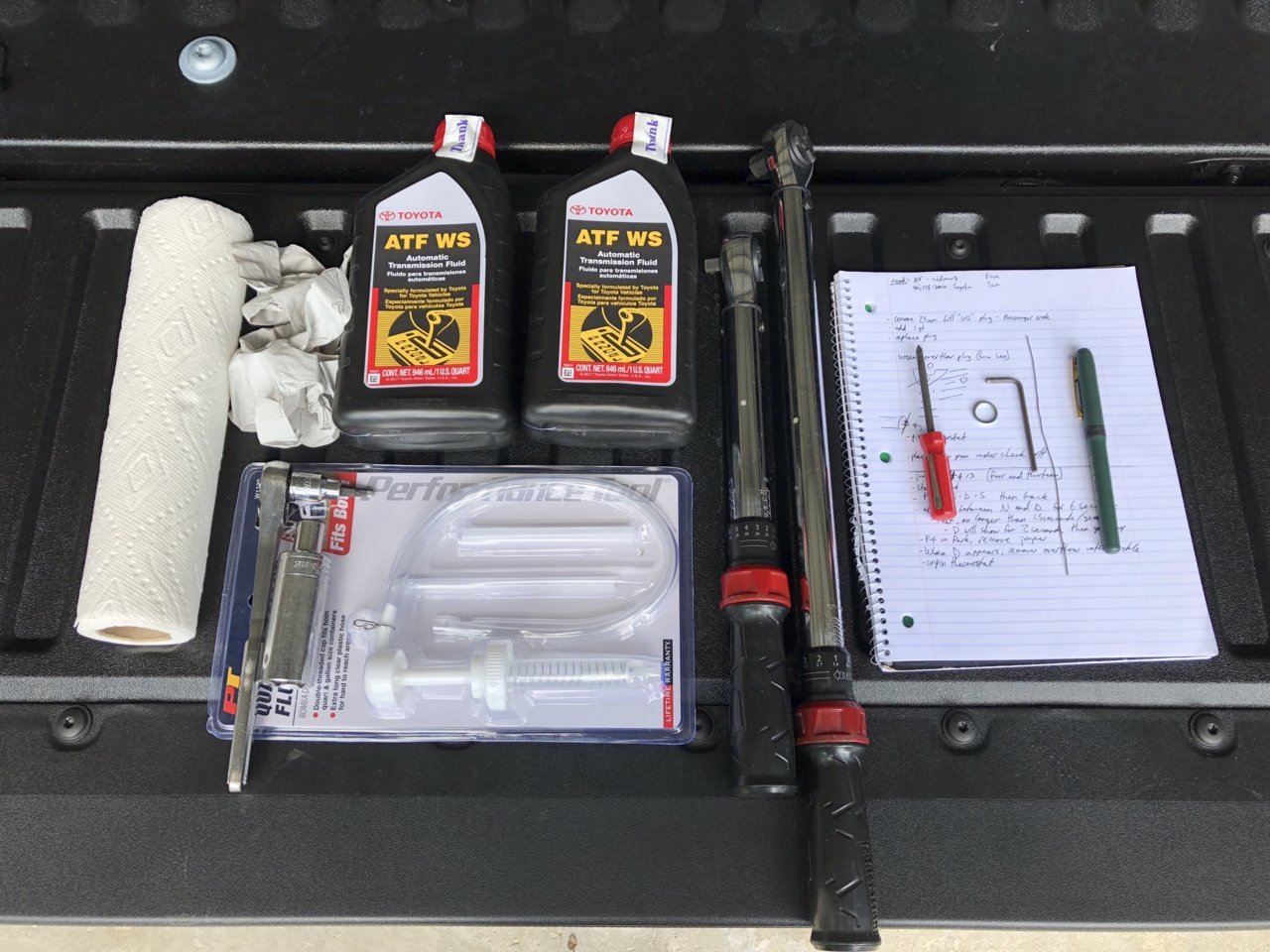

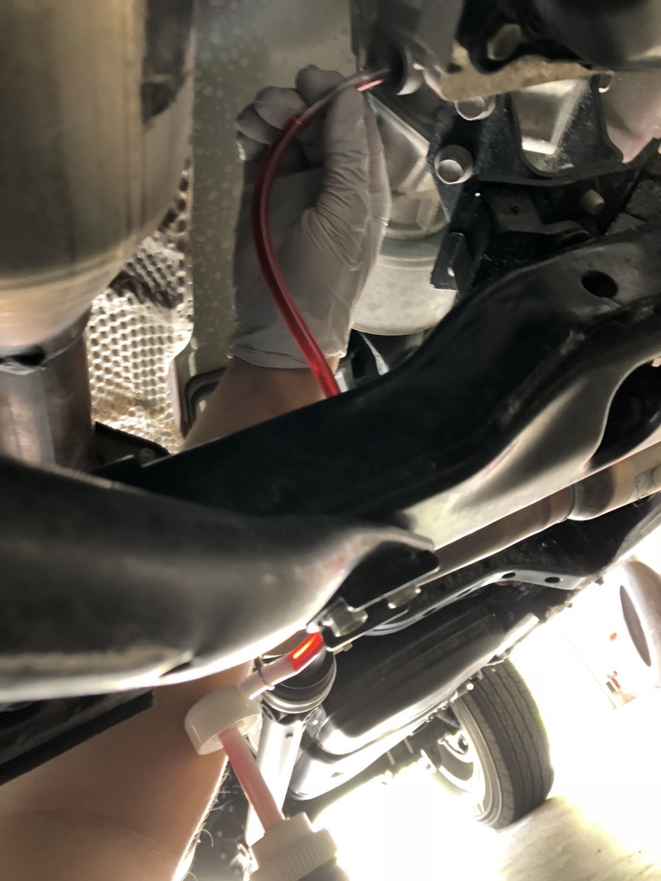

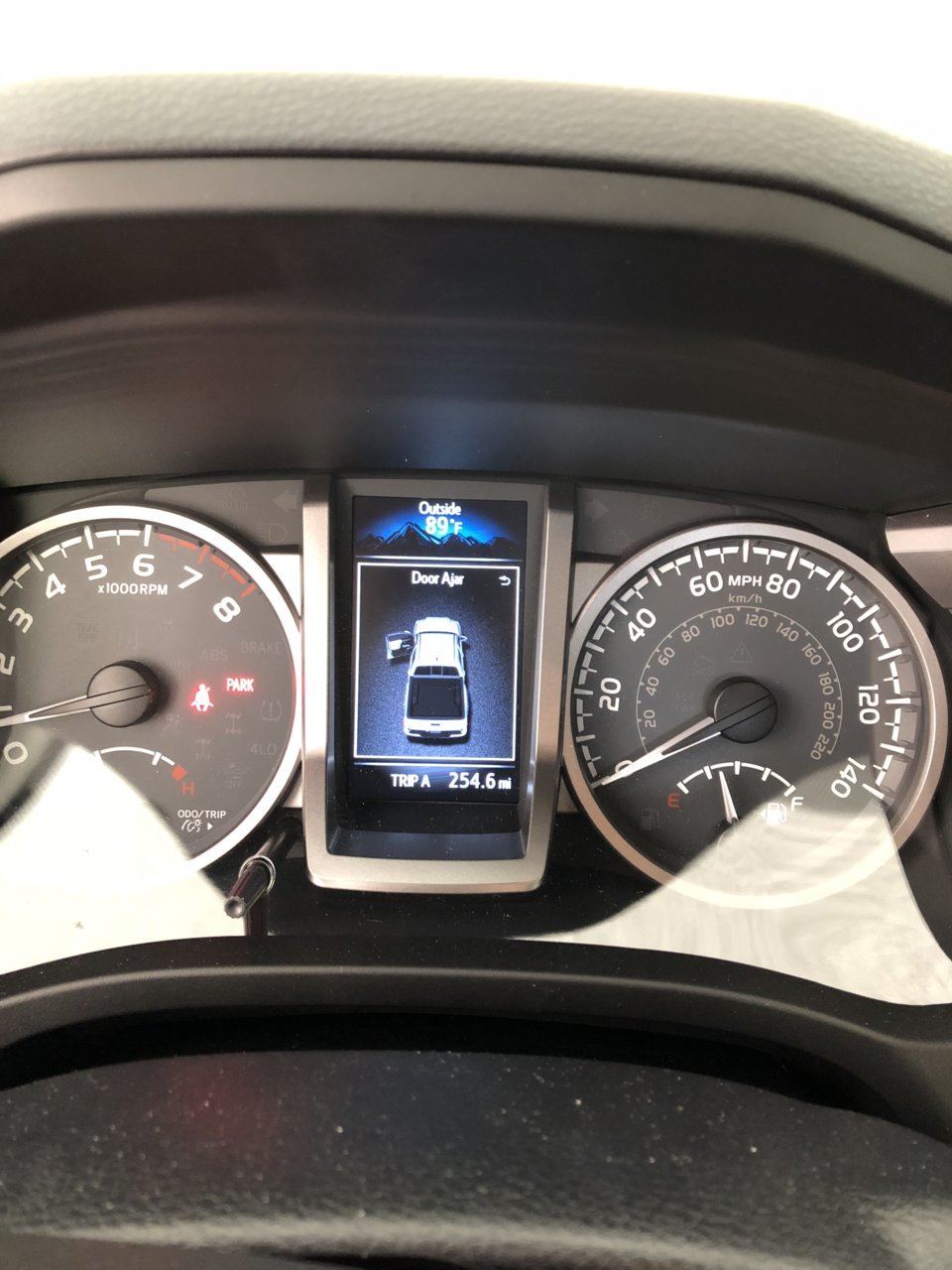

    Did this today for peace of mind at 600-700 miles on my 2018 V6 2WD. Thanks a lot for the write up! Pinned the thermostat and the truck took just under a 1/4 of a quart. Makes sense since I wasn’t experiencing bad shift characteristics like other members were experiencing. Will report back if there’s a noticeable difference while driving.
