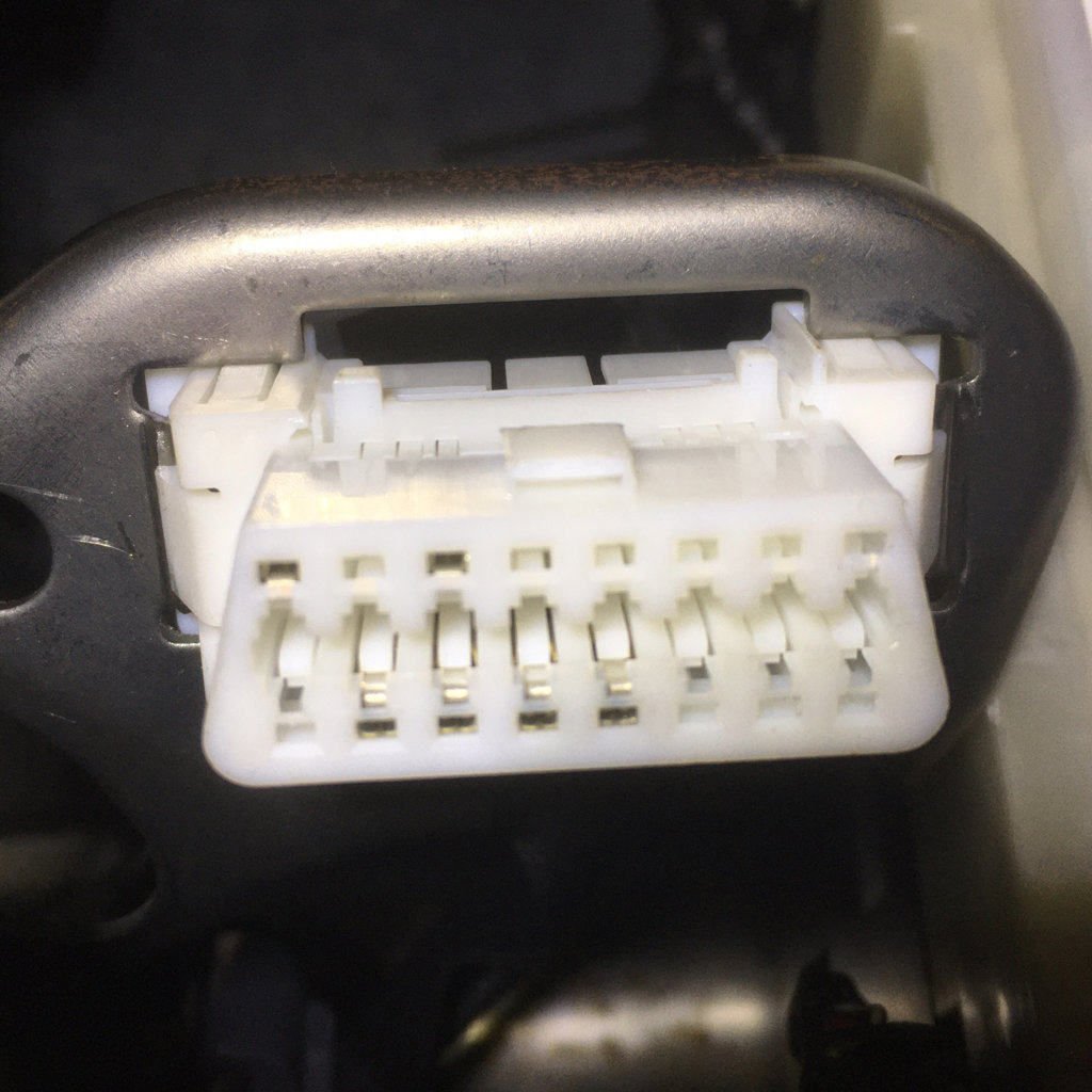

    On my 2023 SR v6 4x4 pin #13 appears to be a blank. Pin #4 which is a ground is there but no pin #13 which is a mfg pin according to the standard. Anyone else have this problem? I could not get it into check mode with a jumper wire. A dealer said he checked it but the receipt did not show any warranty parts and there should have been at least a crush washer.
    Post #589 mentioned OBD Fusion but when I emailed them last month after trying last year, they still did not support trans temp on a 2022 or 2023. Maybe scan gauge will work but not sure about the missing pin. My Actron OBDII works fine for basic info an cat temps but AT temp is not part of the OBDII info. My TPMS tool also works fine but most not use pin #13.

    I did get my 2023 with no pin #13 to go into check mode without a jumper. I don't remember the extra lights flashing in the instrument cluster. I bought a ScanGauge 3 and plugged that in when already in check mode. The lower temp when D lit up was exact per service manual at 95 degrees but did not blink until 118 degrees though the manual said it should be 115. I'd prefer to finish the check by the lower temp so it won't be under filled.
