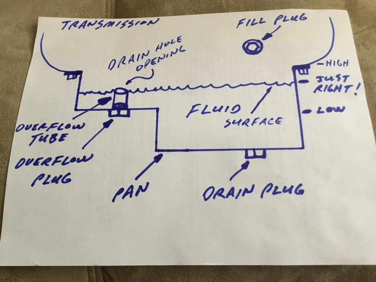

    I have a question that still bugs me and have no answer...
    1. what is the way the transmission fluid is checked? Went twice to the dealer (different dealers) for other reasons and asked for the fluid to be checked. Each time I was told the fluid is OK. How did they come to this conclusion? Is there a way to check the fluid level electronically? how? I know I was given this answer to go away but if the dealer would be honest, how could it be checked?
    2. I do not have any problems I read here, or maybe I am ignorant to bad transmission problems/issues...but if I would just add 1/4 or about of fluid into it what could happen?
    I would like to know the fluid level without draining, adding, draining, adding...

    That would need a dipstick.
    W/O a dipstick, you have to(?) overfill, and then crack the 5mm allen screw loose to see what falls out. In the perfect temp range. When dead level.

    Completed this procedure and read all pages of this thread.
    Big ups to rowsdower...dude thank you for putting that together, I know that making these sorts of things takes some time.
    I have a 2019 DCSB TRD OR 4x4. Build date is 3/19 per door jamb sticker. My truck only took ~2 oz. of fluid to top off. I didn't have any shifting issues, I did this purely for piece of mind. I really love this truck and hope to keep it around a long time. I'm glad to have done this myself rather than take it to the dealer, as the 2 oz difference was so small that the dealer probably would have told me that it was basically right on the money, and I would be left with that nagging feeling that they hadn't actually checked it or taken the time to do it correctly. I hate to be a cynic but i've been given a few too many reasons not to be (in the automotive realm).
    Anyone who is wondering how critical temperature is. I'd say it's critical. Toyota's design concept here rides on the principal of thermal expansion. One person had mentioned that they didn't think that fluids expanded much with temp change. That's quite false. A pretty quick and easy demo would be to just check your engine oil first thing, stone cold on level ground. Then check it again on the same level ground after at least 15-20 minutes of driving. (***Not when your coolant temp gauge comes up to temp...oil takes considerably longer to come up.) You'll likely notice a >1/2 quart fluctuation on your dipstick between ambient and operating temp.
    This is the reason why that temp is so crucial here. The standpipe connected to the overflow is perfectly calibrated for the fluid level at a certain temperature, taking that expansion into consideration. That's the only way that a system like this can be accurate. Great work on this drawing, OregontoBajaCA. Spot on.
    I also watched the video of the autoshop professor.
    That equipment is not necessary if you check the fluid level within the correct temp range. The whole point of putting the sump under a vacuum is so you can install that adjustable standpipe to allow for variation in temperature. Again, the standpipe in the sump from the factory is calibrated for one range, hence checking with the vehicle in temp check mode per this procedure.

    The easy way would be to make the overflow tube at the perfect height when the transmission temperature is after driving or to make it at the height when is cold. Cold would be best method. Park it on a leveled surface, let it cool of over night, remove the plug and add till it drips.
