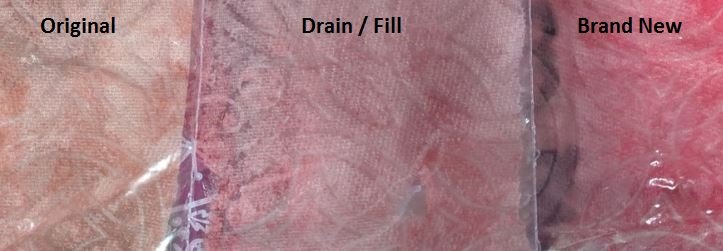

    I decided to do a full drain / fill following this procedure as outlined on this thread because I'm at 12,000 miles already. Pinned the thermostat (I have the tow package). I was a little surprised to see that the fluid was more of an Orange color, but looked much better after the procedure. Drained out 3 quarts, put in 4, and got 1 out so I had enough fluid out of the factory. I'll do a drain fill more frequently moving forward.
    My wife and I feel that the original fluid smells identical to brand new fluid.
