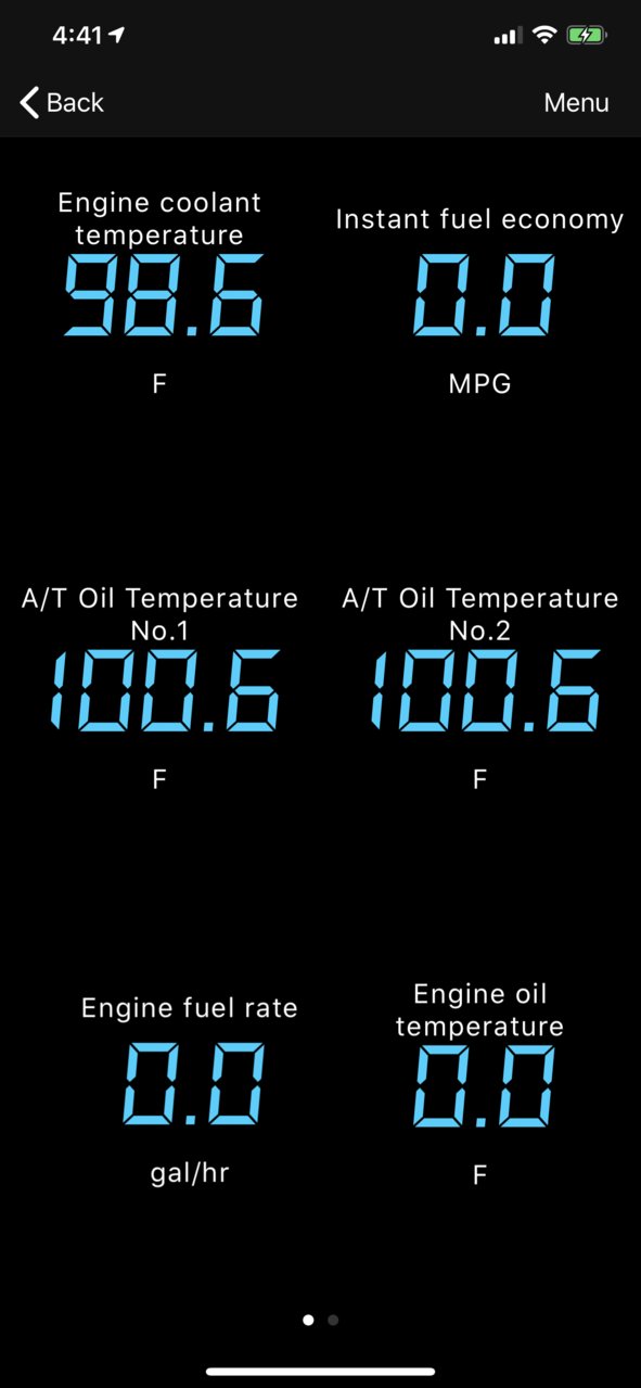

  10. Jul 2, 2019 at 5:11 AM
    #150
    Skydvrr
    Skydvrr IG: @kalopsianick
    Sep 13, 2017
    #229889
    12,652
    Nick
    YMH
    Black '17 OR
    Ambient =/= oil temperature. Be careful folks. This was taken first thing in the AM, no vehicle running.
  11. Jul 2, 2019 at 6:26 AM
    #151
    Light1984
    Light1984 Well-Known Member
    Nov 30, 2017
    #237337
    243
    24 TRD OR Hybrid Bronze Oxide
    I'm confused, 100 degrees would be the perfect temperature to complete this fluid level check. If you have some sort of scanner to show these numbers, couldn't you just do the check without going through the process in the OP?
    cryptolyme likes this.
  12. Jul 2, 2019 at 7:16 AM
    #152
    Skydvrr
    Sep 13, 2017
    #229889
    12,652
    Nick
    YMH
    Black '17 OR
    The problem is people are trying to do this without a scanner and without knowing the oil temp, assuming the ambient is what the oil temp would be. That's not the case. That was my only point.
    cryptolyme and (deleted member) like this.
