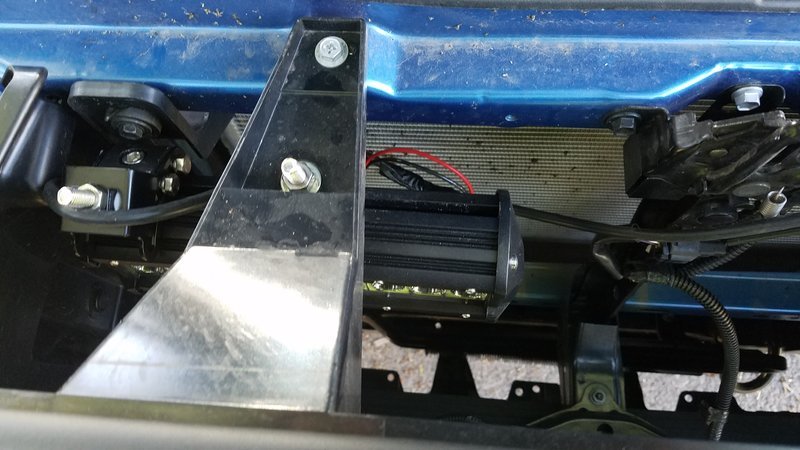

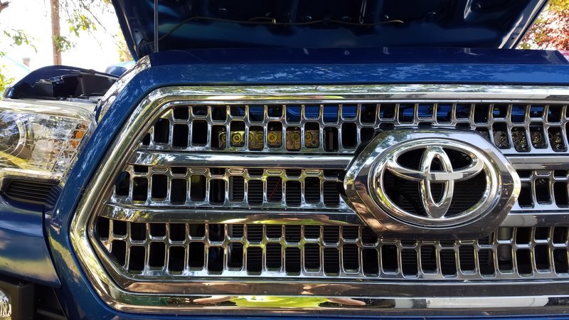

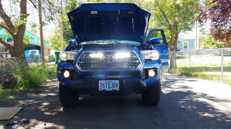

    I've been wanting a couple of spot lights to get a little more distance then my 30 inch combo bar. So I ordered a couple of 10 inch spot lights, the only half-way stealthy place was behind the giant grill. Happily there are two holes on the plastic support beams that are perfect to mount them.
    I spliced them in to my fog lights (planning on doing the anytime fog light mod soon.)
