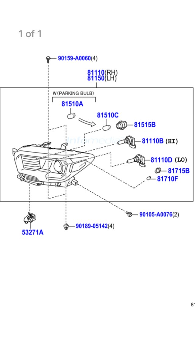

    Unfortunately I lost both while changing out my headlights to an aftermarket setupup today, that is a great suggestion though

    Isn't it the same as the 10 mm that's on top of the light?

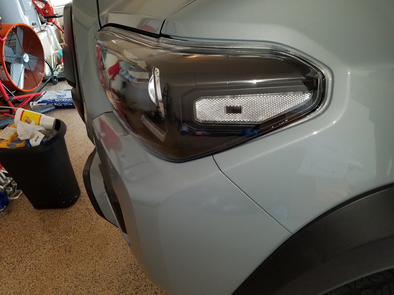

    Is there anywhere that sells a clear marker to replace the amber reflector in the headlight? It would look so much cleaner. Or maybe even take the amber reflector out and add a chrome amber bulb?

    I thought I remembered it being a bolt but I'll try and see if that fits in the morning, good idea, thanks!

    I can’t for the life of me remember the brand as I did this over a year ago, but all I did was swap out the amber bulb for a chrome one and it looks great.

    It would look bad without something in that spot. This is my headlights. DK moulds made my side markers. This is the light smoke version, there is a clear and dark smoke version as well.

    This is exactly what I was looking for, did you have to custom order it or they already have them in stock?

    Supposedly they custom make them, but I would bet someone would have then in stock. Check Lightwerkz site. Those dudes are the go to company imo for retrofits. I did hear that DK moulds building burned to the ground recently, but someone has to have a set in stock.

    It’s not the same bolt.

    Thank you, I ended up finding a diagram of the housing and the part number is 90105-A0076 and my dealership is just going to sell them to be for two bucks.IMG_2745.jpg
