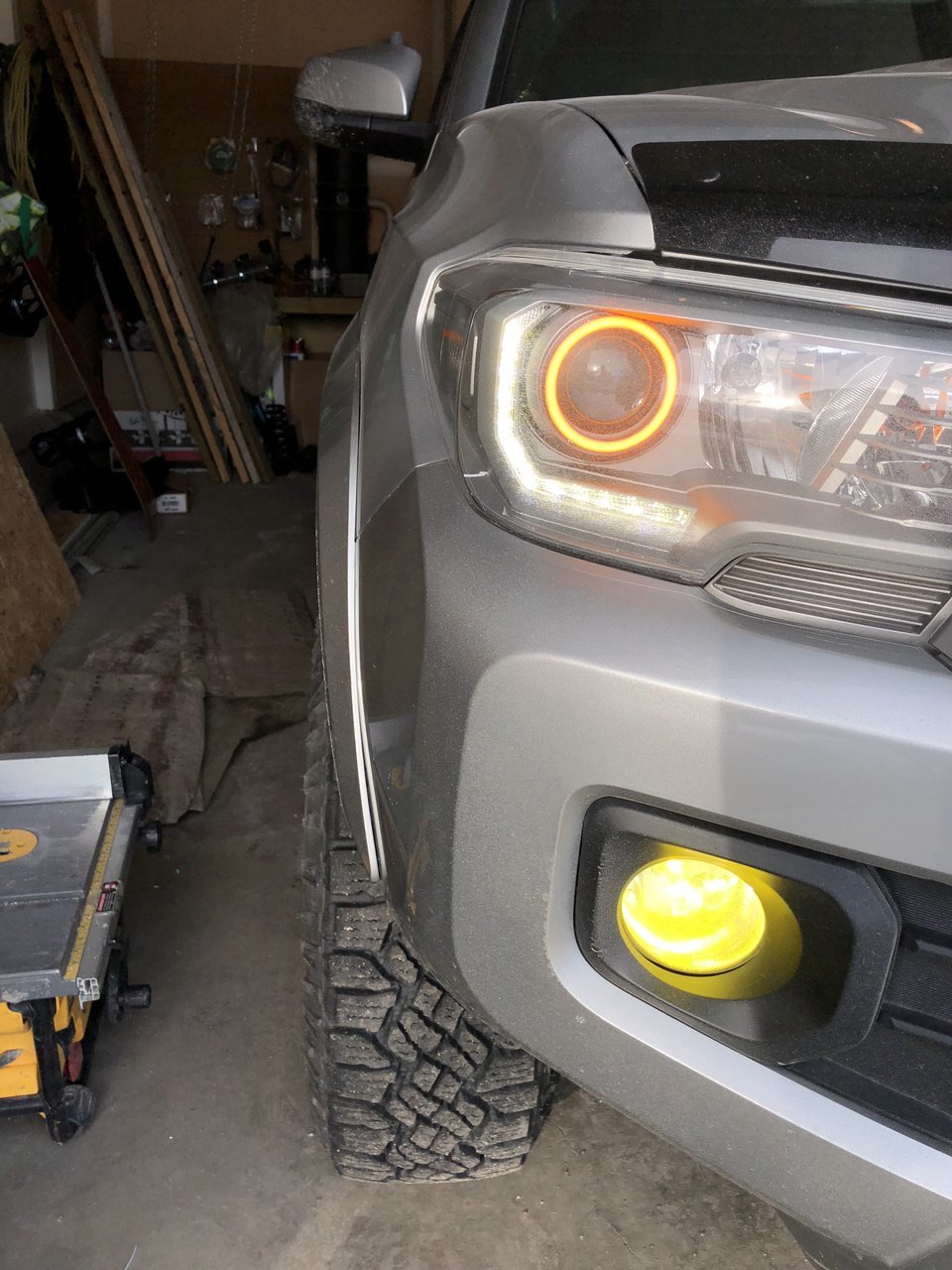

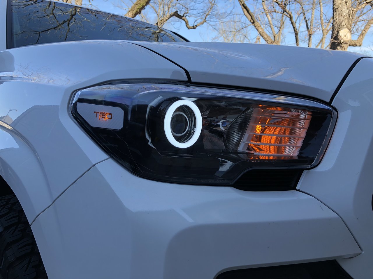

    BHLM, Switchback Halos, White carbon fiber reflector with TRD logo cut outIMG_7643-2.jpgIMG_7647-2.jpg

    Switch the orange yellow to keep orange on ft

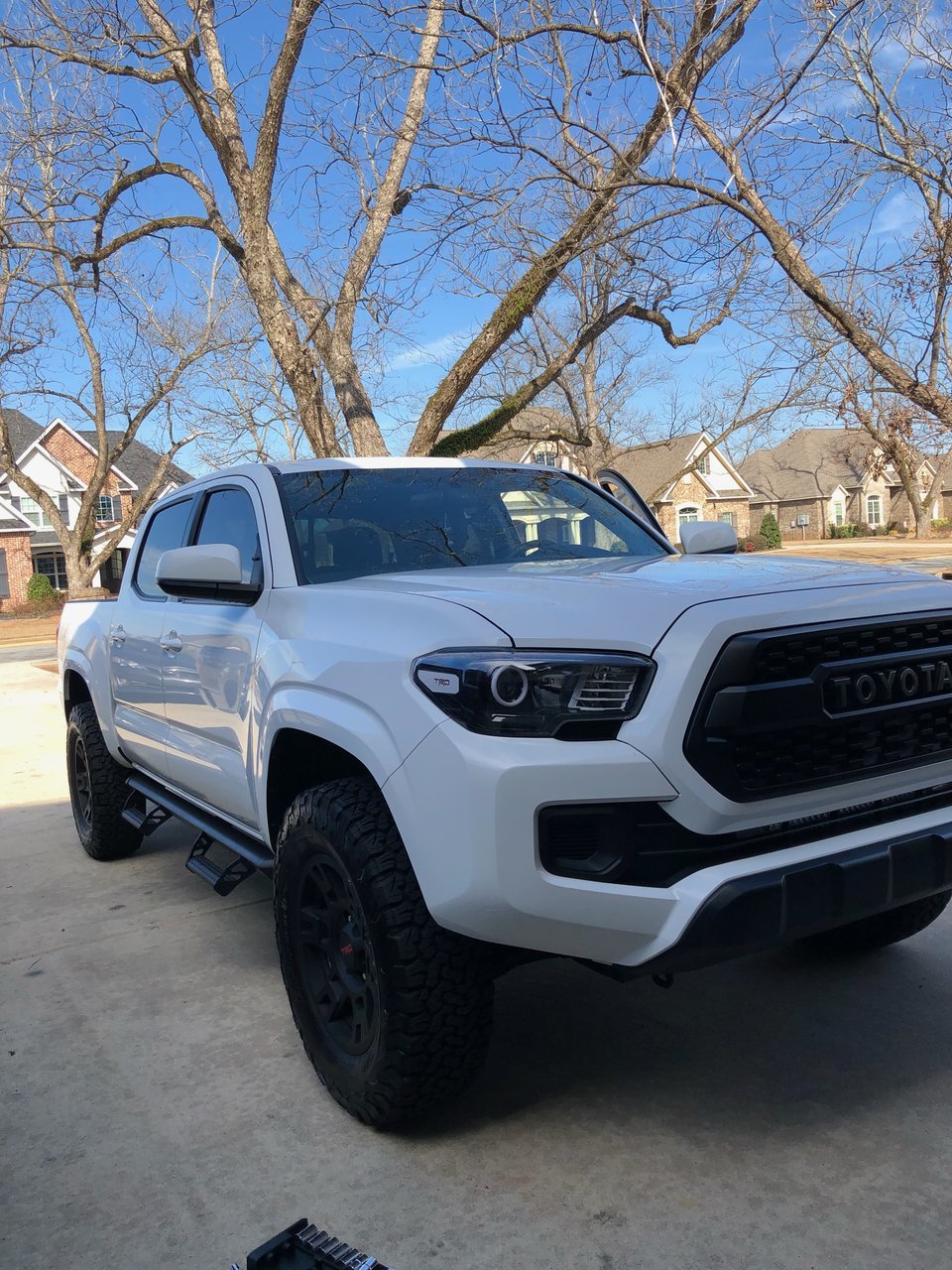

    popped 1 headlight open and painted it a combination of gloss black and some matte. still haven't scraped the old sealant yet- too tedious. i might try the dremel method. i have some switchback halos but i think im liking it more simple

    @johnny6 looks great. Did you do anything else or just a BHLM?
    They are so much work to open and clean, I scream a little inside when people don't do any performance modifications while they're open. Maybe it's the light whore inside me...

    i thought about it but its my first headlight so i didn't want to retrofit anything. i have HID and its bright enough for this peasant :)

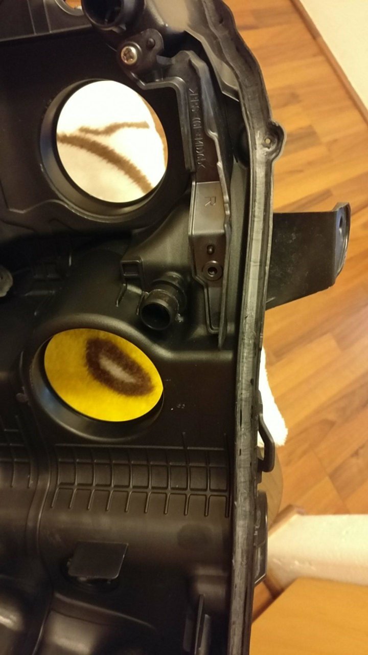

    It's much easier to remove the perma seal when it's heated till it's barely piable (kinda like rubber band ish). You can pull it out in a single strip received_1866380113372638.jpg
