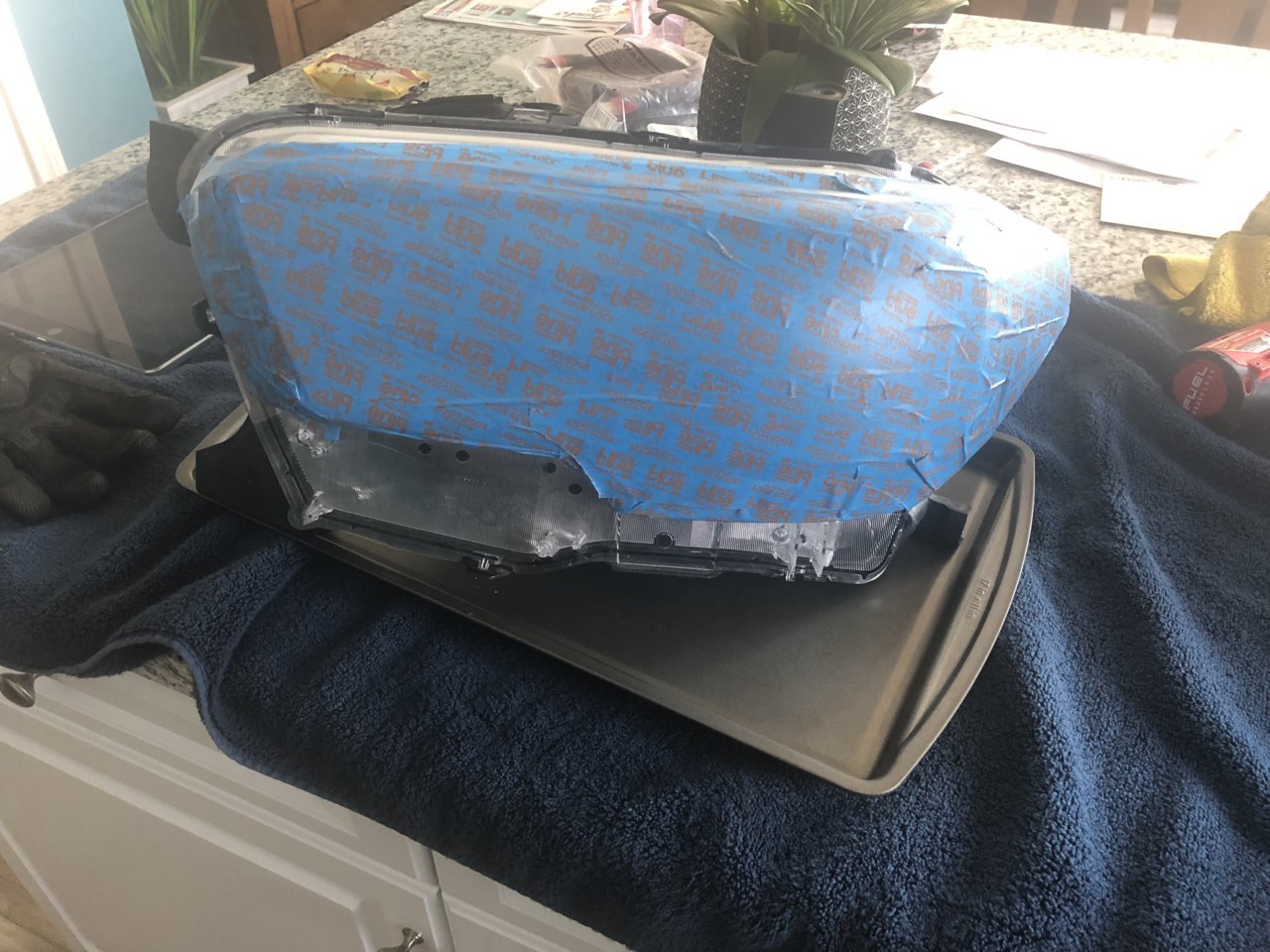

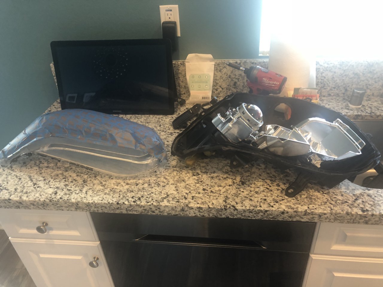

    Making this a slow project so I don't go insane. Ordered rx350 projectors, switchback halos and drl board. Took apart 1 headlight and removed glue from channel.
    Heated 300 for 11 minutes, ran flat head screwdriver around outer edge to loosen glue. Back in oven for 3 min. Started prying apart, mainly with screwdriver, used the reverse pliers mentioned in thread once lens started to separate some. Back in the oven for 4 minutes. Separated 90% of headlight, but stuck on stubborn bottom portion. Back in the oven for 3 minutes. Finally separated, not too bad overall, 2 broken clips (easy fix) but I did damage the edge of the housing by the side reflector. Think some plastic weld will do fine.
    As far as the glue removal...:jerkoff:. That took a while. Tried heat gun (glue just crumbled apart), tried dremel (felt like I was going to damage housing). In the end, @mesojdm suggestion of flat head and rolling glue out in strips worked best, but still time consuming.
    Will tackle other light next week and paint parts at the same time.

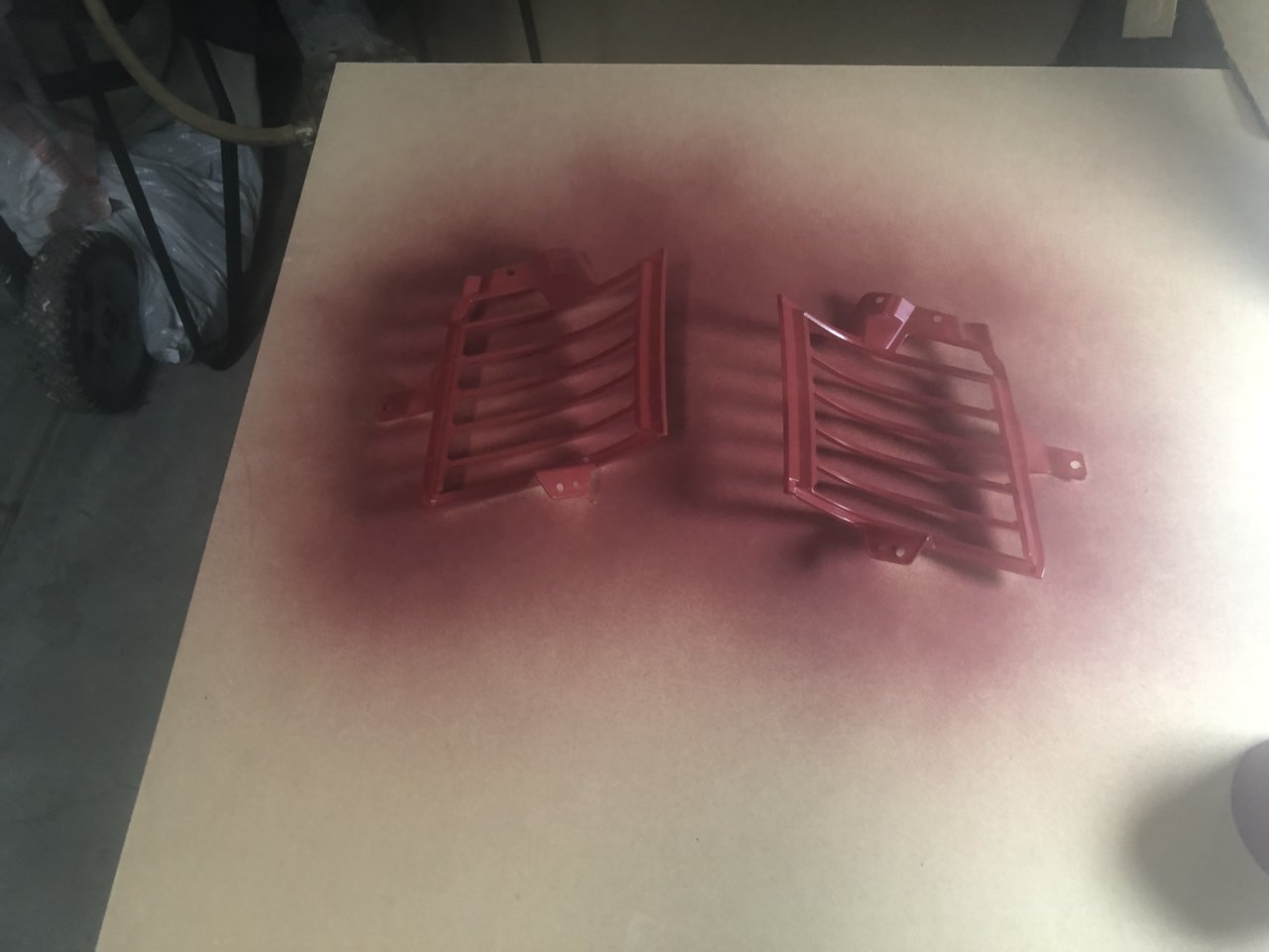

    Just ordered these parts for my light mod.

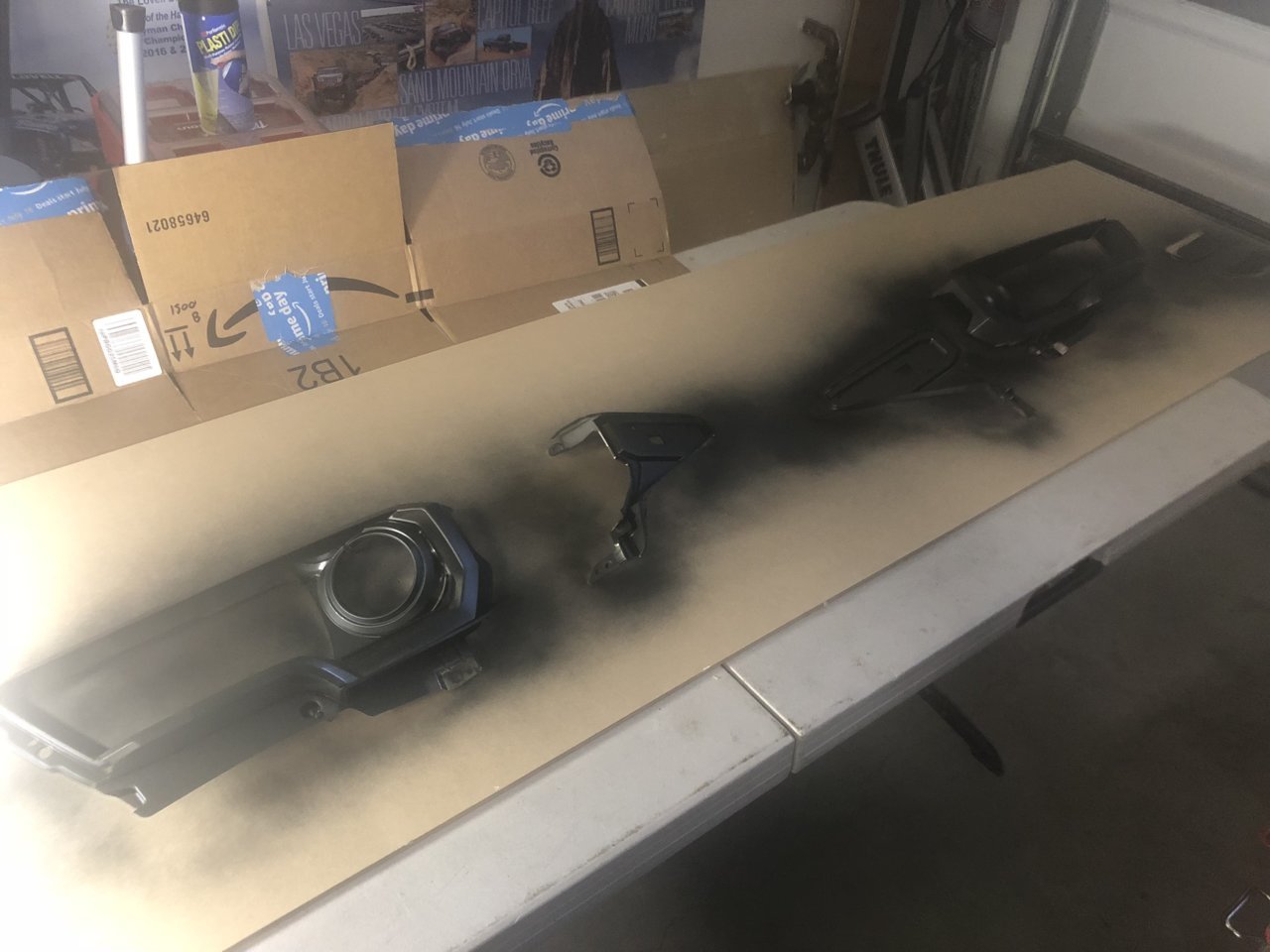

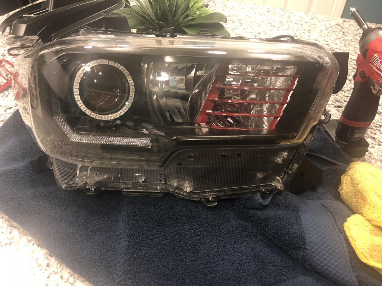

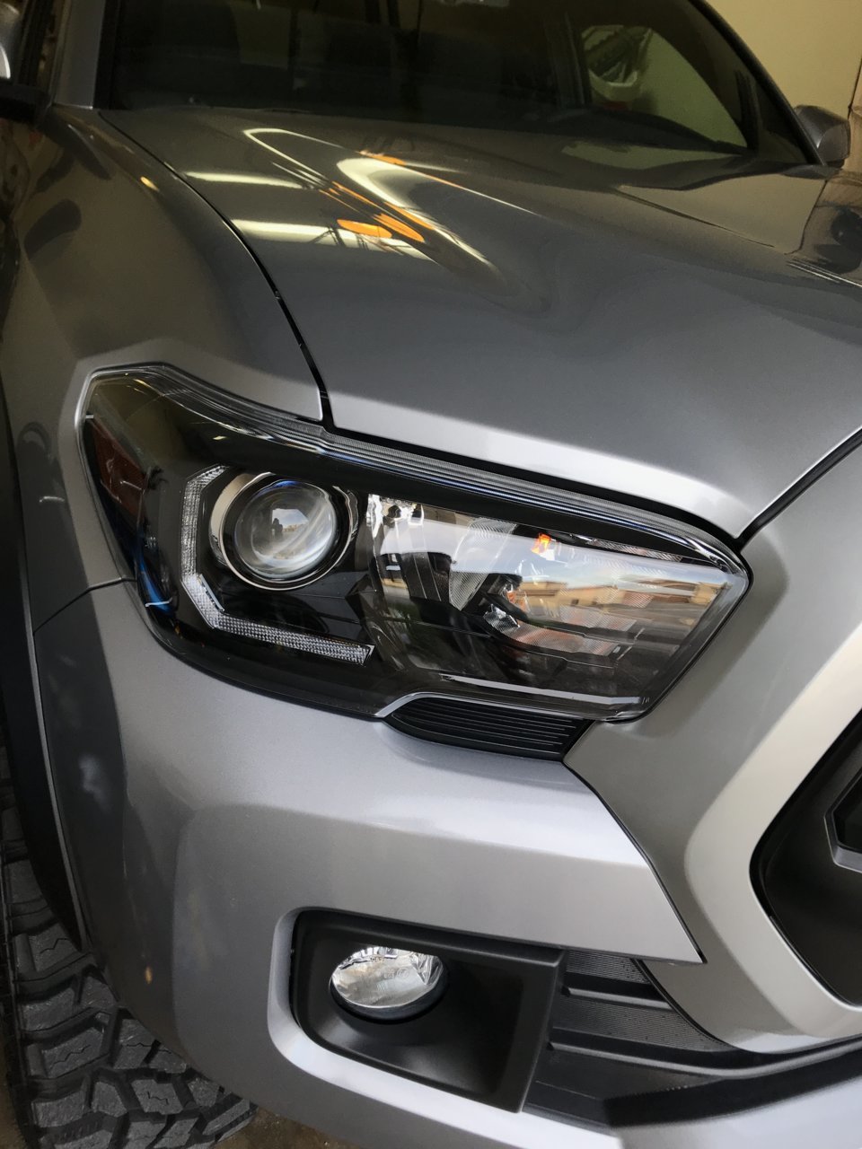

    Just finished my lights. I installed oracle halos and profile pixel rgb drl’s. I will post pictures once they are installed and wired upD7AF1034-00EF-4817-91AD-6DC5DEDE1D12.jpg2421CDF6-338C-4E45-9437-ABA1F4F21800.jpgB0FC4037-9C4F-41FA-B315-64874C694B7C.jpg76A81001-C261-467E-AD48-36D96823553C.jpgDFBF70A1-FE0C-4F03-86FE-A269F30C58B9.jpg0F02FD52-C7F2-4C4F-9A82-BA749760C1C9.jpg
