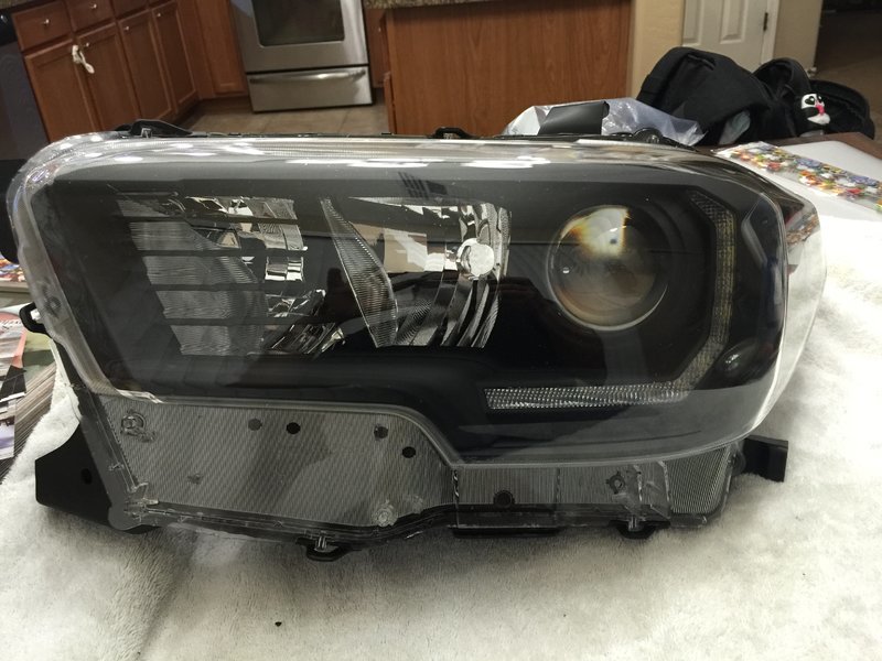

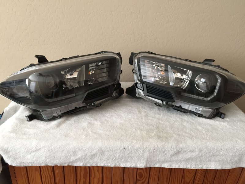

    1. I'd set aside a whole day, 2 if you're really worries. complexity of what you want to do can add time.
    2. Depends on what all you want to do. Minimum would be a Philips head screw driver, flat head screw driver, sockets for bumper removal and headlight removal, an oven, cutting board to put the lights on in the oven. That's about it tool wise. Again, complexity of your build wants adds tools.
    3. Krylon Flat Black (Matt Black) that says it will bond to plastic. Any place that sells rattle cans will have it 9/10 times.
    4. This depends on your imagination. Paint what ya want, just don't paint the glass of the projector (Obviously) or the inside of the high beam bucket....unless you don't want functional high beams.
    I've seen someone on here paint the fins. I kinda wish I had...but not enough to tear my headlights out and apart again.

    I painted the chrome around the high beams. It looks good but was a really bad idea considering my high beams no longer function. I have a light bar and cube lights on my bull bar but it is still a huge pain. Now I'm looking into replacing my driving light bulbs to something LED and far more bright to compensate. Any recommendations for a very bright bulb that has a white shade of light?

    Krylon Covermaxx matte or flat black works well on plastic chrome.

    Yup. Krylon cover max (fusion has been discontinued IIRC) I use matte for a stealth look. The pro's are glossy, probably semi-gloss

    DO NOT WIPE THE INSIDE OF LENS. Compressed air only. Latex gloves are a must..Remove lens, set it aside in clean environment.
    Scuff chrome with scotchbrite pad, clean with de-greaser and paint it.
    Clean out old sealant in headlight bucket channel as much as you can.. this will give the new retro rubber a good seal, and allow the lens to sit deep in channel like it came from the factory.
    Install new rubber, press lens on.. set in oven for 8min @ 240. take out and clamp it in($1 lowes spring clamps work perfect)
