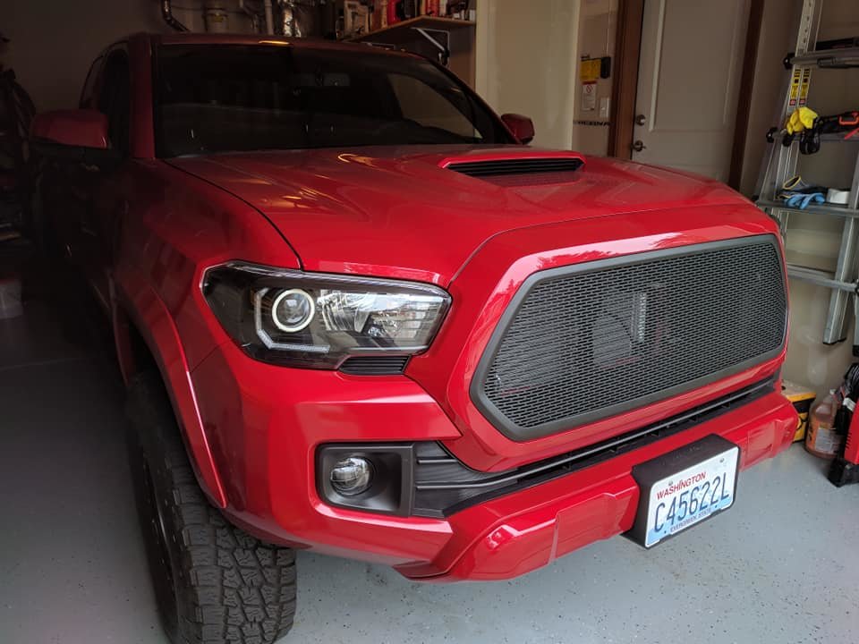

    I just wanted to say thank you for this thread in help with my mod, after browsing and researching, I was able to complete my headlight mod, with the Diode Dynamics DRL switchback board, and 80mm switchback halos! definitely a challenging project! I definitely needed more 24 gauge splicers in the end!

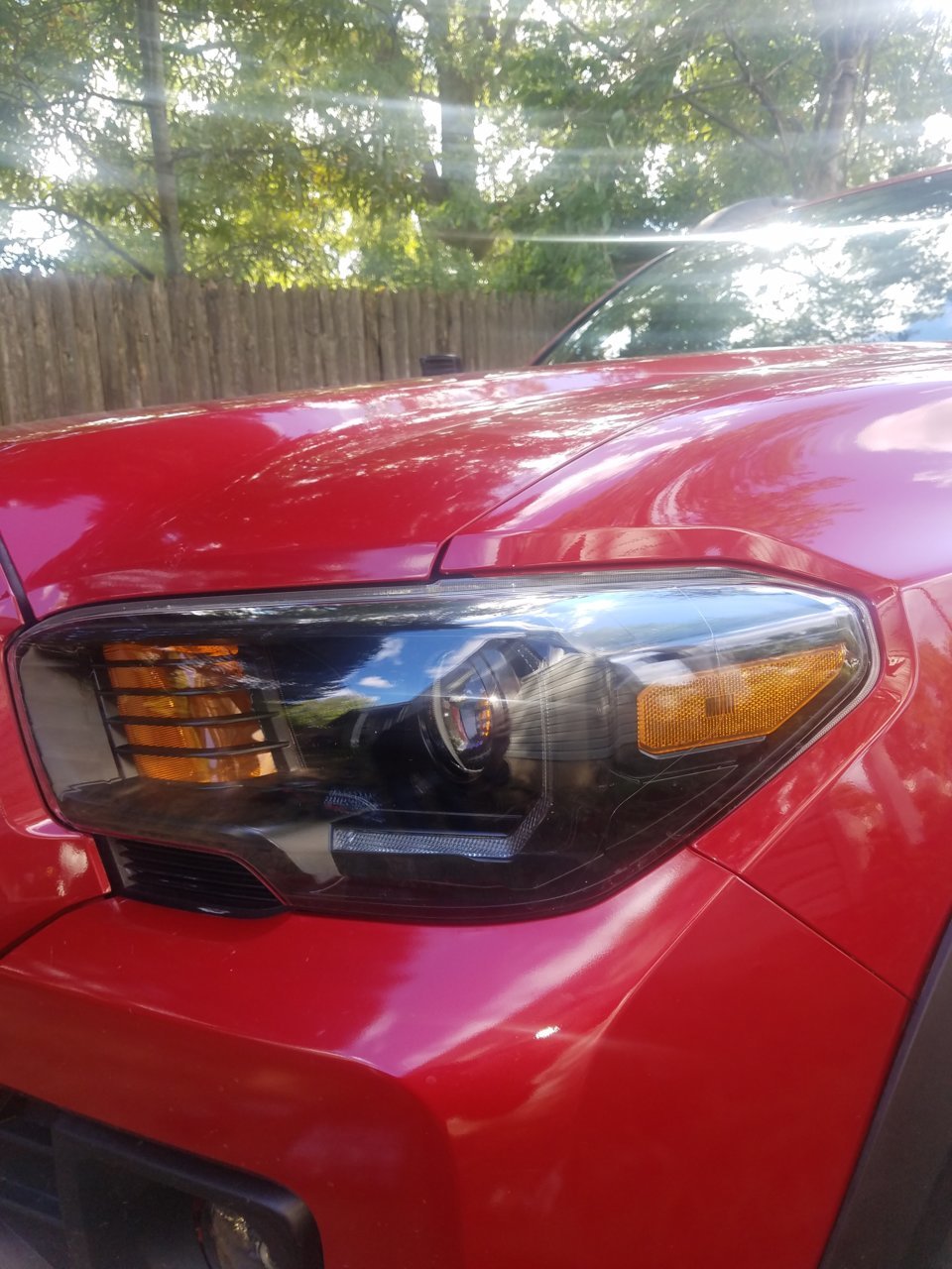

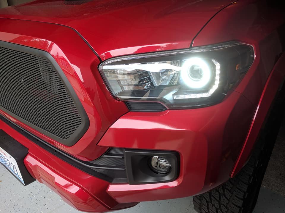

    Finished mine up today. Love the retro look of the unshaded amber.

    Those look awesome, did you put the acrylic Amber cover over the turn signal portion?

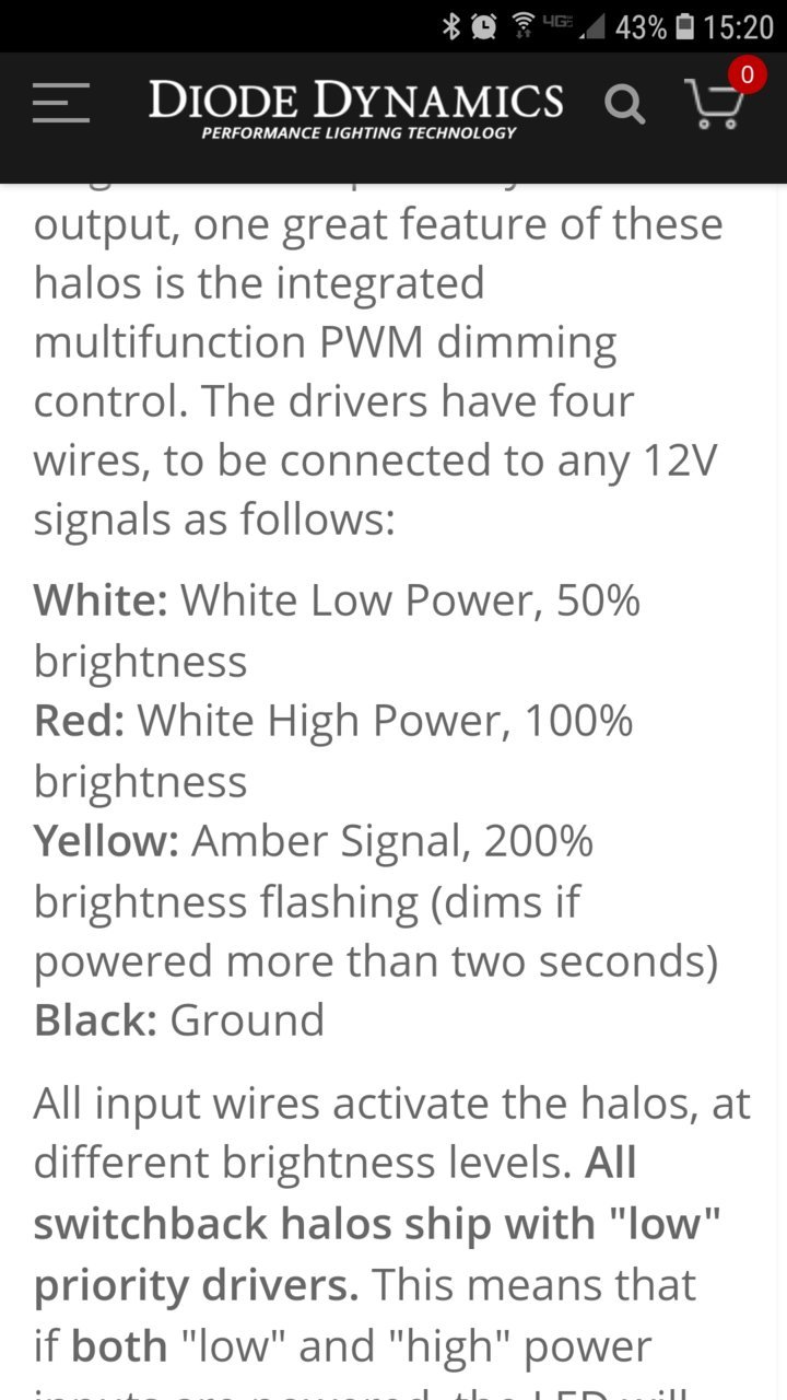

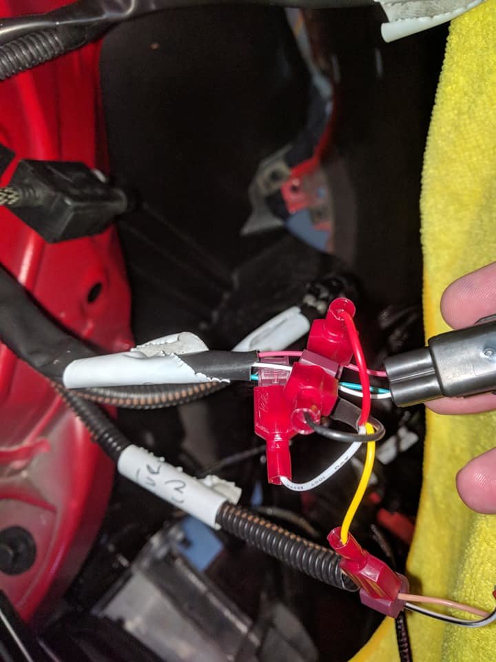

    Does anyone have a diagram of how to wire the switchbacck halos? I'm horrible with wiring lol

    Yup 1/8 inch acrylic amber. I used a piece of paper to map out the size and shape, the. Jb weld to hold it in place.

    So I'd have to look at my notes, you need three wires for the switchback halos I hooked up, white (hot) black (grnd) yellow (indicator) there is a control box you wire plug into the Halo connector, and you will need 22-24 gauge t splicer, so both right and left headlights have different color wires, but the easiest way would be to wire hot (white) to the outside Amber headlight lamp ground to any ground available, they are marked as white/black on the truck wiring. And yellow to the inner turn signal that should complete the switchback wiring. If your running a trd trim.

    Some have a 4th wire to run @50% when lights are on if you choose. Here is Diode dynamics wiring from their website.

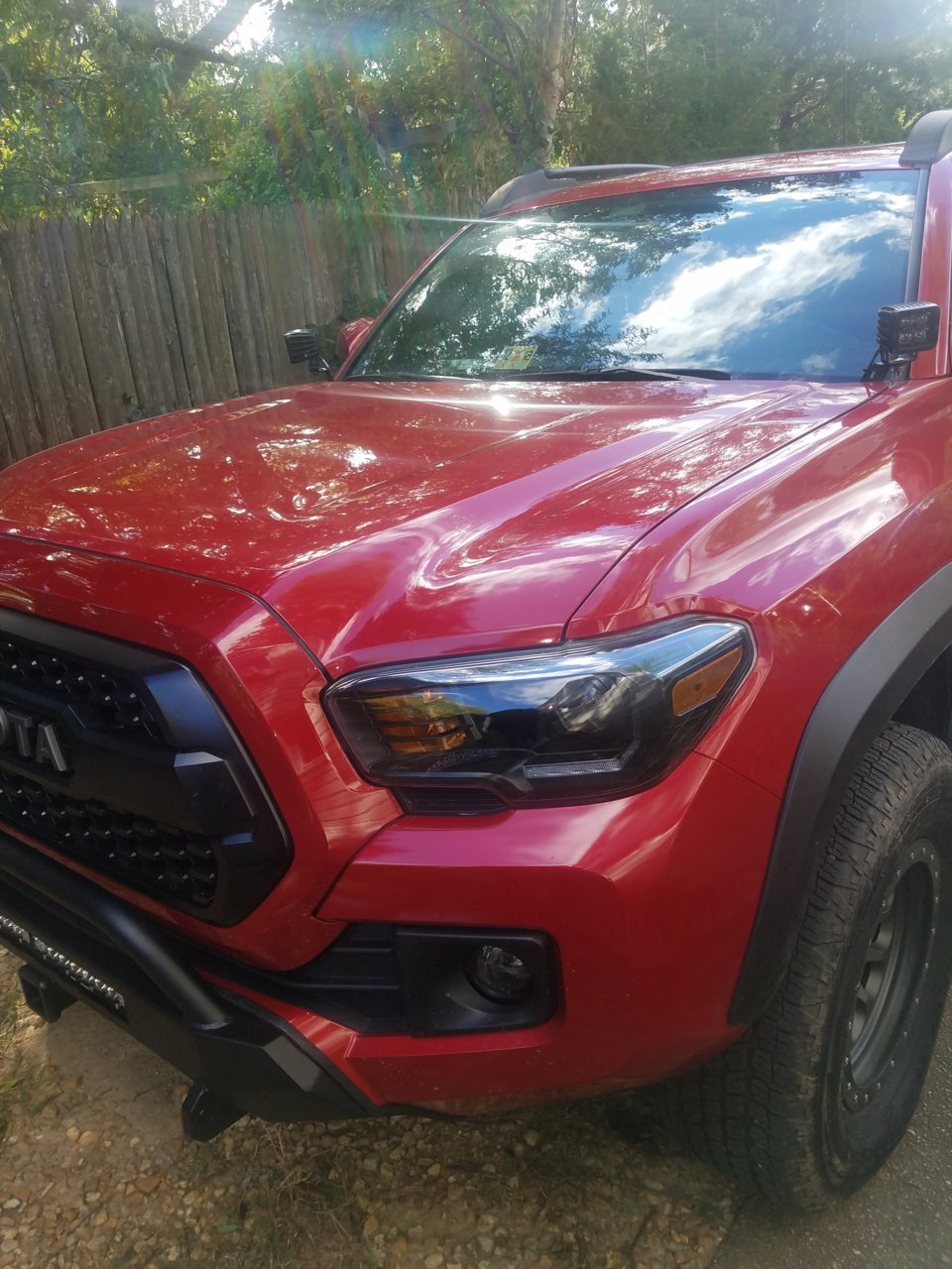

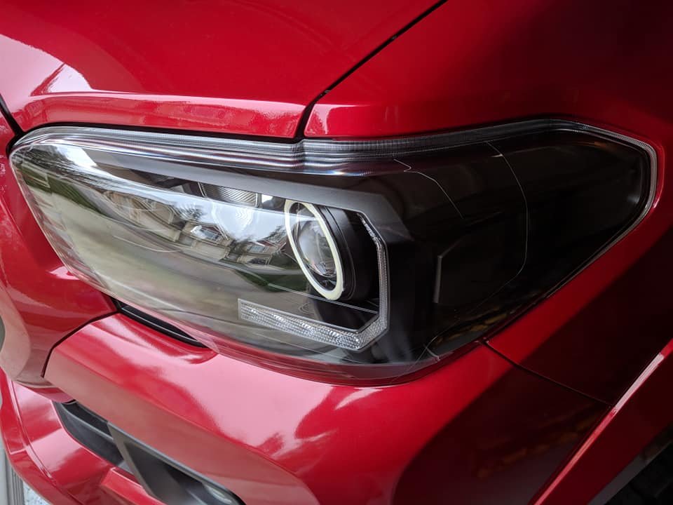

    Finished mine up today, kept the chrome ring around the projector and added an acrylic amber coverD2CC0F19-60C4-4D99-A7FA-65C7B655FEA1.jpg

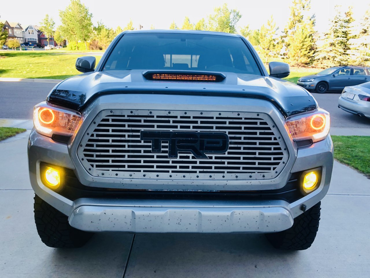

    Reverse the wires and rin orange all the the9DF788CB-49D1-4069-B4D1-87F5732BF340.jpg

    Where did you get the acrylic material?

    Bought some on Amazon and used a heat gun and dremel tool to shape it. I made one section so it would be able to be screwed in then used clear epoxy to keep it in place. Others have just used the epoxy with good results. But the acrylic sheet molds pretty good to the oem piece
