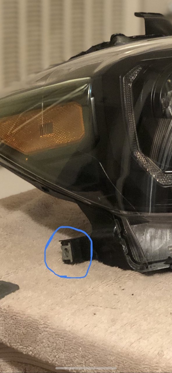

    Does anyone have a junk set of lights laying around with one of these metal clips? I need an extra. Thank you.

    I have a clip of the donor I got.

    Willing to part with it?

    Yup, I won’t be needing it. PM me where to mail it and I’ll send it your way.
