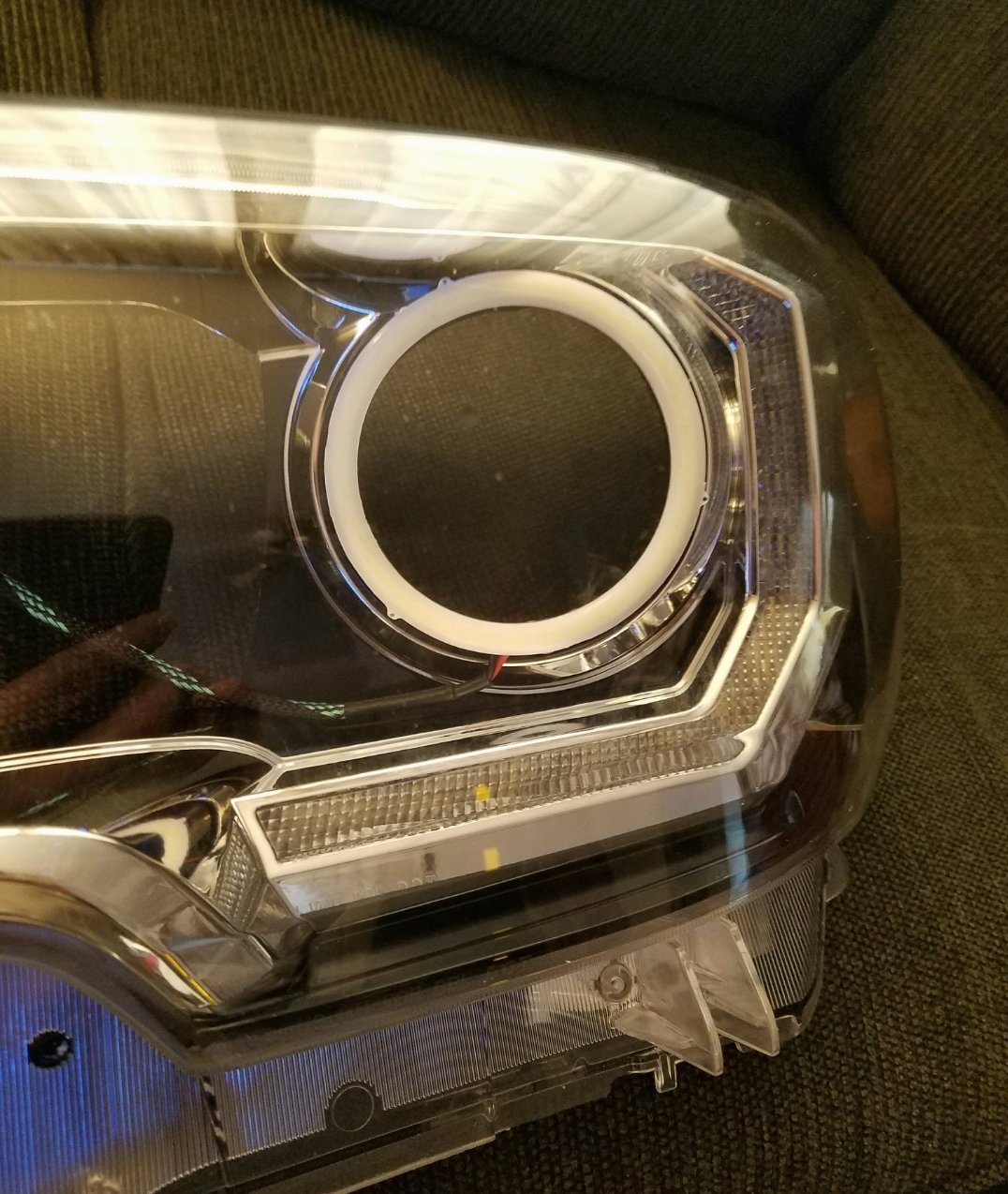

    What size halo are those running rx350s getting? I was told 90 and just wanted to double check. Specs say max height 95 max width 100
  17. Mar 11, 2019 at 5:11 PM
    #497
    20tacoma17
    20tacoma17 Well-Known Member
    Nov 8, 2016
    #201910
    7,079
    2017 DCLB Sport AT
    Kings, 275/70/17, a few custom items, lots of Meso mods.
    Need to remember it needs to match your OEM shroud. Mine hss 80's. Here is a pic but I just set the halo in place for this pic. You can go bigger but it wont center without cutting and hiding part of the halo on top.
  18. Mar 11, 2019 at 5:26 PM
    #498
    no vtec 4me
    no vtec 4me Well-Known Member
    Jan 29, 2017
    #209016
    1,595
    Kevin
    West Chester, Pa
    2017 Tacoma TRD Sport
    80 is perfect in our lights.
  19. Mar 11, 2019 at 6:07 PM
    #499
    baldbeardedtaco
    baldbeardedtaco Well-Known Member
    Sep 4, 2018
    #265223
    3,337
    FL
    18 TRD Sport DCSB MGM
    Ok that makes since- lightwerks said 90 when I asked, not sure why.
    I see you got profile halos, I’ll definitely look into these. The only thing that through me off was the fat white ring. Was originally set on dd but for no real reason. I do wish there was a different cover we could use for the drl board
