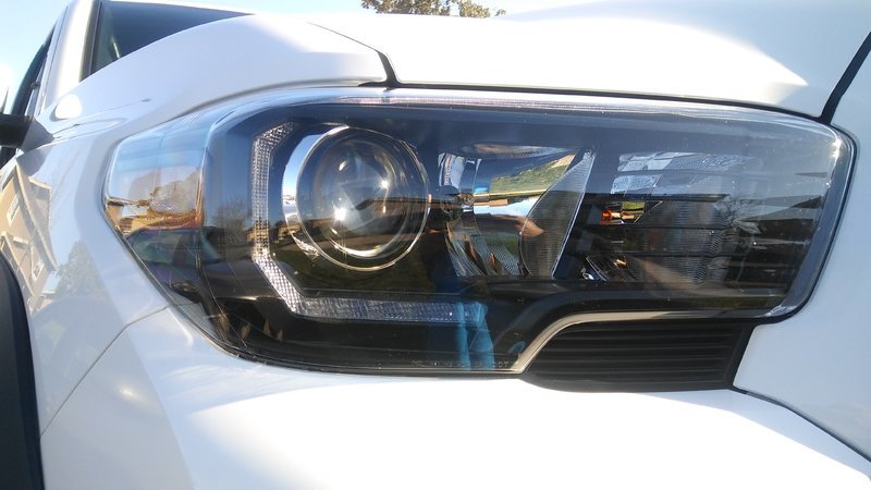

    Whewwwww just got done! A little dark to take any pix so i'll take some tomorrow. Getting the permaseal off was the hardest part!

  13. Feb 26, 2017 at 8:53 AM

    Legit. Didn't want to smoke the reflector?
    Look just like the PROS at 1/10th the cost!
    sig916 likes this.
  14. Feb 26, 2017 at 8:58 AM
    #54
    sig916
    sig916 Well-Known Member
    Nov 2, 2014
    #141536
    894
    Yup, just pros!
