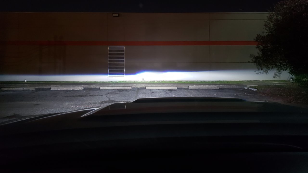

    Need more output pics in here. This is tuned rx350's with the sti-r lenses and osram CBI bulbs at 35w. Photo shows it a little more blue than it really is.

    Looks great. Even with all the newer, better projectors coming out I'm still very impressed with the tuned and clear lens RX350's output, cutoffs and its direct fit.

    Yeah they're tough to beat, great width and I love the slope and OEM quality/reliability. The direct bolt in makes em even cooler lol.

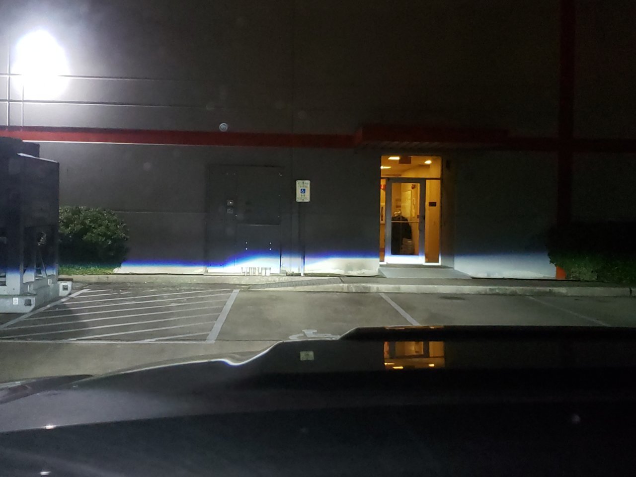

    Ohh I'll play. Finished work and bored on graveyard shift.
    Showing the width:
    That blue color band with the washer mod:

    What is a washer mod?

    You stick washers between the projector bowl and the lens to get more color. But too much, you'll end up with bad lighting performance and not a sharp cutoff.
