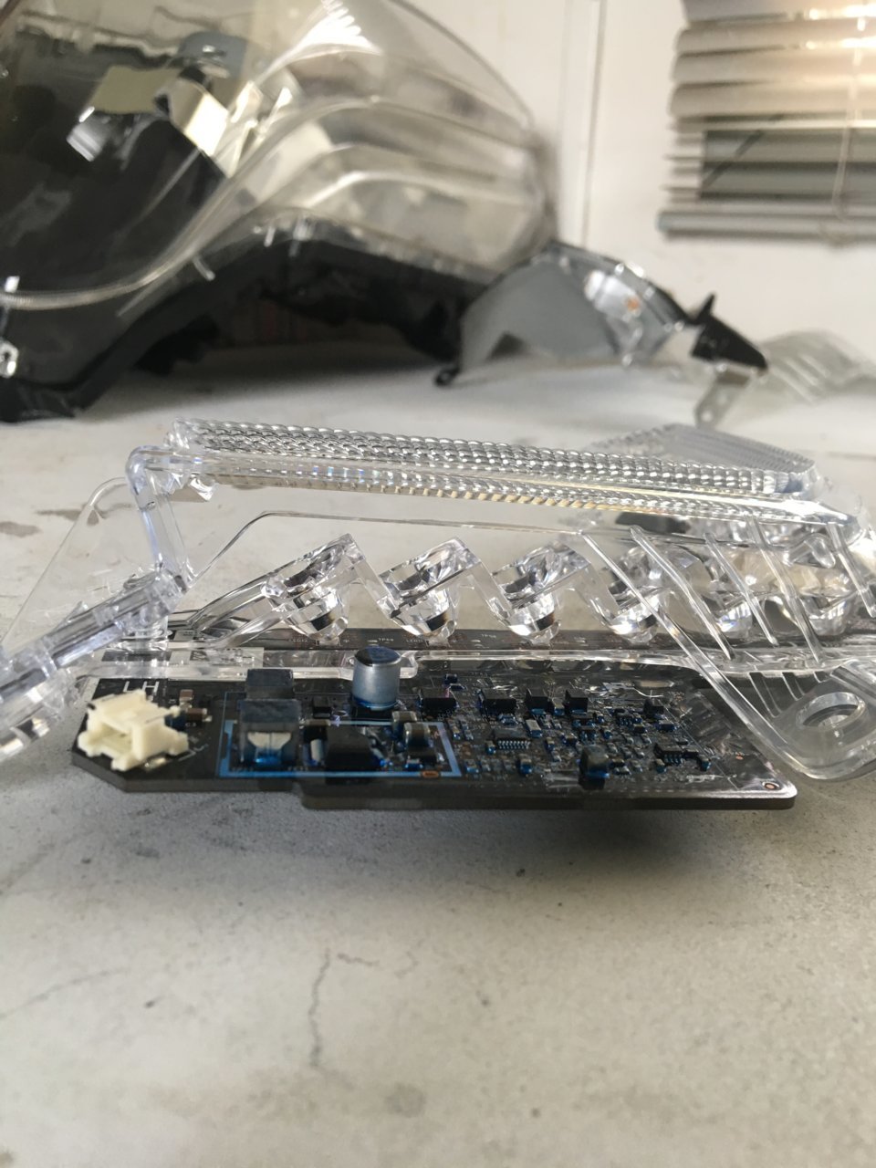

    396
    Jeremy
    New Brunswick, Canada
    2016 MGM Limited V6 4X4 DCLB
    I get what your saying, wondering if you painted the refractors (Not sure if that’s the proper term?) too. Basically did you just paint the upper piece in my picture or the middle piece too, there’s 3 pieces to that DRL.. the board, the refractors?, and the lens. You only painted the lens right?

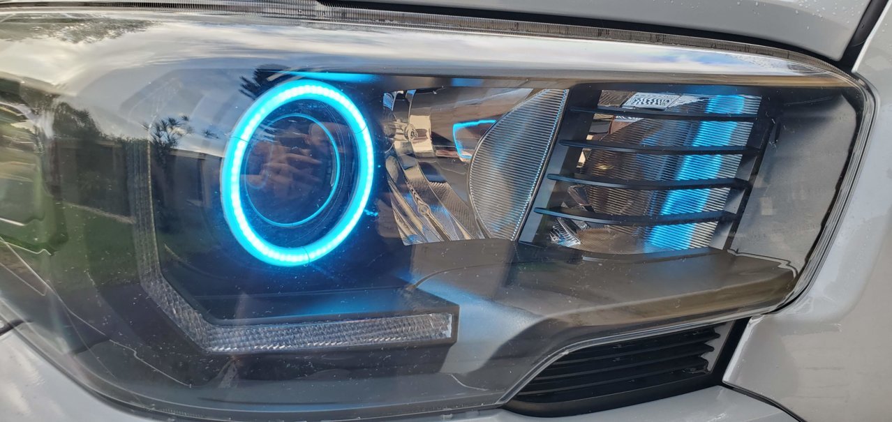

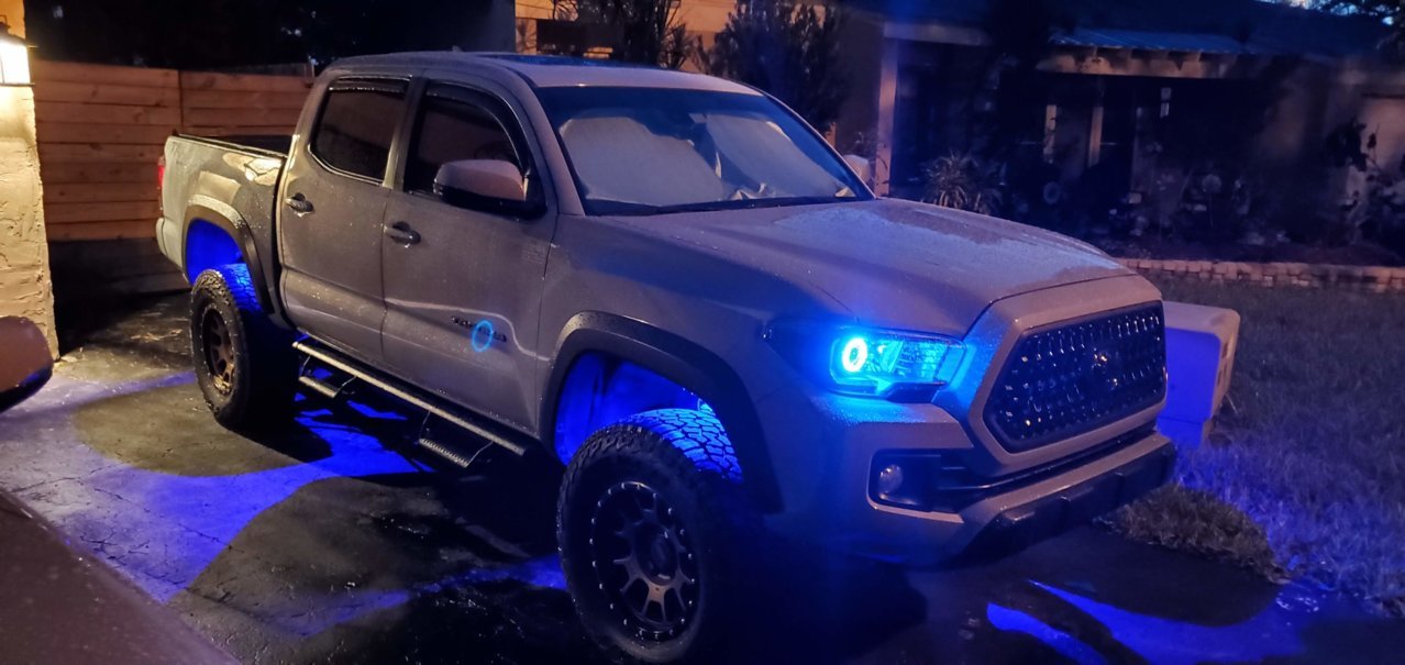

    Hey All, Getting ready for BHLM. So far, this is what i have for a shopping list:
    HALOS: PROFILE PRISM (RGB) 80mm w/XBT Controller
    Krylon Covermaxx Matte
    Night Shade for side markers only
    Clamps
    Retro Rubber
    Clip Pliers
    T Tap connectors
    (let me know if i am missing any parts)
    I know there are several cooking temps but i will try with OP's suggestion of 300 degrees for 10min. I noticed several pictures and read comments that some plastics on housing will melt a little. Will wrapping these mounts in tin foil prevent the melting?

    Kings, 275/70/17, a few custom items, lots of Meso mods.
    You can try a lower temp first. :notsure:
  17. Sep 26, 2019 at 12:20 PM
    #797
    Alesimo
    Alesimo Jeeper
    Sep 29, 2014
    #139352
    1,084
    Alec
    Houston, Texas
    2020 Jeep Wrangler JLUD
    I did 300 for ten minutes and no problems

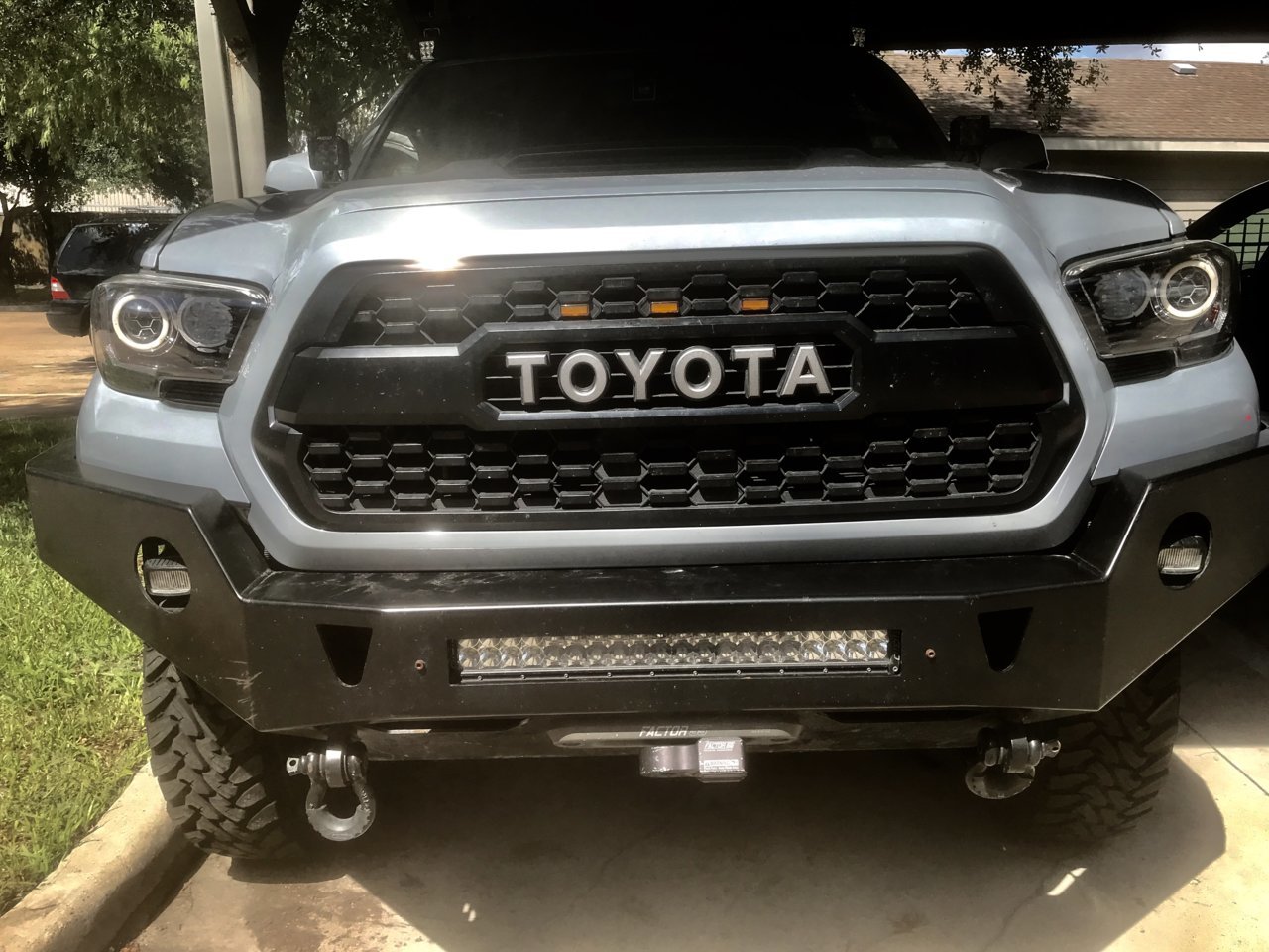

    Here's my finished product. It's far from perfect, but I did them. I just need to seal up behind the projector and the drl hole

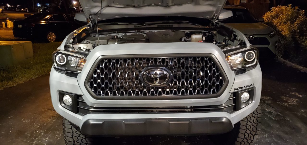

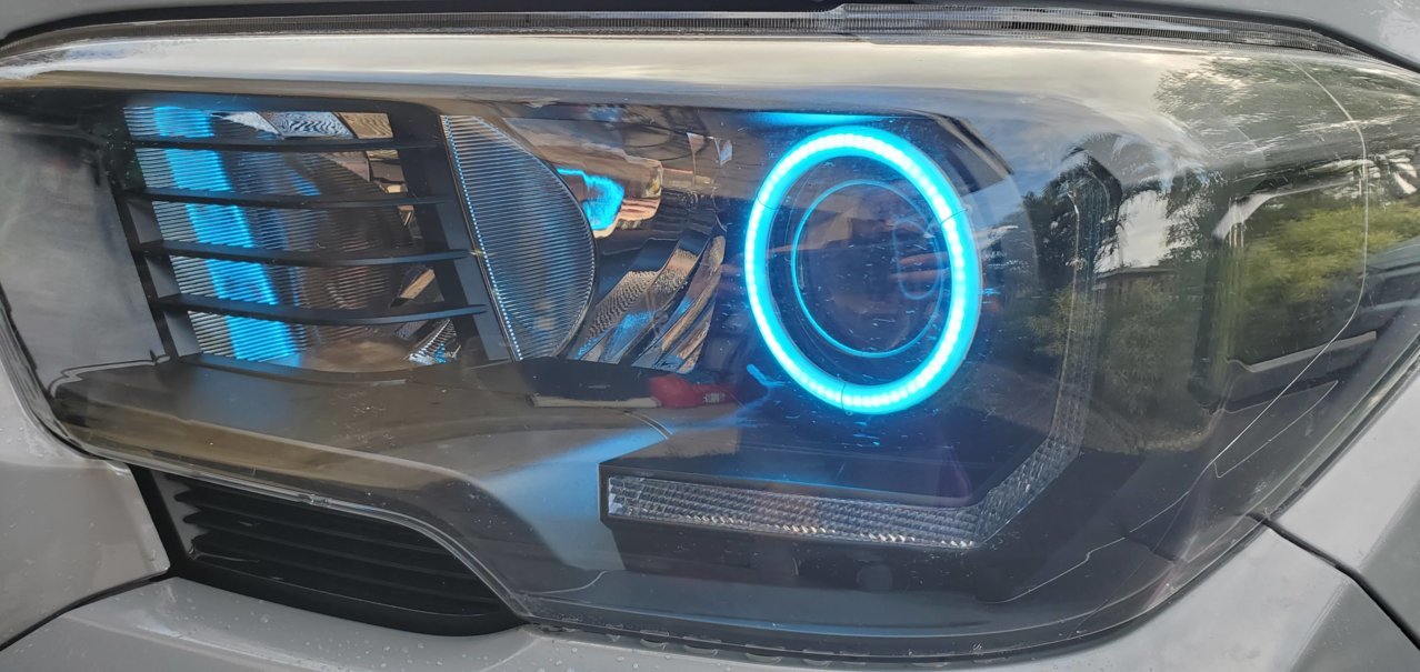

    Man, that was brutal. Had some bad things go wrong - broke tabs, burnt mark (stupid accident) and minor scratching. Here is the finished product. I love the way it came out.
