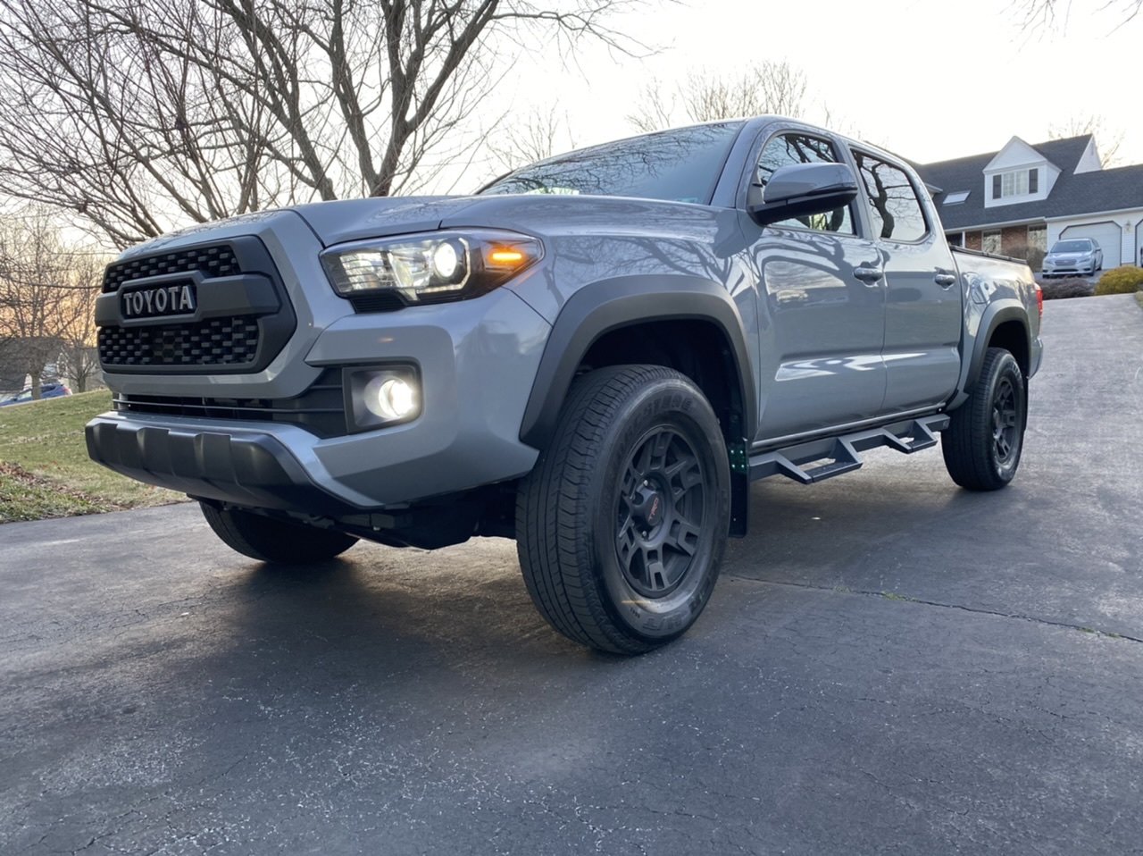

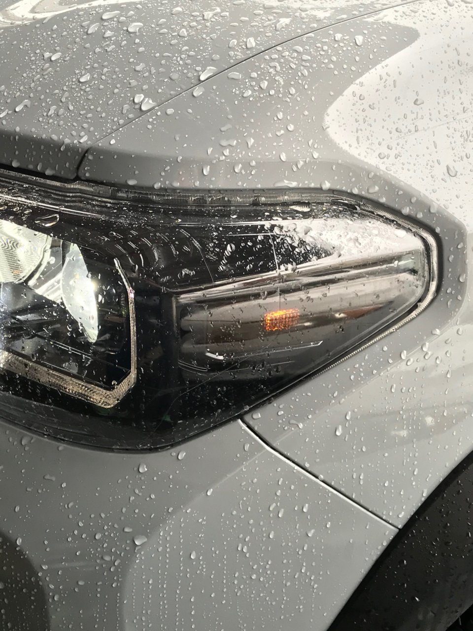

    Finally got everything installed. They look great, but man, what a pain. I can’t believe anyone is able to get this done in a weekend.
    My last hurdle is wiring up the Meso stage one side markers. I incorrectly assumed that they would be plug and play, like everything else that I’ve bought from him, but that doesn’t seem to be the case. Can anyone help me out?

    I know that I’m not adding much value to this thread since I didn’t do anything particularly unique with my headlights, but man what a difference they make! The Meso side markers are amazing.

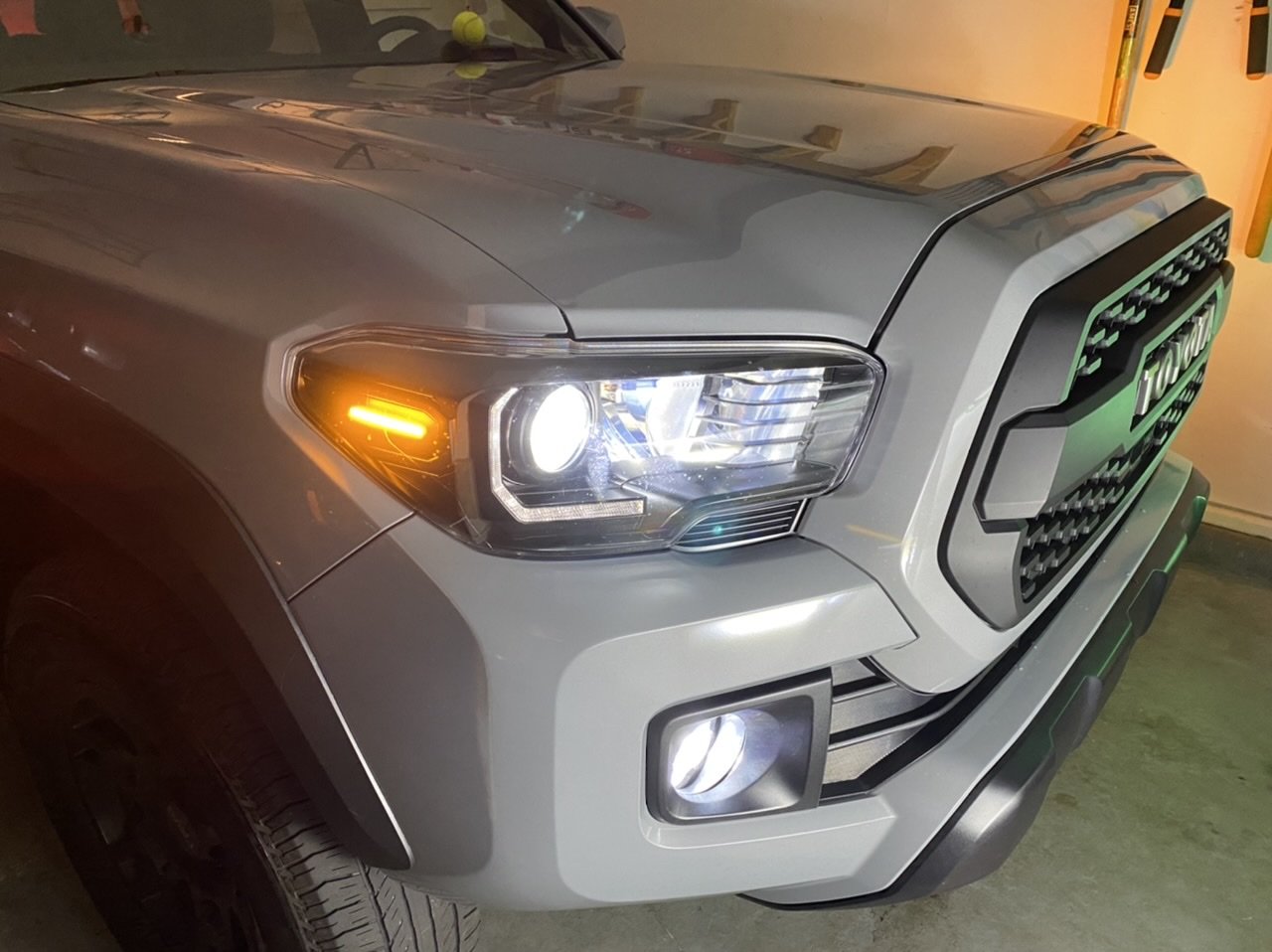

    I just gone done doing this myself. Pain in the ass but worth it.

    Did you add an amber insert for the turn signal or is that just an amber bulb?
  19. Mar 19, 2020 at 4:10 PM
    #879
    RX1cobra
    RX1cobra Well-Known Member
    May 20, 2019
    #293789
    2,190
    19 OR
    Just a reflection. I didn't do anything to the buckets and that's the stock bulb.

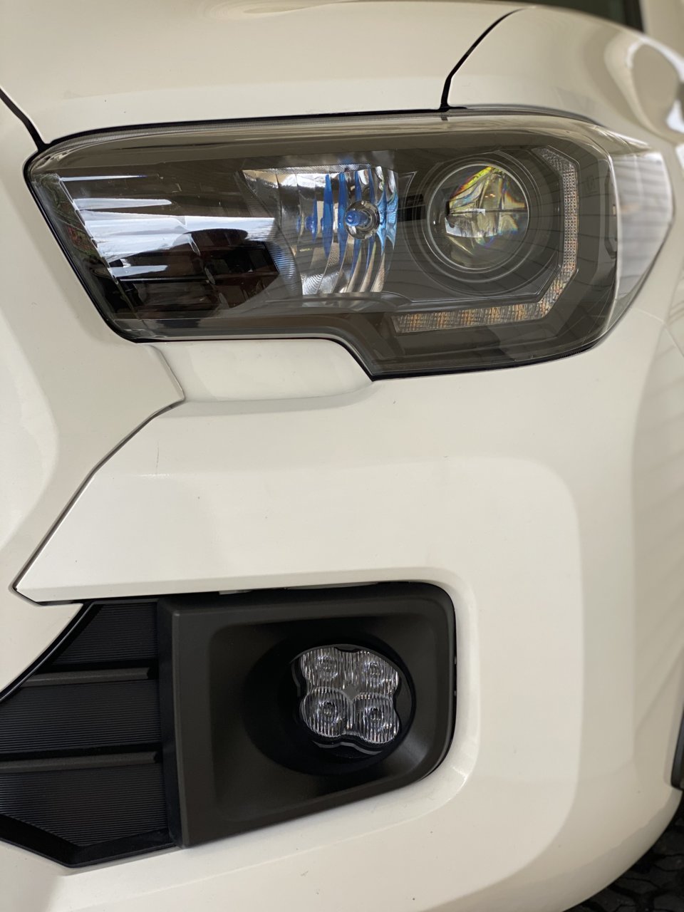

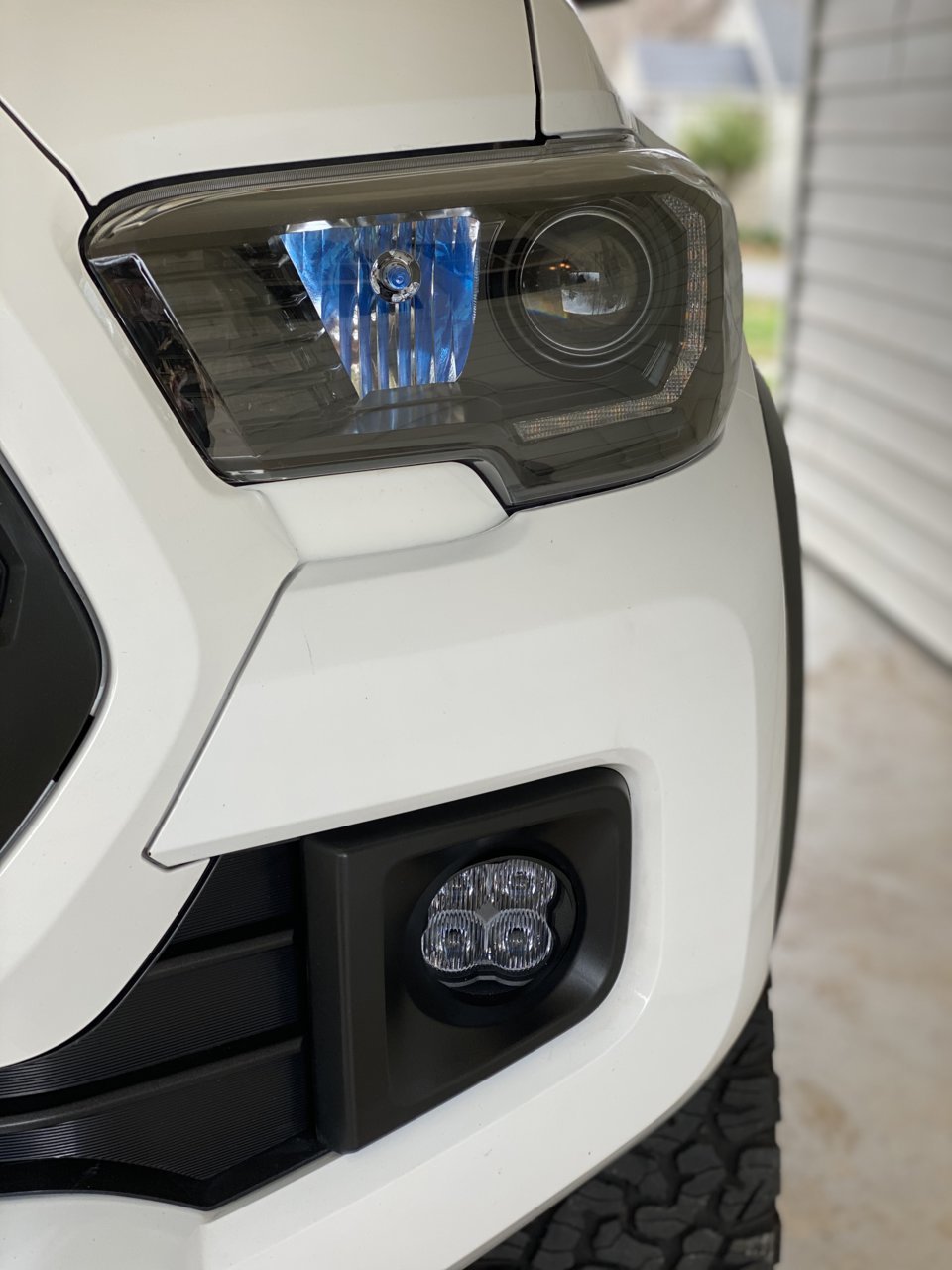

    J_Hacker Well-Known Member
    Sep 21, 2016
    #197896
    437
    Somewhere in Virginia
    '19 White Tundra Crewmax
    Bilstein 6112, CB +2 Shackles, Soft Topper, Method 316, 295’s
    Just finished mine the other day. Royal pain but damn it was worth it. Rx350 projectors with Osram CBI 5500k, Morimoto wiring, Meso stage 1 side marker, diode dynamics switchback drl, smoked turn signal covers, high beam splitter with Osram 75w 6000k h9 bulbs. And to top it off Diode dynamics ss3 sport sae fogs. I’ll post output when dark comes.
