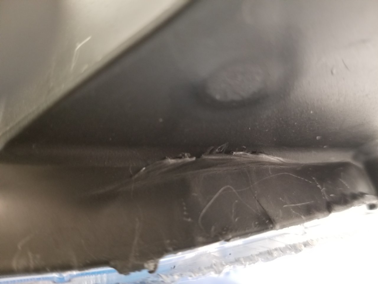

    Finally started on my retro today, but I punctured through the back housing with my flathead :(
    Will this be an issue with resealing? Should I just stop? lol I'm mildly going crazy

    Cant tell what's going on in pic.

    Sorry about that. Here's a pic pointing to the spot on my other headlight and the original for reference

    ^ you’ll be fine bud. You can try heating it up and molding it back into place and maybe melting the hole shut, but as long as you’re using a good sealant it’ll seal right up.

    Not gonna lie I was close to saying F it and sending them to him, but with that reassurance and the lens FINALLY separating, I'm content with taking a few weekends to work on it..but we'll see lol
