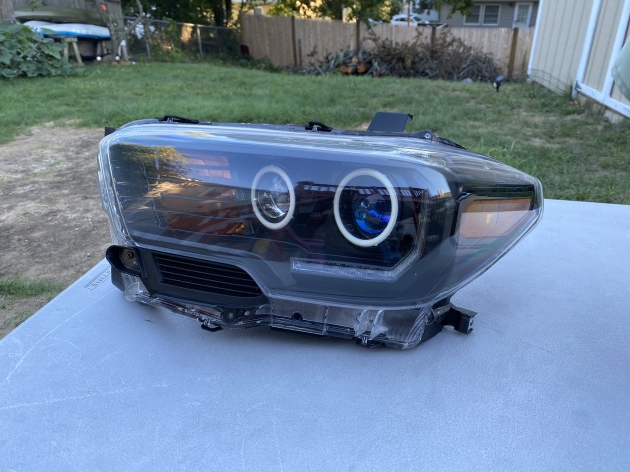

    This was my summer project that I slowly worked on in my spare time. I just need to figure out how to wire the halos, get the lights sealed up and I should be done! I went with a Morimoto DS2 + LED HB combo. (any advice on the halos is appreciated, I honestly haven’t looked into at all yet)
