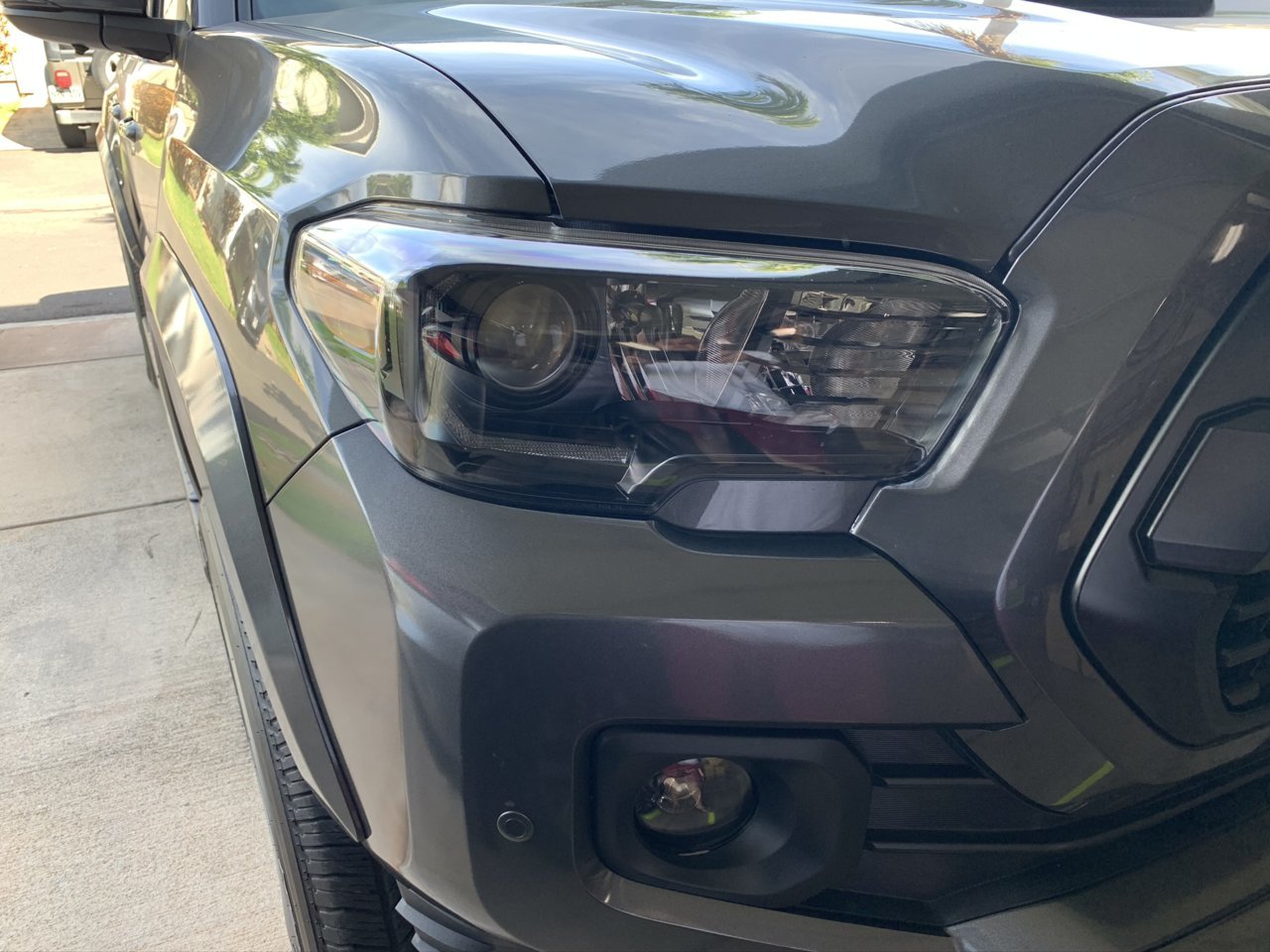

    I placed the retrorubber in the back channel without stretching it out so its the same diameter as it was rolled up in the box, Stuck the front lens to the back as much as I could, baked it for 5 min, then pushed it together, screwed in all the screws and held together with clamps until it set. Was really easy once it was warm after baking. Came out awesome. I am happy with the results. Here are some before and after pics.

    thanks for all the tips...they came out great!

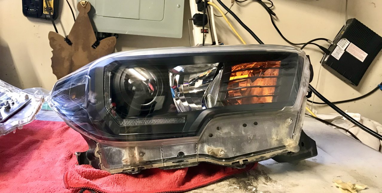

    While slugging away on my BHLM I did this only by opening the oven ha. So far one headlight sprayed, amber acrylic piece made, side marker smoked. Both headlights opened very easy. To anyone the key is bake and bake and bake ha. 10 min at 300 was good to start. Had a fancy panel clip remover but didn’t end up using it. Best tool is a flat head screwdriver. Will update when get further along.
