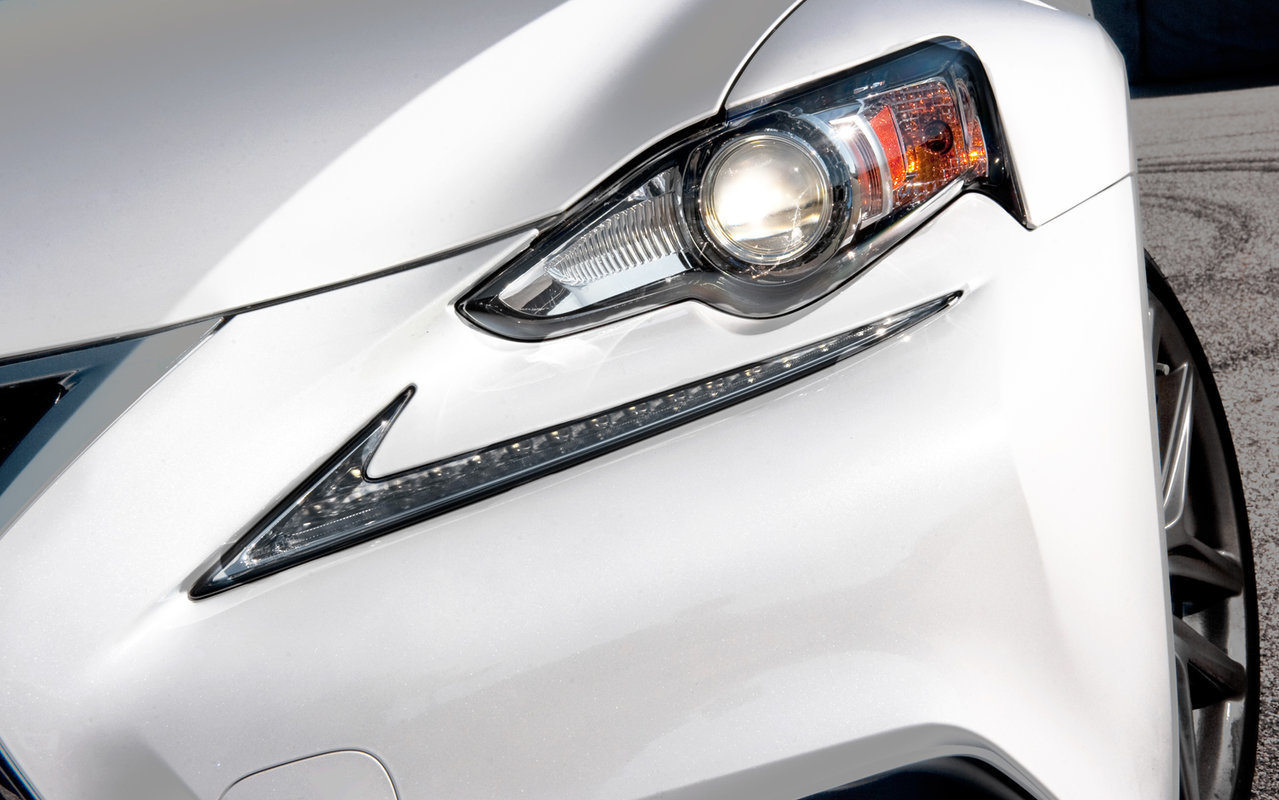

    What car is that?
    artesho and motorsport36[QUOTED] like this.
  19. Aug 4, 2017 at 6:19 AM
    #119
    Leo4x2
    Leo4x2 Well-Known Member
    Jun 29, 2016
    #190855
    1,418
    Leo
    San Antonio, Tx
    2016 Toyota Tacoma SR5
    Maxtrac/Bilstein suspension 16x8 Pro Comp 69 315/75/16 Dick Cepek Morimoto Profile Prism RGB Halos & Demon Eyes
    Lexus IS250 I believe
    LEXICON likes this.
  20. Aug 4, 2017 at 6:38 AM
    #120
    LEXICON
    LEXICON born where the prairies meet the rockies
    Dec 8, 2015
    #171728
    2,211
    Courtney
    Canada
    2016DCLBBLACKTACOMATRDSPORT4X4PREMIUM
    Nothing worthy
    LEXUS ISF SPORT
    Trying to transform our other ride a bit, not so much attention to the tacoma.
