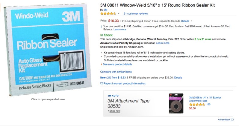

    question: I'm getting ready for BHLM and getting my ducks and products in a row.
    Little more clarification on 2 items.
    The Butyl tape and the blue tape you used to protect your lens.
    Obviously the blue tape is high heat resistant, what is it!?
    And as for Butyl tape, I found this on Amazon, i would like to use 3M because I know its a good product but is this right?
