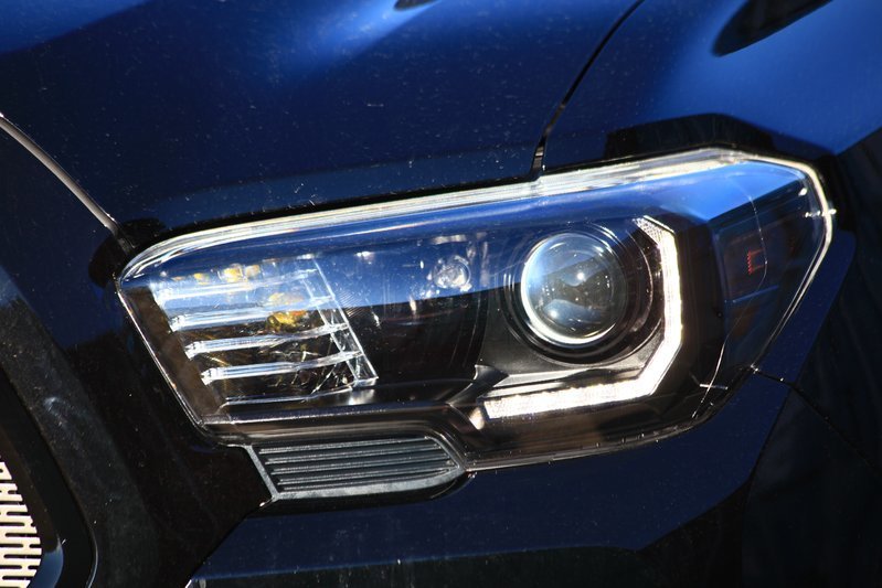

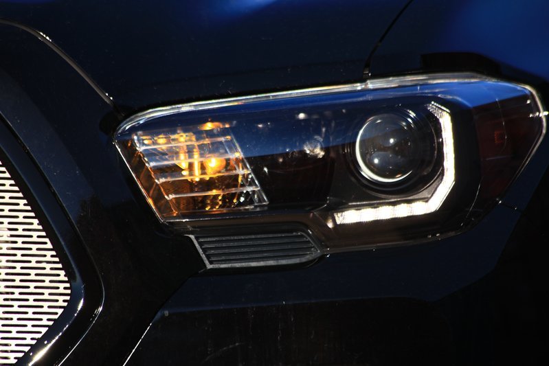

    Thanks for the info. Yeah, I'm leaning more towards doing my BHLM like yours.
    When you get a chance, if you would post the details about the yellow blinker bulbs I'd appreciate it.
    Also what bulbs are you running wit your fogs since they are yellow as well?
    Thanks
  4. May 17, 2017 at 12:24 PM
    #284
    Fresh6390
    Fresh6390 Well-Known Member
    Mar 24, 2017
    #214277
    411
    TN
    17' Super White Tacoma DCSB SR5
    Looks good to me! What brand tint did you use? And any prep work to the chrome before spraying?
    And from the looks of it you are the headlight guru, If I was to spray the blinker and high domes using your technique do you think the lights would be adequate or useless? Thanks
  5. May 17, 2017 at 12:58 PM
    #285
    LEXICON
    LEXICON born where the prairies meet the rockies
    Dec 8, 2015
    #171728
    2,207
    Courtney
    Canada
    2016DCLBBLACKTACOMATRDSPORT4X4PREMIUM
    Nothing worthy
    No problem.
    Keep the ribbed lens in front of the signal clear so it collects light from the flashing bulb. Looks awesome with all the black in the housing too.
    Stock fog bulbs with Laminex film for color.
  6. May 17, 2017 at 1:58 PM
    #286
    MESO
    MESO [OP] Major Modder Vendor
    Feb 16, 2015
    #148809
    16,292
    State of Jefferson
    2016 DCLB TRD HELLCAT SWAP
    No prep, just make sure its clean. The chrome scratches very easy, so don't wipe it too much. I just used rustoleum lens tint from autoparts store. I'd like to try the "nightshades" brand but couldn't find any locally....and I'm an impatient bastard. I'm far from a guru, I would just classify myself as a Light Nerd.
    "..do you think the lights would be adequate or useless" for you..they would probably be fine. For me, NO. I am a stickler for light output, intensity, and coverage. Put it this way: take a stock chrome bucket and "tint it", Now you have worse output than the factory..OK well then add a upgraded LED bulb. Now you are MAYBE back to stock levels(probably less because it doesn't have the same reflection as before). No doubt @LEXICON's look stealth as hell. It's a FORM--FUNCTION battle. You can't have both, Or can you....:spy:
