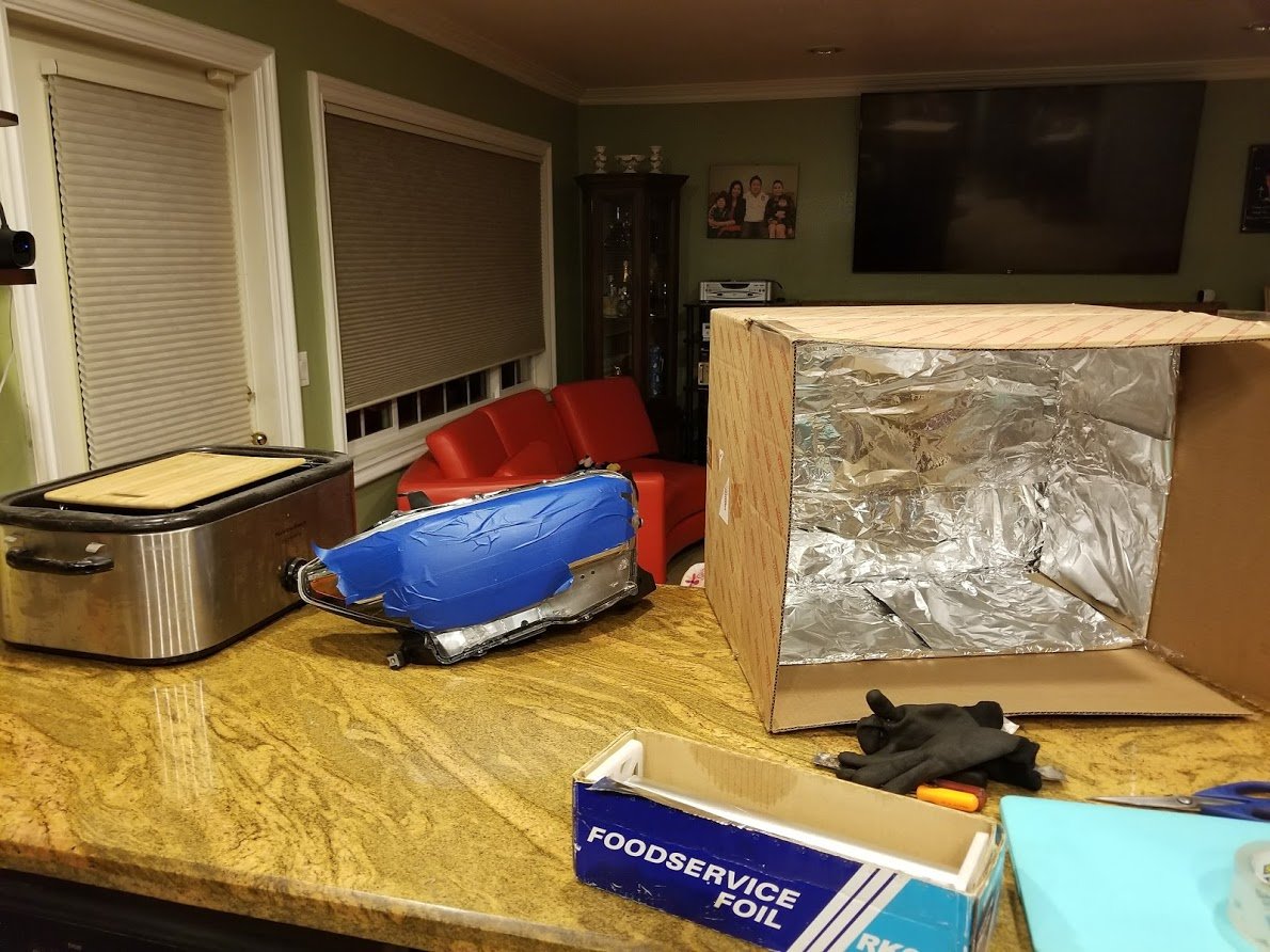

    I don't have an oven in my house (long story) and tried a heat gun. Well that was a fail. I'm going to have to squat in somebody's house and use their oven. lol

    Just microwave it..like a hot pocket!!
    Heat gun will not work. You need to warm up the entire housing CONSISTENTLY in order to pry it apart. Heating 1 spot and pulling will only result in a warped bucket.
    Craigslist a used oven ~$50 is your best bet.

    well crap. I made my diy oven which heats up pretty good with heat but that damn sealant is so much of a pita. I'm really messing up that black housing. I spent a few hours at it and still no go. I'll give it another shot tonight.
    At least it's where you can't see the damage. lol

    Ya..not sure how well the Dutch oven is gonna work lol

    it got plenty hot like i had to wear gloves though. i do have sensitive hands though.

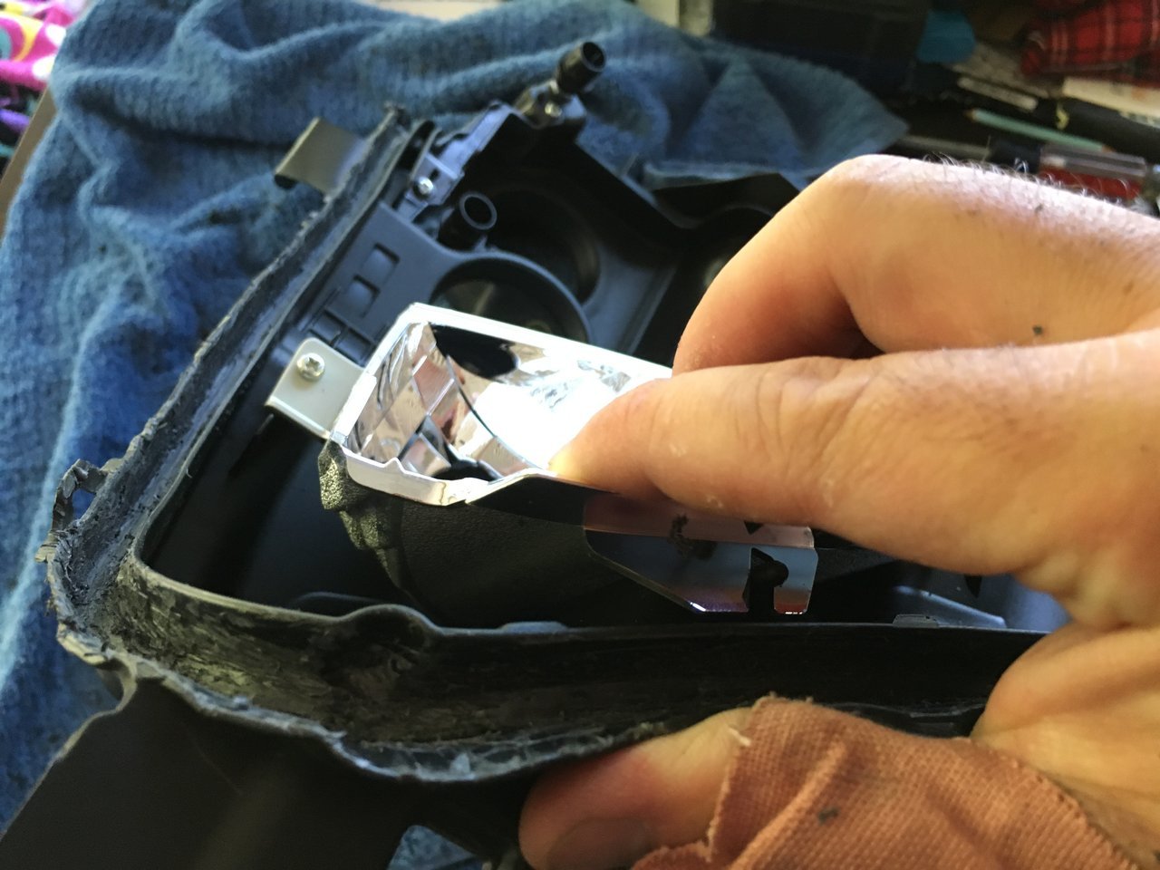

    Need some honest opinions here. Should the back of the house look rough AF. I don't think I have the proper patience for this.
    I tried using a utility knife and I cut through the back of the tray a few times, stabed myself multiple times, and sliced open the top of my thumb.
    How much of the perma seal do we have to removeo_O
    I think I'm calling it...
    Stoked4 likes this.

    Put the back of the housing back in the oven
    It comes out easier when it's warm
