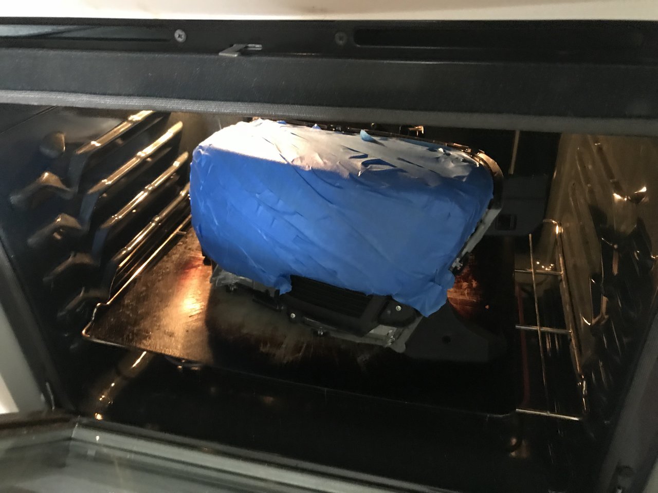

    Is there a way to remove the LED strip before baking the lights in the oven, or is everyone just baking the led strip until the lens comes off?

    No way to remove prior to baking. They will be fine.

    The heat doesn’t hurt them

    I did 290 at 15mins and then 10mins on the reheats. I cracked some of the plastic in one of the corners though. Going to just use some rtv sealant at the end and hopefully it will hold. Waiting on retro rubber to come in and will get the other headlight done next week.

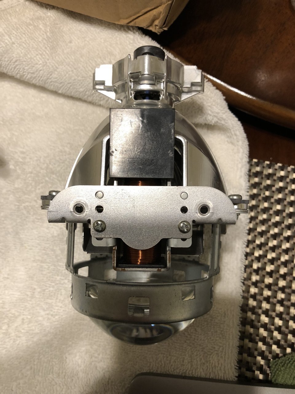

    Hi, can someone please let me know if I received the correct projectors TRFS ? I ordered the RX350 NON AFS and they don’t don’t fit properly.

    What about it is not fitting
    Can you take some more pics?

    That metal part is too big and it doesn’t allow the screws on the base to go in

    Is that the original metal piece from the old projector?
    Oh and make sure you run the high beam wire before you put the lights back in the oven
    I made that mistake

    Thanks for the advice, I received the projector like this form TRFS and I am thinking that there was a mistake and I was sent the AFS instead of the NON

    Can you remove the bracket?
    What does it do?
    I have the same setup and didn’t run into this problem
    Maybe the projectors are afs like you said

    No it can't remove, it's part of the frame, I contacted TRFS and they tell me I have to cut the metal frame that I indicated in the image but I haven’t seen a post that mentions cutting the projector, can someone tell me if they had to do that?

    I didn’t have to cut anything metal
    Just part of the plastic housing

    Mine bolted in. It looks like they put a AFS to Non-AFS Adapter on there. Mine didn't have a black plastic piece on the back of the housing like yours does.

    I think the black plastic piece is for the high beams
