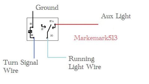

  16. Mar 6, 2018 at 6:47 PM
    #536
    chuymoreno
    chuymoreno Well-Known Member
    Nov 22, 2016
    #203101
    432
    El Paso, Texas
    Tacoma SR5
    @mesojdm
    Sensei i have a question
    I want to run amber lights (halos) all the time but that they also flash when the turn signal is on do you think wiring a 5 pin relay would work ?
  17. Mar 6, 2018 at 8:41 PM
    #537
    MESO
    MESO [OP] Major Modder Vendor
    Feb 16, 2015
    #148809
    16,294
    State of Jefferson
    2016 DCLB TRD HELLCAT SWAP
    Yes. I'm doing that for my illuminated side reflectors. You don't need a huge 30a relay, a small mini relay will be fine for a halo.
    chuymoreno[QUOTED] likes this.
