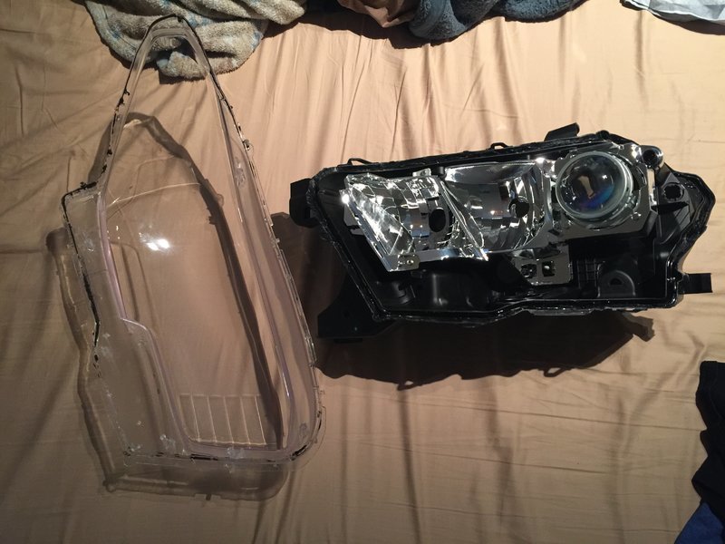

  2. Aug 7, 2016 at 10:25 AM
    #42
    msommer1420

    Here we go

    ^Hell ya! Crack em' open. What temp/how long did you bake them?

    Started same as you. Didn't budge. 10 more at 260 didn't budge. 10 more and a little more prying than I liked but it worked. What side did you pry on? There are guys talking about not prying at all and just pulling them apart. I can't even comprehend how that's possible after going through it. Paint and reassemble this week.
