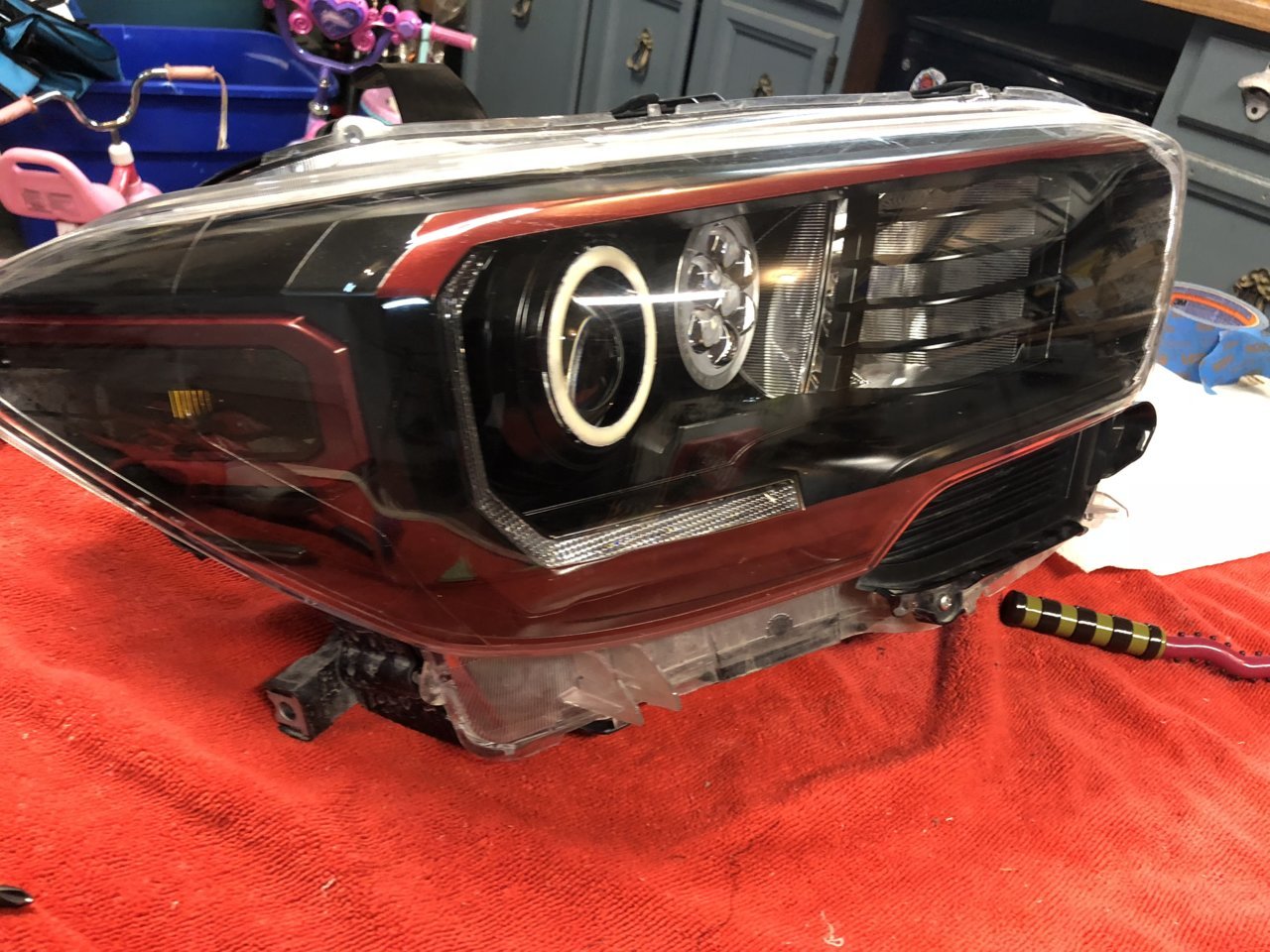

    Well I done it the seal splitter helps a lot B3CECCC0-CD1C-464C-AB1E-61DA2A1820D9.jpg 7A551D82-0F13-44FA-9BF6-6A78BC051E16.jpg06D00B72-2E43-4E21-AFD4-CF297295B6D0.jpg2E828E7B-2E51-4964-A7F9-F8C9DB2089A2.jpg0B575636-63D4-4F8A-B022-9288FABD44B3.jpg
