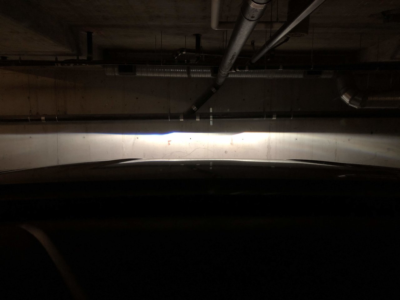

    Hey guys, I did the retrofit this past weekend and it looks amazing!! I put in the RX350 projector with the clear lens and it's so crisp. I'm finding that the angle and horizontal alignments are slightly off. Any tips on adjusting them? I might open them back up this weekend and play around with the mounting of the projector.

    Nice work. It's hard to tell with that pic. The pipe on the wall is a sewer line so it's going down on the left. Might be giving the illusion that the light is going up.
    Are those tunes lenses and how much if any trimming did you have to fit the projector?

    I did get them tuned. Yeah, that picture isn't the best. I was doing some quick measurements and the alignments are only slightly off so it would be hard to see. I'll try and get better pictures this weekend with measurements/tape.
    I just trimmed some of the housing to fit the solenoid. Similar to what meso did in his first post.

    Yeah. Make sure the cutoff looks like like this
    ____________
    Lol but really a skwed cutoff really grinds my gears. I am so OCD it’s the first thing I notice when I fire them up. When swapping projectors that use a bolt pattern, I always get all 4 bolts loose and then try and get the projector centered between all 4 mount screws. Even though they are direct swap, I’ve noticed there is a little wiggle tolerance in the mounting. Other smaller things can add to it like taco lean, and even all the headlight mounting tabs(go through and loosen them all and you might be able to squeeze a little more alignment out of the projectors)

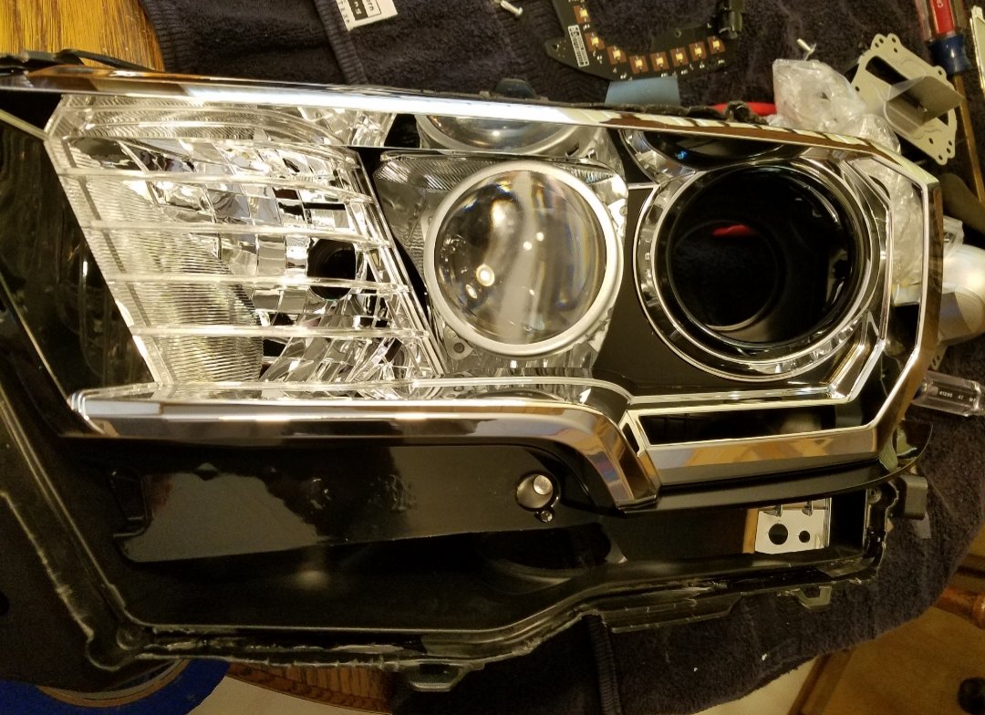

    Holy crap my fingers are sore. That permaseal sucks.
