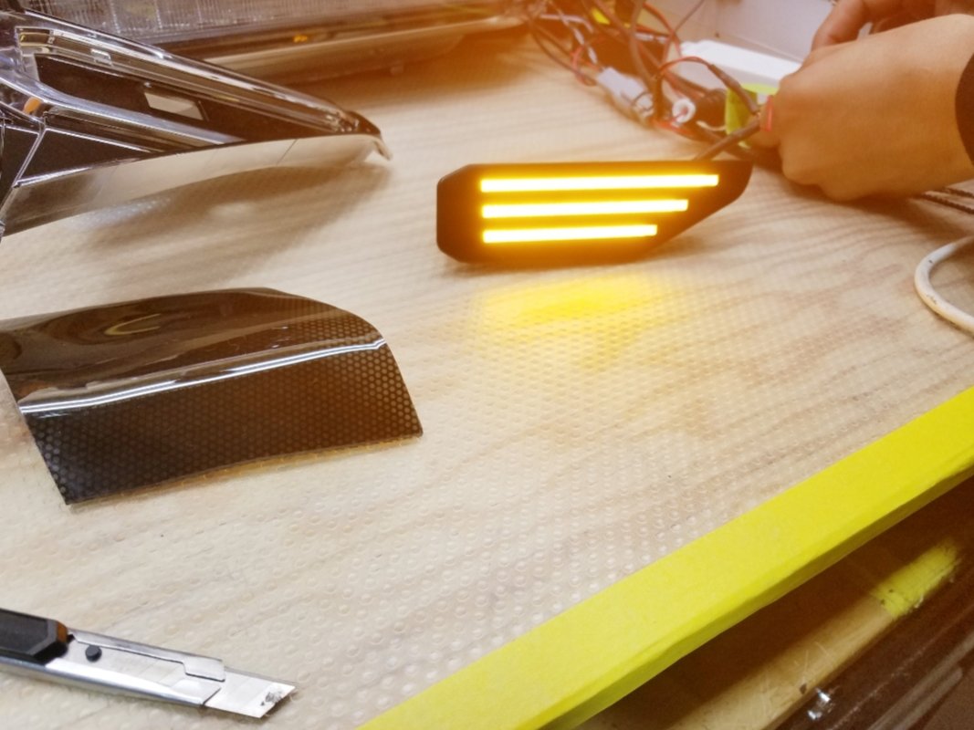

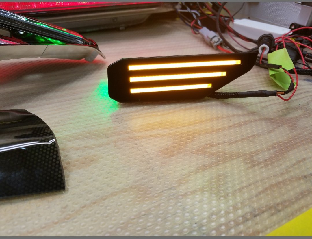

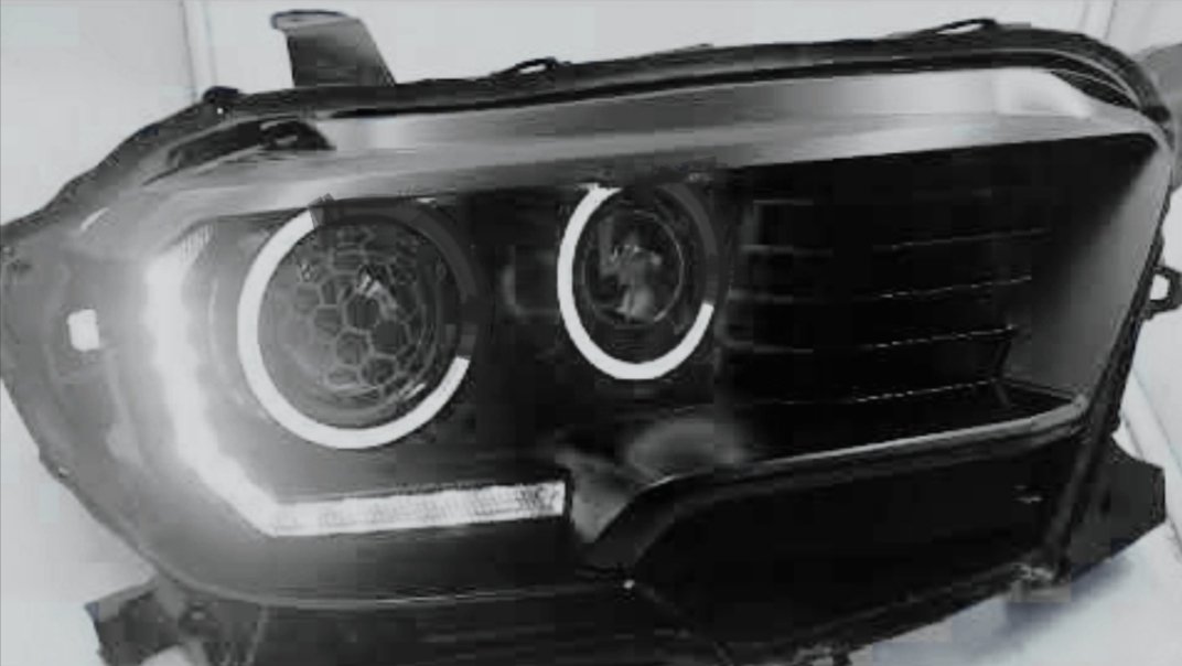

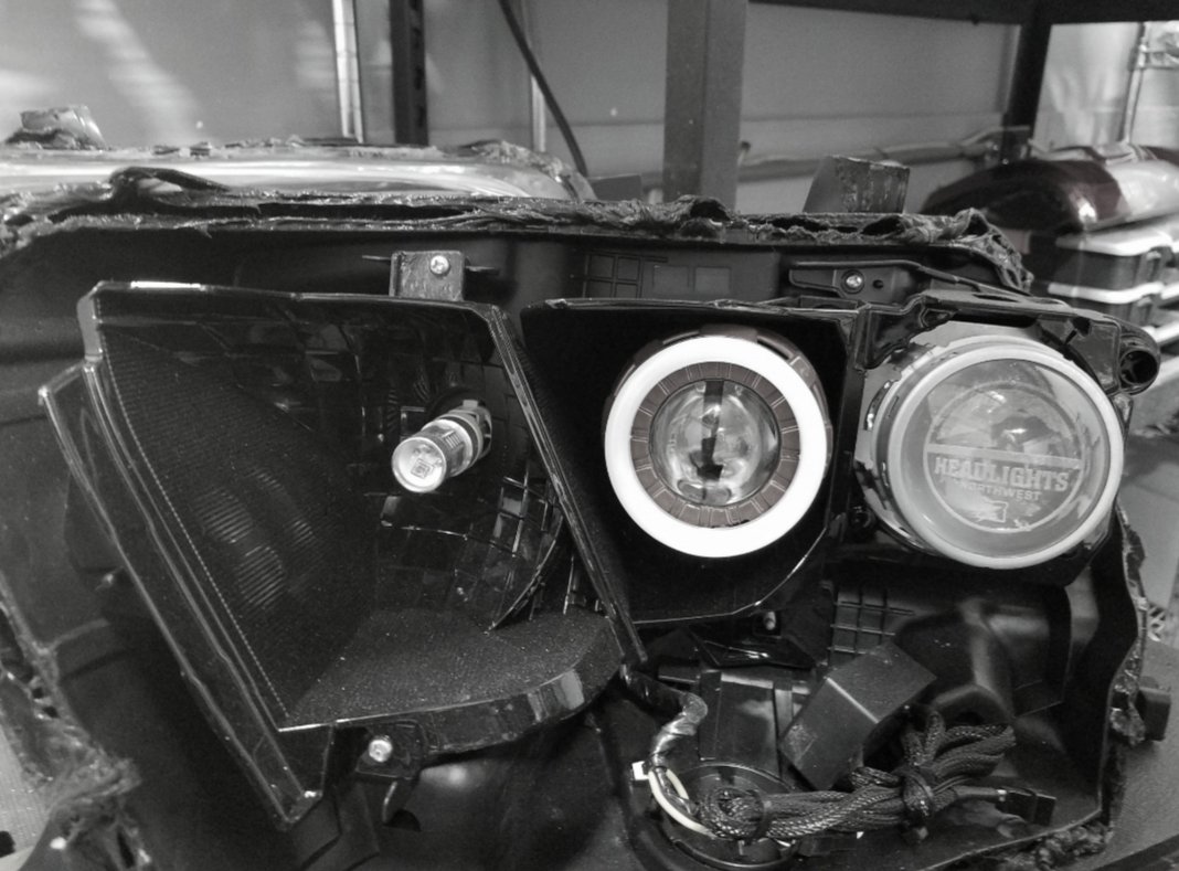

    Did some test fitting on test light housing today with person setting up my quads. Primary projector will have standard 80mm halo. Smaller projector will have 70mm instead of really small 60mm most are going with. Can't afford a Meso quad build but its close. [​IMG]
    Also tested another addition that will be installed. The turns are extra bright.
    Thanks @mesojdm .:hattip:
    Marker light
    Turn signal
    What it will look similar to when done. No etching tho.

    Looks great, and as long as you are happy is all that matters.
    Take extra care snapping the side markers in, the little mounting tabs are thin. After installed I put a dap of epoxy on the inside for added security.

    Already planned on the epoxy. We are also going to make sure the smaller projector light pattern is just slightly below RX350's so it won't mess up the clean cutoff patterns. Btw, this guy is the lead builder and has been following all your light builds especially your quad setup. He does not have a Toyota but very impressed with your work.
